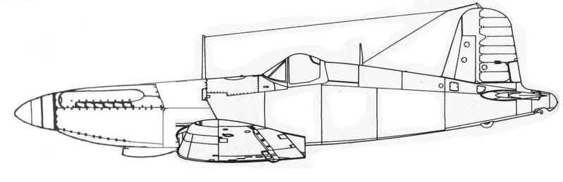

So there I was thinking, I wonder what a in-line Corsair would look like and 1 min later I had this:
I bet that sucker would be H*ll to land on a carrier!!  Or anywhere else, for that matter. Looks like the YP-37 with that cockpit so far back.
Quote from: GTX on October 10, 2008, 02:37:57 PM
Greg,
take a look a the cutaway I'm linking and you'll see that the aft end of the cowling on the Corsair is not the aft end of the engine installation.
The mounts continue back to joggled line mid fuselage, the one that lines up with the main spar of the wing and the antenna mast a the top.
http://www.fortunecity.com/meltingpot/portland/971/images/drawings/f4u_cutaway_01.jpg

The installed length (including induction system) of the R-2800 in the F4U-1, 2 series was 88.37 inches, in the F4U-4 family 93.77 inches and on the F4U-5 it was 98.5 inches.
Your Griffon wouldn't need to be hanging out in space in the fashion shown.
Jon

People, I did say I only spent a minute on this so please forgive gross inaccuracies - anyway, maybe it isn't a Griffon engine (it just looks a little like one ;D
