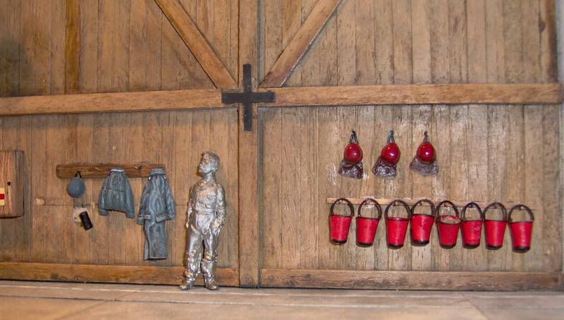

Coat rack added with buckets moved to right. Shelves dropped, no room.

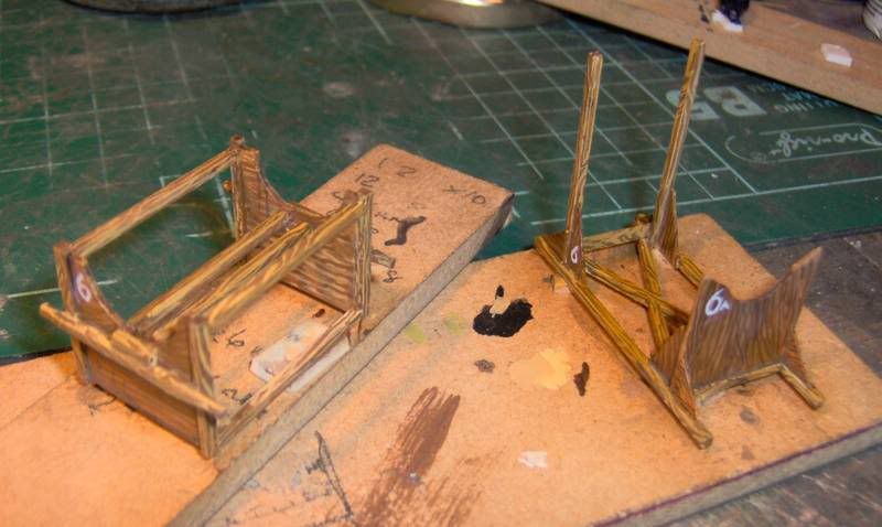

One to finish for HitlerJugend figure and with Herr Silbier for scale. It occurred to me the other night (around2.30) that if the other Natter is going to be on the crane hoisted to be lowered onto the trailer, then I needed somthing for it to be lifted from. Scratched from Evergeen to match other trailer/trestle on 1st Natter with a rear trestle roughed from images from the Shiffer book. I forgot to scratch woodgrain into the plastic as mention earlier so had to paint this, and not to unhappy with result. Base coat acrylic with grain in oils. When I next tried to give another grain colour/effect the first to started to lift so sprayed with Tamiya clears, a mix of red and yellow cut with a little green to give a browny tone and thinned with cellulose thinnrs for quick drying. (a before an after pic)
Nearly forgot, with the buckets are some standard German helmets with a leather back to protect the neck in red. I found a pic of civilian firemen postwar and I thought a simple addittion. Anyone know what the military used in the war?

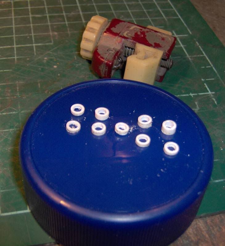

Not much progress made due to other commitments (thought I`d forgotten how to change a nappy after 25+ years, but its like a bike. Fall off once and you can do it whenever without a thought), but I just thought I`d post this, more of a tip really.

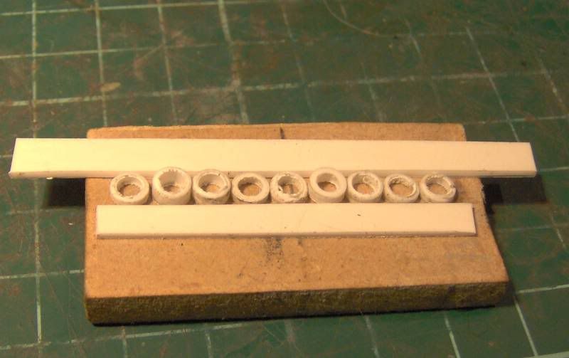

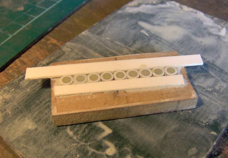

I needed 8 little wheels to go on the trollies in last post and scratchbox was outastock so using my favourite shape supplier I sliced some tube into thinish sections and stuck them onto a flat bit of MDF with double sided tape. A couple of scrap bits of 1mm (40thou) card as depth guides and filled with Milliput. When set a quick wet n dry bash and voila 8 near identical wheels without all the hassle of measuring and cutting at right angles etc.
Other tip, the wet n dry is d/sided taped onto a small 6x4 block of acrylic as I`ve found wood warps and glass is to d@mn dangerous. Simple really but I thought it might be of use to some of our younger wiffers.

yes I know theres 9 but I always make a few spare for the monster under the bench when building bits.

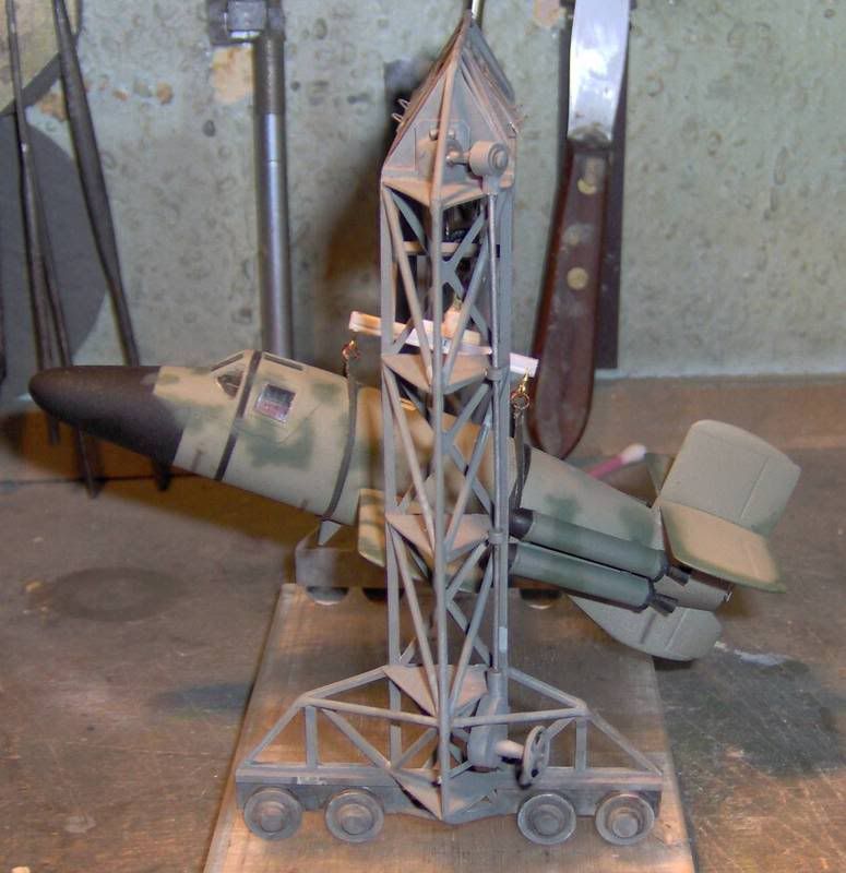

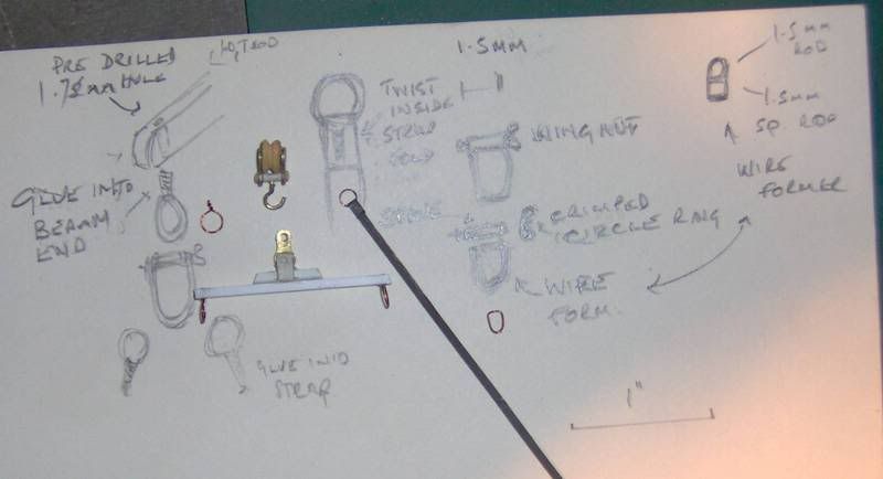

Meanwhile back at the Hogcupboard, I`ve just had a frustrating day. When I rebuilt the Natter, I added some .22 shot to the nose, in an attempt to help balance the bugger when trying to display in the official jacking/lifting positions. Now I`ve rebuilt the support jig into somthing more industrial and realistic looking and changed the strapping from masking tape to wine bottle foil but continued to use the same guage soft brass wire that I made the original lifting rings from. It now balances better but the addittional weight makes the rings open and drops the model. It seems the farce is strong with me today ;D
Oh well back to the drawing board.

Well it`s 2.18 am here in the UK and I think I might have solved my prob. Don`t have any ends to pull apart.
Don`t know whats happening with the camera, perhaps like me it`s tired, anyway now instead of rings I`m making tadpoles. Putting the wire over the same size rod but twisting the ends together.  The beam has holes drilled in to accept the `twisted`end (sounds like a good name for a band) and the straps have the `twist`inside the folded end. Now I have tro join the three bits together and thougt I might get away with making a `d` bit like a carabiner (r maybe its called a shackle) anyway by glueing a bit of streched sprue across the join to hold the split together. Anyway we`ll see. life sized bits added for interest with a 1 inch line at the bottom for scale and yes I do wear rather thick glasses

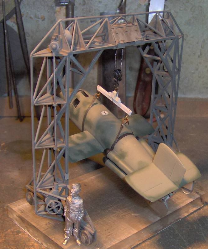

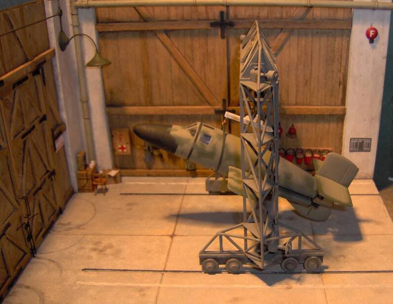

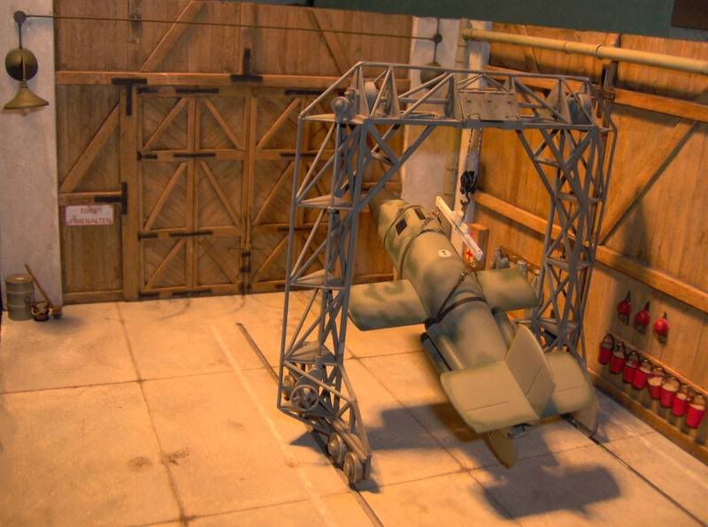

LOOK MA, NO HANDS!
At last its dangling on its own.
And just for atmosphere
Obviously not finished yet, but getting this far has gotten over quite a few bugs that were holding me up such as crane cable etc. Thanks for the input Matrixone, re the colours for this kit. When spraying this I was thinking if the airframe is on a trestle (liker the other will be displayed) how far would the painter be able to reach with his industrial Badger/Aztec and tried to finish accordingly.
