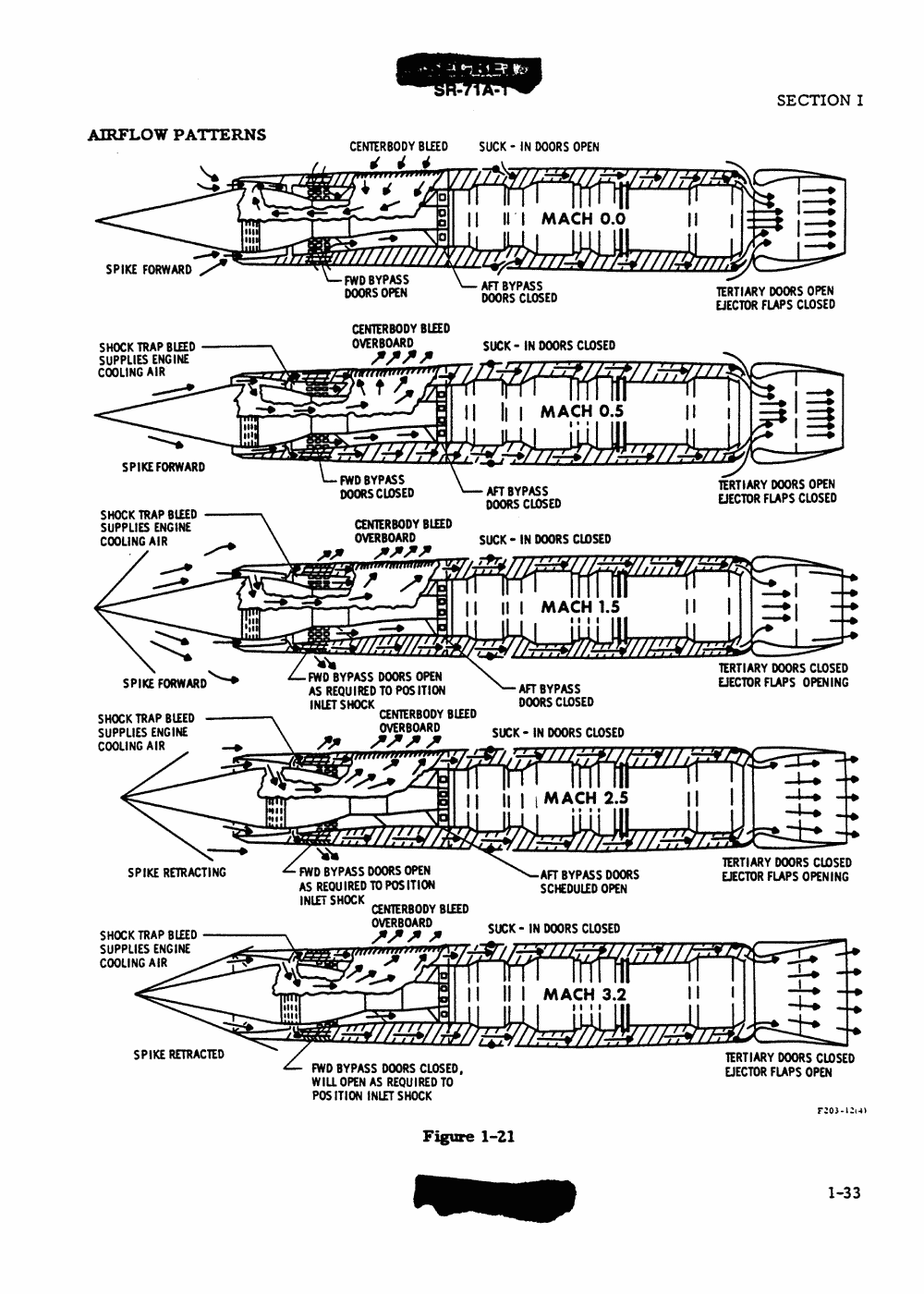

After some browsing through the Wikipedia, I still feel unclear as to the differences between the ramjet-Atar combo of the Griffon and Pratt & Whitney J58 of the SR-71...... or if they are any different at all in terms of arrangement schemes......
Any clarification would be greatly appreciated......

Ok, here's a try.
Griffon/ Leduc engine were basically large-diameter ramjets with a small turbojet inside.
It was found that the Atar resisted quite well to heat and flow of the ramjet surrounding it.
J-58 was another matter.
From what I've understand, the huge shock cone you can see in the intake masked the front fan/compressor at mach 3.
It seems the cone moved backward as speed rose.
Thus the J-58 sucked its air
- via side intakes,
- via the small interstice left between the engine nacelle and the shock cone.
Then the combustion chamber+afterburner were used as a ramjet !
In short
- the front compressor was masked/ protected by the shock cone
- thus it was simply bypassed after mach 3, because the fan could't resist mach 3 speeds
- So the engine had to suck its air avoiding the compressor;
- thus the compressor/ fan part of the J-58 was not used,
- leaving only the combustion chamber and reheat at work; well, that's a ramjet!
At mach 3 around 80 - 90% of the thrust came from the combustion chamber/reheat rather than the compressor; the J-58 was no longer a turbojet but a ramjet.
Btw when the J-58 was extracted of the SR-71 engine nacelle for maintenance, it was nothing more than an Olympus or J-75-like engine.
The "ramjet part" of the J-58 laid in the intake and nacelles, not in the engine itself.
Hope it's clear enough.
Jeffry Fontaine
#10
Google Image Search Results for J58
Google Search Results for J58
Archibald,
The J58 was a very complicated engine and it was kept under wraps for a very long time as to what it really looked like.  Now that the aircraft has been retired you can see the engines in some aviation museums.  The Seattle Museum of Flight has an M12 Ox Cart on display with a J58 displayed near it.  Some of the images in the search link above will give you a good idea of what the engine looks like without the aircraft attached to it.
The moving shock cone design was not new.  A slightly less complicated shock cone was used on the J79 engines that powered the B-58 Hustler.
Here is a good diagram from Wikipedia that shows the shock cone operation in some detail (note that this page was originally part of a classified technical manual on the SR-71).  Thanks to the general declassification schedule it is now available for viewing by normal people.
