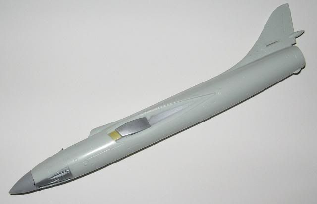

Like Poe's unnamed murderer I can't stand the sound from beneath that plastic lid.  I tear into the box and out comes the razor saw.  A few swift strokes later the tank is dismembered.  Surely this won't fit, I tell myself.  I can get this over and move on with my lovely little OOB Hunter with its clean seams and no putty.
Carefully I match the tank section to the Hunter, begging for a nasty, ragged step, or an unfortunate angle.  Anything that would let me leave this diversion and get back to my lovely little OOB Hunter with its clean seams and no putty.
SON OF A B****!!!!
It fits perfectly.
"See".  It mocks my despair.
"What a lovely radome I make".  I can hear the delight in its voice.
So my friends... do I give in to the temptation, or stay the course with my lovely little OOB Hunter with its perfect seams and no putty?
In all fairness, this mod would not need any putty, it fits so well.  This nose also looks virtually identical to the pic I have of a P1109A.  I'm actually thinking it might look very nice in Lightning green/silver streaking into a low German overcast with a pair of Red Tops on the wings.
Any opinions?
The nose looks very good. I say go for it. I find very hard to ignore the voice (or voices as it applies to me) as well. ;)
 Eddie
SinUnNombre
I think it looks nice. And if it fits well, go for it. Just be careful gluing as to not introduce a funky seam. That makes me want to put a new nose on my Airfix FGA.9. Keep us posted.
Jon
Sure....go ahead, Nick, toss it back into the spares box. I triple dog dare ya.....then be prepared to spend the next two weeks at home listening to it calling !
With that said, it looks way to right to pass on ! Obviously you gotta go for it !

The voice won out.
The radome is fitted, and as predicted no putty was needed.  I dab of gap filling super glue made it all come together.  The seam on the tank even works perfectly.  If anyone ever wants to puta radar nose on a RoG Hunter, well get yourself a drop tank from a Revell 1/48 Strike Eagle and you're in business!

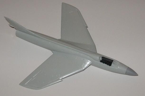

One of the things that I love about whif modeling is the way a build changes along the way.  Surely it must get dull for every model to be built to match the box art with no discovery along the way.
What started only 6 hours ago as a stock Hunter in RAF Vietnam service is now evolving into what BAe would call Hunter 2000.
Since this pic I've fitted a HUD.  Unfortunately the fork in the road cam after the fuselage was assembled, so I cant redo the panel with a nice big MFD, but since it's all in black it's not too visible anyway.  I will be trading the lovely kit seat for a Mk.10.
Phil-much as I'd love an intricate camo, I'm on a tight time budget on this build, so it's gonna be done the quick way.  Plus I dont have any Chilean markings in the stash.  Still, it's an interesting idea...  What if the Hunters Chile received from the UK after the Falklands didnt end up as spare parts, but were rebuilt and upgraded..?

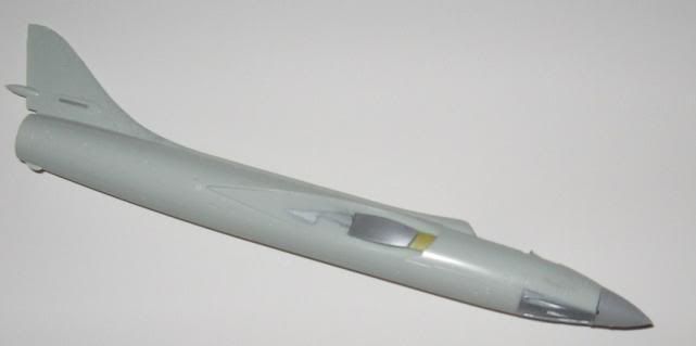

Well as they say, 'in for a penny, in for a pound'.  I've decided to go with the fully modified mid-late 90s model.  This has been in the back of my mind all day after reading an article on the Flightglobal.com website about Hawker Hunter Aviation, a company in England operating 12 low time Hunters on defence contracts doing things like target simulation, radar calibration, trials, etc.  Seeing a pic of a Hunter with a current RAF Z**** registration got me wondering how long the Hunter could have served on the front line if upgraded enough.  After all A-4s served for decades, as has the B-52, and the Nimrod MRA.4 is a rebuild of an very old airframe.
So...the upgrades so far:
Blue Vixen radar
Shortened tailpipe for the Spey engine
One-piece windscreen (sanding center panel frame away was the point of no return)
It's getting very late so that will be all for tonight.  Tomorrow I'll post more updates.
I happen to have some pretty nice 74 Sqn decals for the Hawk, so now I'm thinking a black-spined Tiger Squadron machine with a pair or AMRAAMs might look nice.

I don't think you want a Spey, even the small ones are rather larger than the Avon and require significantly larger inlets.  A better approach would be re-engining with a RB.199, EJ200, or F404/412(RM12)/414.  You get a bit of improvement in thrust with a much better fuel consumption and reliability.  The airframe looks to be too far along now, but adding the CFE-proposed three-foot extension at the nose/main fuselage joint would've been nice, too.
