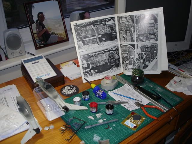

Started today, sort of...
Republic Thunderstreak FGA.1a
More pics later, when the baby goes to sleep.... maybe  :blink:

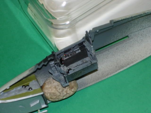

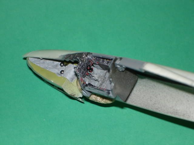

It's all quiet now, the little darling has been asleep for an hour, so here's the closer picsof the (very) weathered cockpit..... and YES before anybody asks, that IS a pebble from the beach superglued under the cockpit floor 1
As ever all comments queries etc etc etc, warmly welcomed.

Cockpit looks incredible Ian.
Which kit are you using?  I built the Monogram one years ago and remember thinking it was pretty good fit for a Monogram.
Finally, are you replacing the Republic sweat with a Martin-Baker for RAF service?
That's a major bit of nose weight you've got there Ian, I don't remember having to put very much, if any, into the nose of my F-105 I did.  Mind you it was a while ago.

Um...is that cockpit oob without any accessories besides really good painting?
I mean, I know it is a good kit and a highlight is the 'pit but this looks better than just "good."

Nick - Yep it's the old Monogram kit, but the recently released Revell version - outstanding decals, especially the stencils. Wont be changing the seat, the idea being that the Thunderstreaks' were only in RAF service for a few years until more Hunters came on-line.
You're very kind Mr Mouse, but that is just a basic cockpit, painted, dry brushed and given a wash or two. The instrument faces came-out quite well tho' I must admit. Did my usual thing, painted the panel grey and dry brushed it to make the dials 'stand out', then painted each dial in thinned glossy black - it's a technique that has always worked for me, especially on Monogram kits.

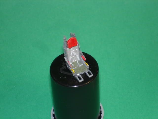

Wait till you see the seat !

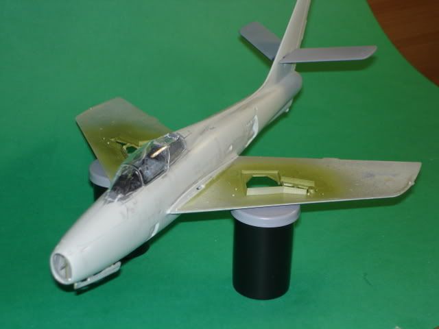

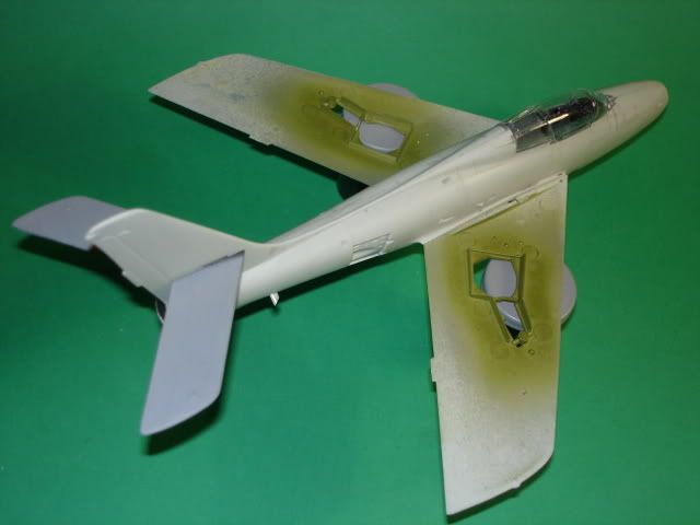

Progress:
Fus together, lower wings on.
....and the seat
all goes into a 'holding pattern' now till the weekend, start back at work in the morning.

Great work so far Ian, cockpit looks great B)
Those old quarter scale Monogram kits go together great for their age don't they?

That cockpit is awesome.  I took it for a photoetch jobbie at first glance.

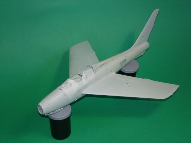

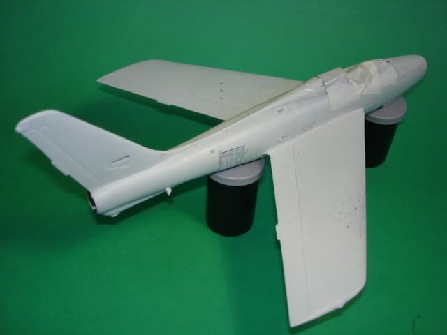

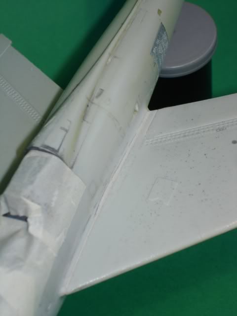

Some progress:
As you can see the wing/fuse joint on both sides needed some attention from my trust (old) tube of Squadron putty. No big problem and so far only 'major' use of the smelly grey stuff. So here it is ready for its' move to the paint-shed (too bl**dy cold & windy out there today, Brrrrrr). First coat will be the underside painted aluminium:

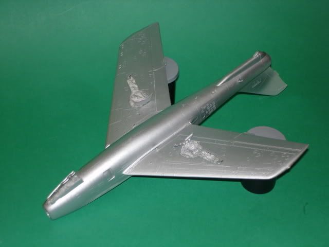

Xtracolour 'Aluminium' on today, and sealed-in with a couple of coats of Johnsons Kleer. Wont be doing any more until Sunday at the earliest - back on duty tomorrow !
