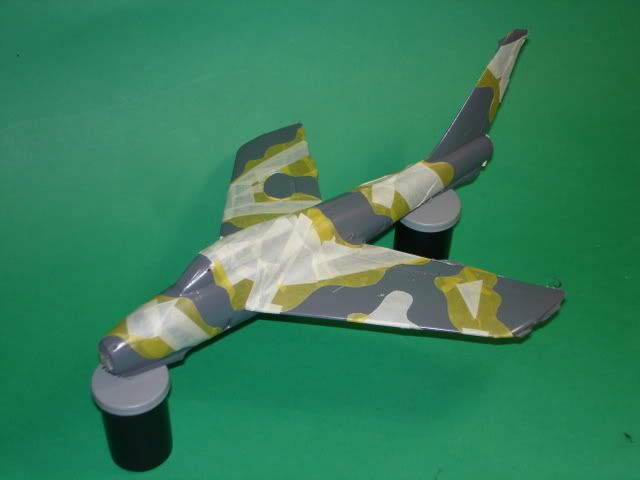

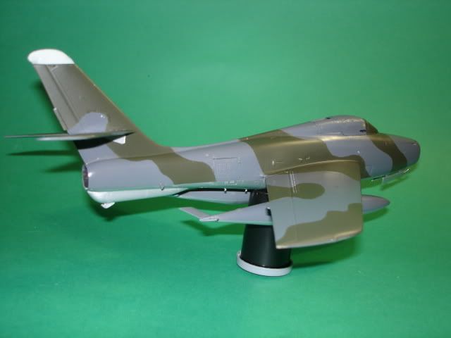

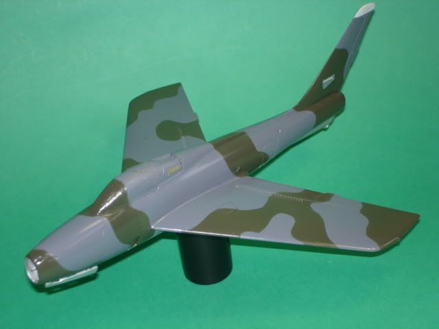

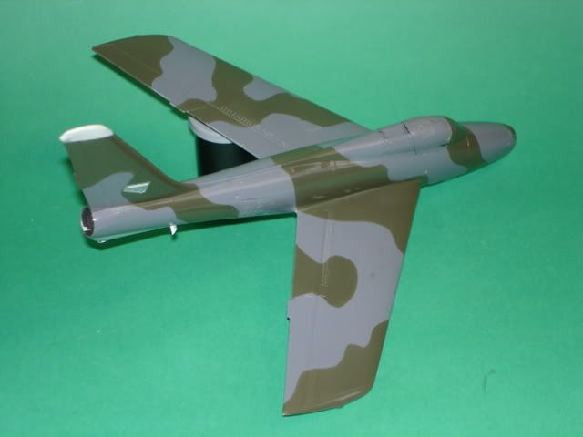

Dark Sea Grey on, then varnished and masked:

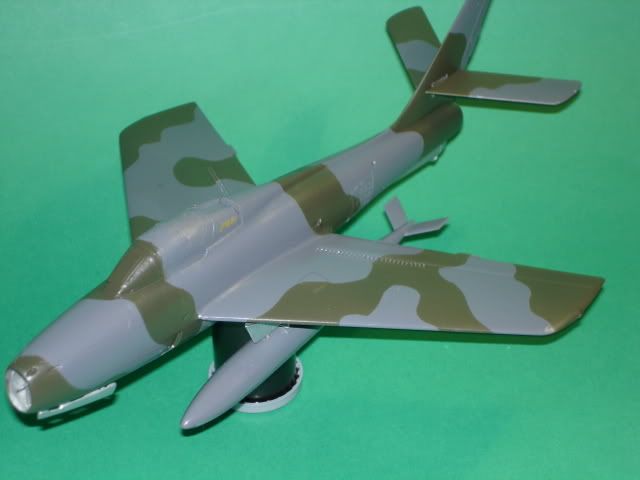

Dark Green next, at this point the drop tanks and stabs are only just pushed into place:

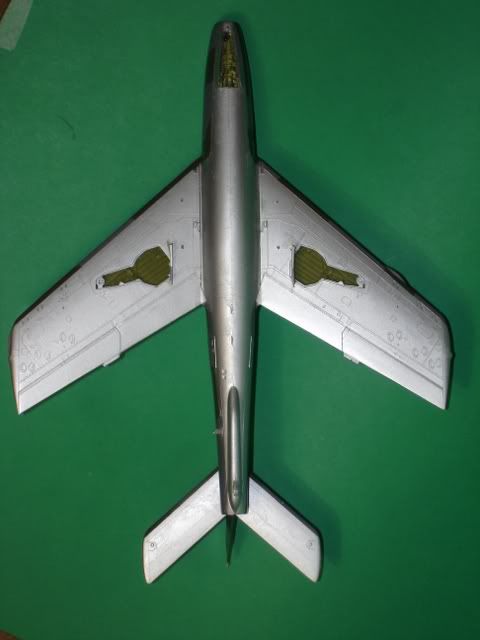

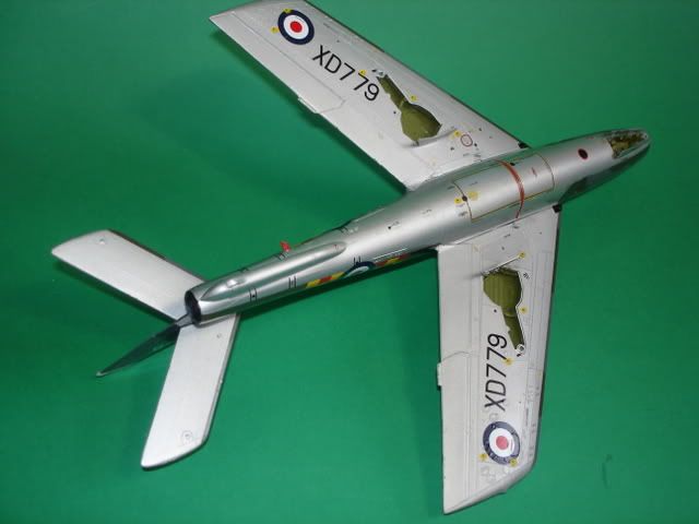

Quick shot of the underside showing the wraparound on the wing & stab leading edges:

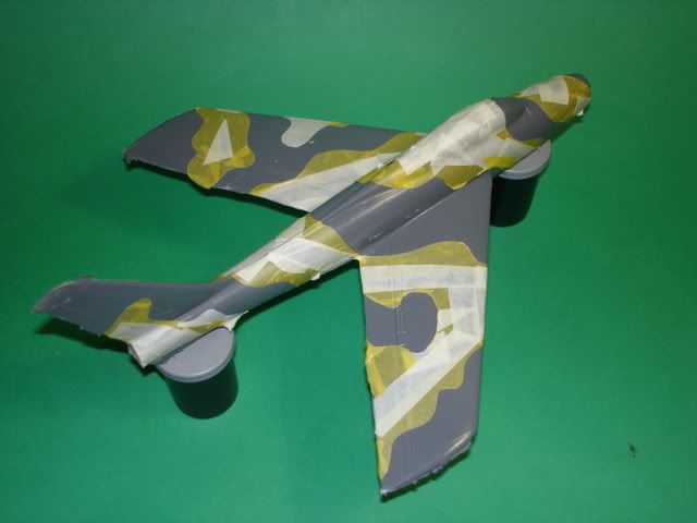

looking good Ian, I see you are using Tamiya tape (yellow) is the white tape also Tamiya?
Nice to see one of my favorite aircraft models getting the Ian treatment.  Your camo demarcations would appear to have absolutely no paint lip/edges whatsoever even though it looks like you are not using raised edges on your two types of tape (I use Tamiya tape, too). Yet, my camo/color splits often end up with a thin but noticeable ridge effect, no matter how light I spray.  Is that because I'm using Acryl paints, do you think?
There are slight ridges Barry, they just dont come-out on the pics. I have already sanded them down with auto-finishing wet'n dry. I found that CAREFULLY taking off any masking as soon as possible after spraying - when the paint is still wet - reduces the ridging problem. I dont believe it's got anything to do with the type of paint you use..... but I could be wrong. HTH

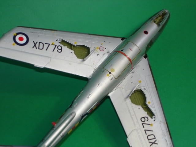

Some decals went-on yesterday afternoon; the roundels, serials, (modified) squadron bars. It'll take a few sessions to get all the stencilling on - there's just so many of them. It will be going to Bolton tomorrow, and may get its' picture taken there..... who can say  ;D

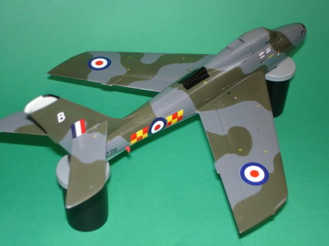

Well in to the landing circuit now, but will probably end-up on 'long finals'. The Hog went to Bolton yesterday, and a couple of our colleagues were quite taken aback by its' sheer bulk, certainly no lightweight, this puppy. Spent an uninterrupted three and a half hours this morning, getting all the stencils on. I always put the national & squadron markings on first with any project. Those squadron bars & badges and the smaller four roundels and fin-flash all came from the excellent Eagle Strike Sabre sheet, I trimmed-off the end checks on both sides, eight blocks was just too long for the Hog. The larger wingtop roundels came from the not-quite-as-excellent Cutting Edge Hunter sheet.
I've posted a shot of the M A S S I V E decal sheet, D*mn RoG are good at these !

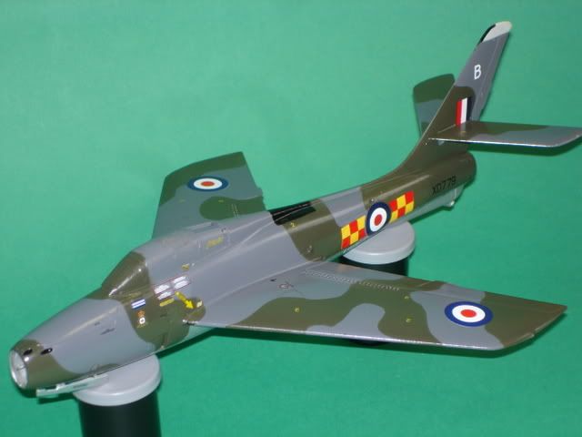

So here it is, all dressed-up and ready for a coat or two of 'scale gloss' - that's Humbrol GlossCote mixed 50/50 with Humbrol SatinCote, just to take make the finished thing looka little less 'toy-like'.
Here's a close-up of the belly, there's a shed-load of stencilling here:

What do I think?
1)  Glossy grey/green with full colour roundels?  10/10 for choice of colour scheme
2)  Nice job on getting a real sharp edge to the camo.  The demarcation seemed to be much harder in the 60s/70s, than it was when we went to the wraparound in the 80s
3)  Aluminium undersides seem to be notorious for oil streaks and the like, would be nice to see some dirtying up there  :wacko:
4) Don't sweat it on ALL the stencils.  Its a whiff, I just try to add enough to give it a bit of character and life, unless its a classic stencil magnet like SEA F-4Gs or JASDF F-4s
