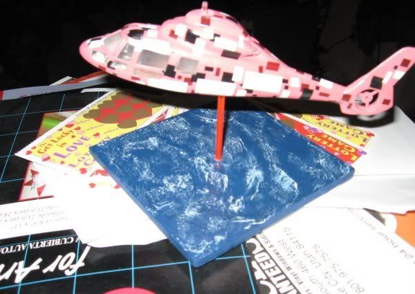

noxioux
Here is the mega-low tech way to do it.  Simple tamiya flat white drybrushed over flat blue, with some future.  I think you could do this adding some blue-greens and it would look much better, but it does the trick in a pinch.
noxioux
Thanks.  If my old painting professor saw it, he'd cut my fingers off with hedge clippers.  It's crap under close inspection, especially compared to some of those resin techniques out there.  But it does okay on a quick glance.
