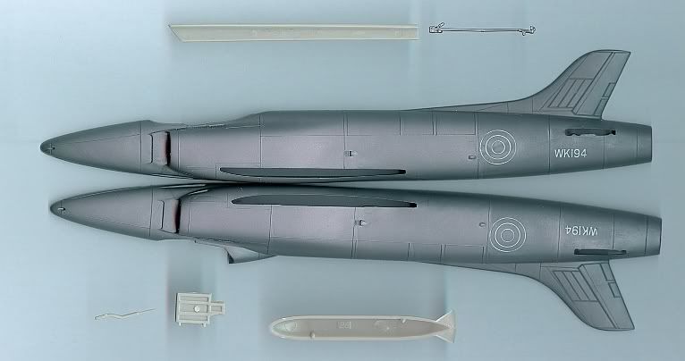

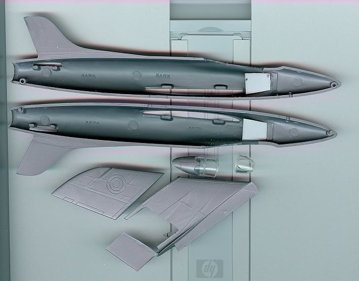

Here's a scan of some of the bits 'n' bobs:
You'll notice that the solid section of the rear canopy has already been removed on one side, I'm going to construct a cockpit and pose it opened. the Hobbycraft F-86F nose door will be mounted as an airbrake under the rear fuselage. The Sabre also donated the leading edge slats which will probably be added, and the pitot tube, I like the cranked style, gives it character. The drop tanks are coming from a Matchbox Hunter T.Mk.7/F.6, and the arrestor hook from an Esci A-4F Skyhawk.
