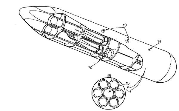

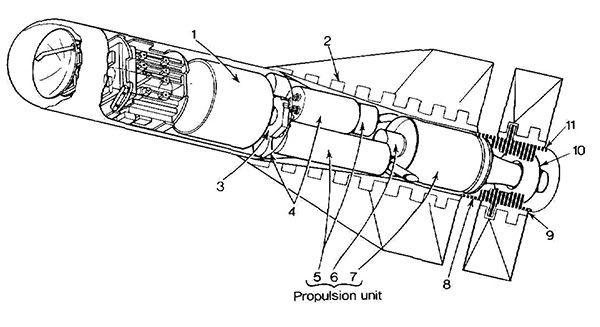

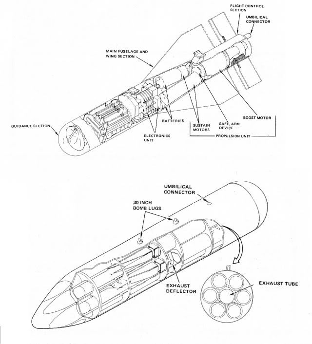

This missile, along with the contraptions built and/or proposed for the "Assault Breaker" program are my favorite weapons designs of the '80s. I believe you will be going for the pod, which is the planned way of deploying the missile.
....And some more photos for reference....
Good luck!
Rafa

Found some more data: the launcher has 6 tubes, loaded with 2 missiles each, as shown on the drawings Rafael posted. The launcher weighed about 900 kg/2000 lbs in this configuration. I've also seen a mention of a launcher with 8 tubes and 16 missiles. Fighters would carry 2 launchers, the Tornado and A-10 could carry 4. What do you need 10 launchers for?

2) Building up the cone around 6 tubes with putty sounds like the way to go.  I think I'll get the main tube made of wood, drill the 6 holes into it, then mount 6 plastic tubes, build up with putty and shape it as I go.  That way if I screw up I can just yank the tubes out and start over.
3) Yep, Senor Carton's right.  6 tubes...12 missiles.  Crazy huh?

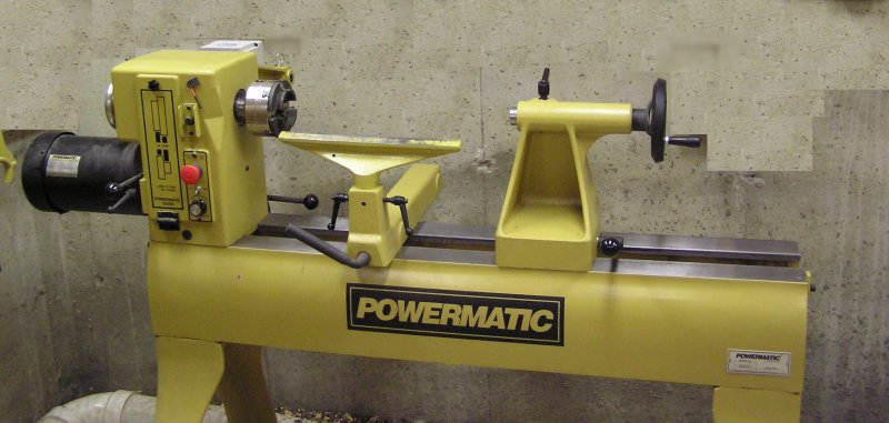

Lathe:
http://en.wikipedia.org/wiki/Lathe
In a pinch, you can use an ordinary drill instead. I've done this to create a nice round or pointy nose for scratchbuilt missiles: place the plastic rod in the chuck, run the drill at about 1000 rpm and drag the rod over some sandpaper.
