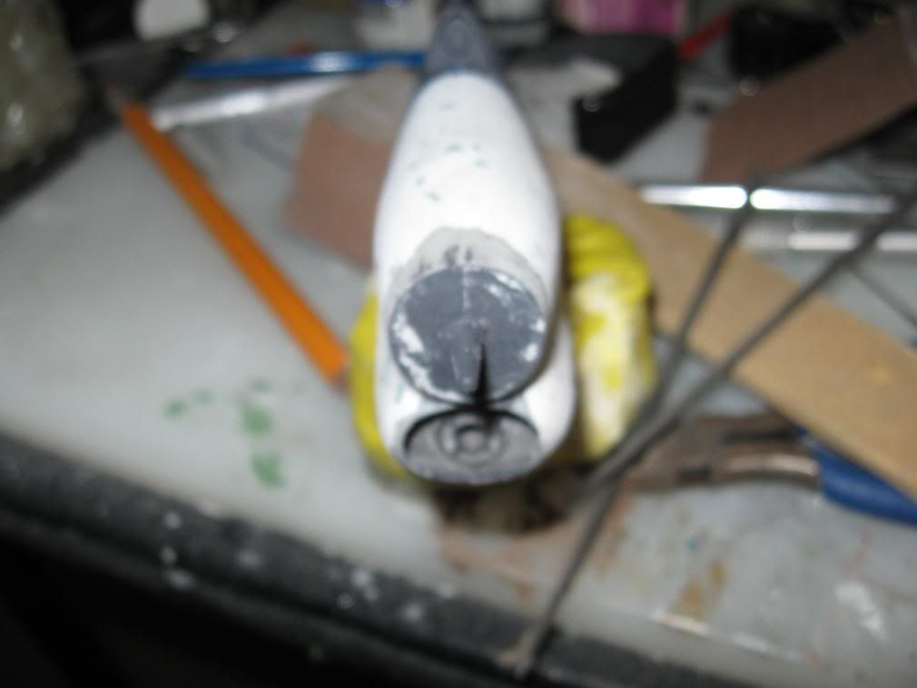

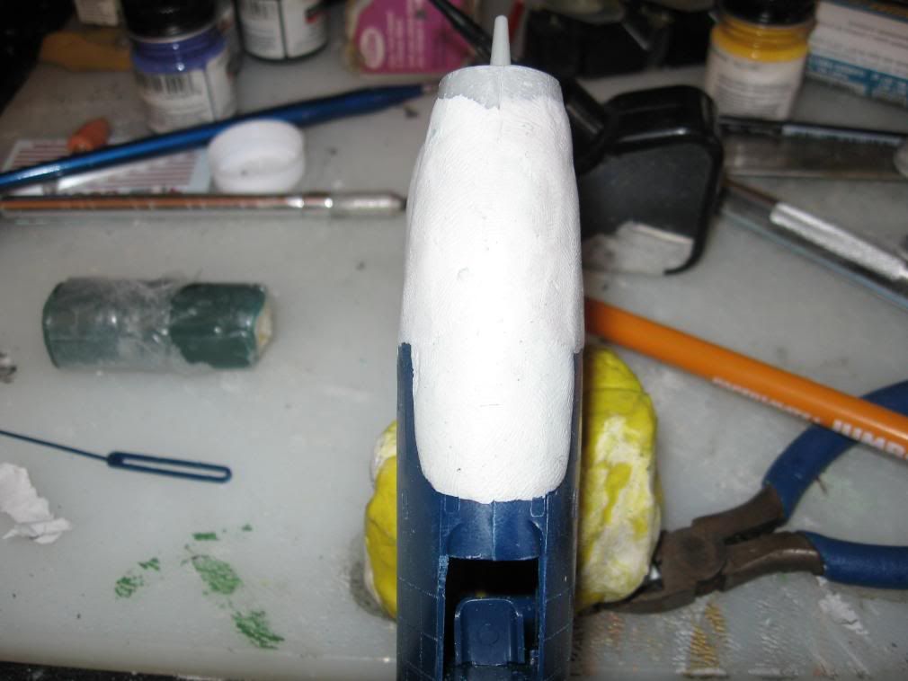

I'm gonna need more putty
With Hawker busy building Hurricanes and Typhoon they had no manufacturing capability or time to develop a platform for the new Napier Cutlass X-24 cylinder 2500 horsepower engine so with Hawker advising the project was transferred to the Grumman shadow factory .The requirement was for a 400+ mph fighter that could manouver with the latest German aircraft and carry at least 4 cannon with a range of at least 1000 miles loaded

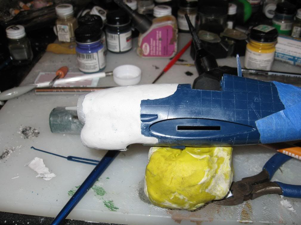

Well that didn't suck nearly as bad as I thought it would

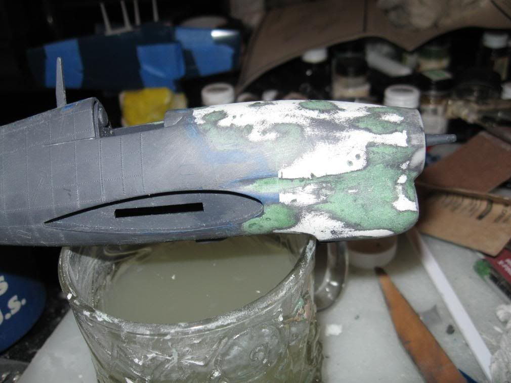

Now the sanding, I hope I survive :wacko:
Rafael
Great entreé, Sotoolslinger!!!
That blending look smooth and gives a look os speed and power.  :wub: :wub: :wub:
I can´t wait for this, another of your marvelous creations.
You're not only popular with howling mice, you're also popular with banana-land wonders :lol: :thumbsup:

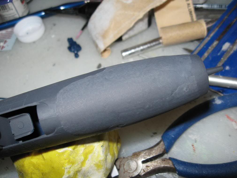

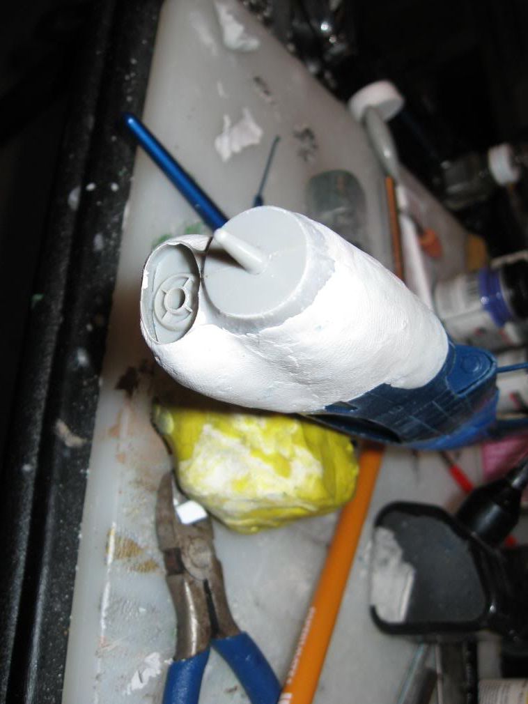

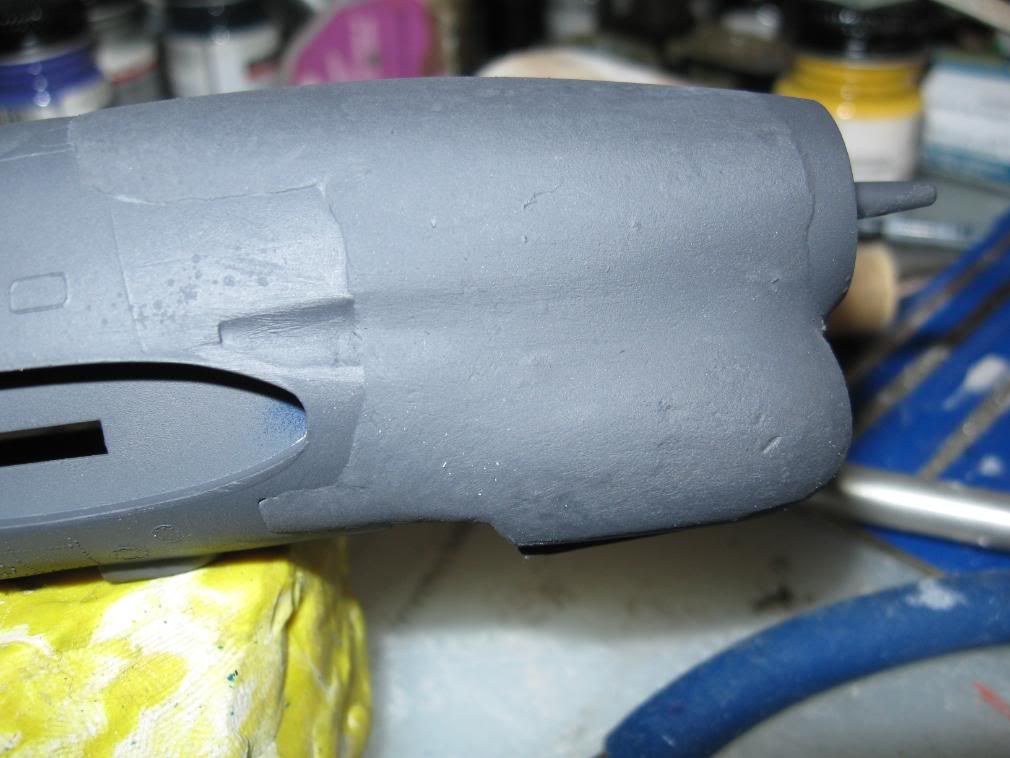

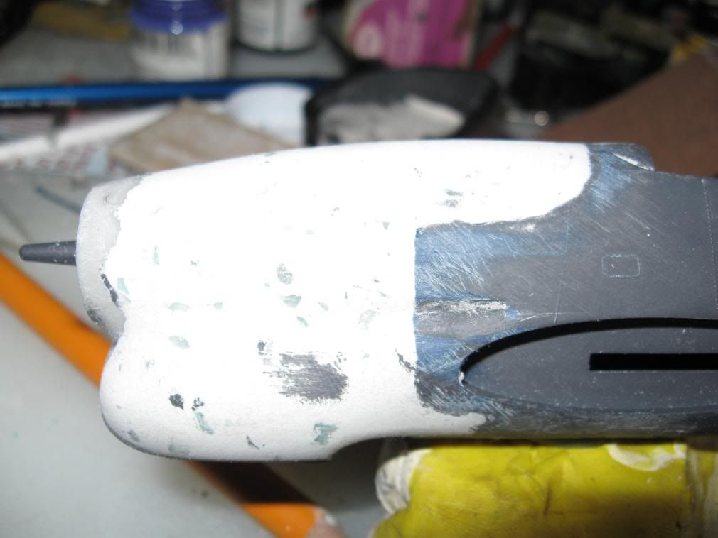

After much PSR(much more to go) :banghead: :banghead:

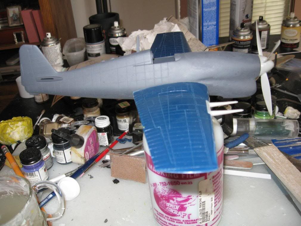

Third primer with wings
With Big Ole Cannons
From above

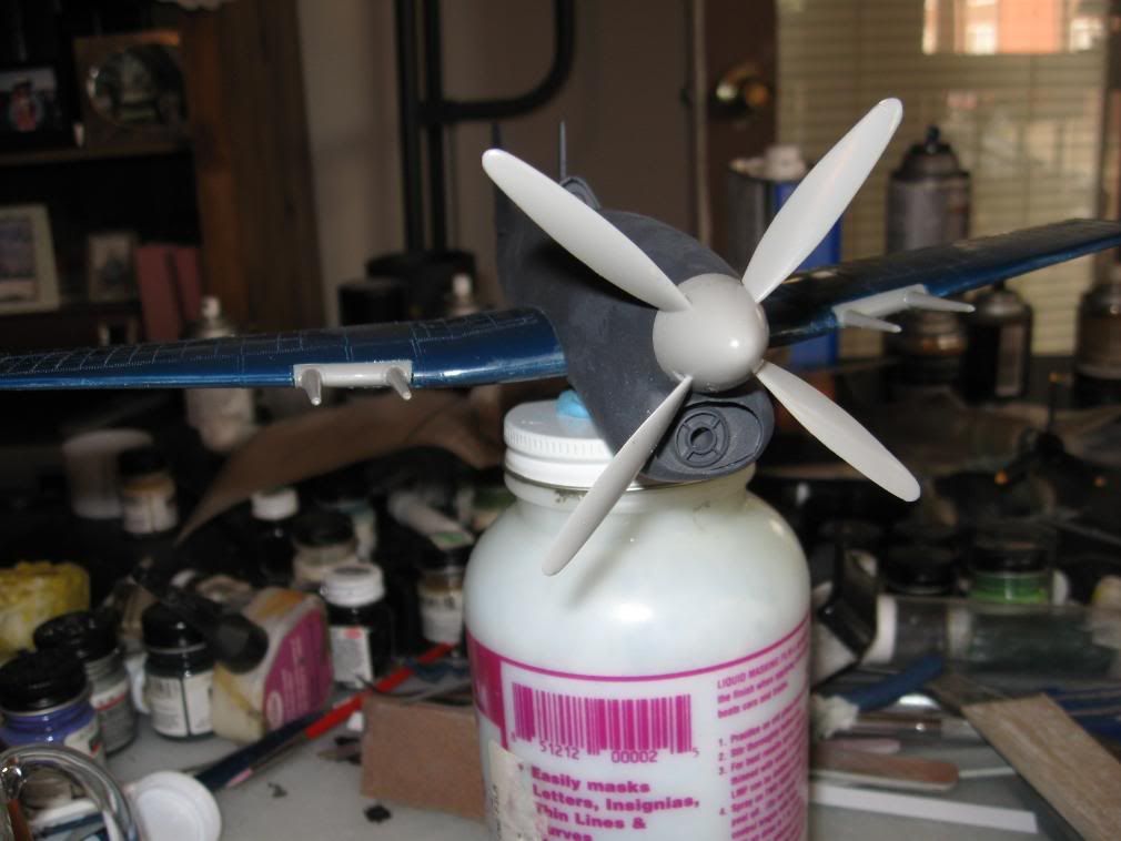

Front with prop
Fly by

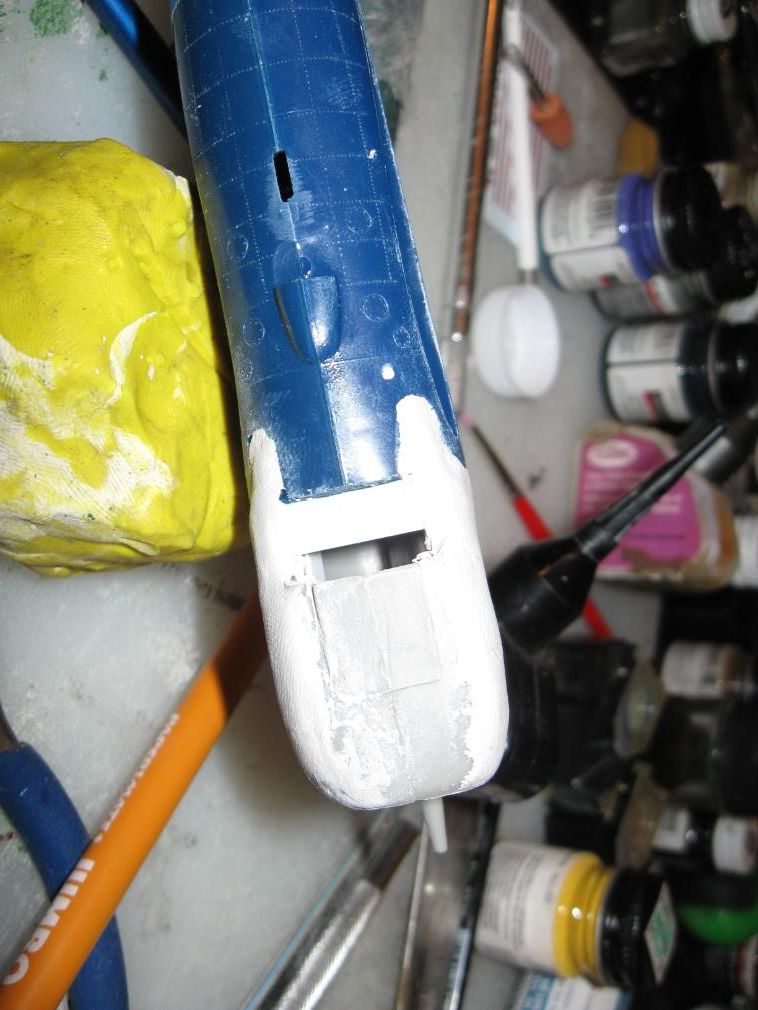

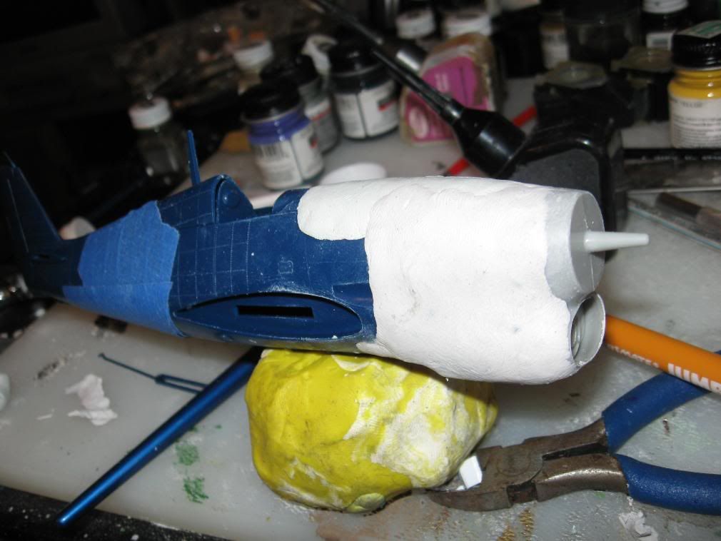

RotorheadTX
What kind of putty/epoxy are you using to blend all the bits together??
That white stuff looks like it is very workable, and seems to sand well without chunking away....  :bow:
That's just awesome, Toolslinger! I see you're teasing us again with that "night" scheme...
The putty is VersaChem Magnum(will harden underwater) Marine/Plastic Repair epoxy stick  from ITW Performance Polymers Rivera Beach ,Florida  33404 . It is pretty nifty. It gives about 8-10 minutes working time so you have to be quick but it does sand well. Be careful though it is harder than styrene so you have to watch how you sand . It does wet sand well though and feathers well.
It's an epoxy stick so it works like miliput ;D

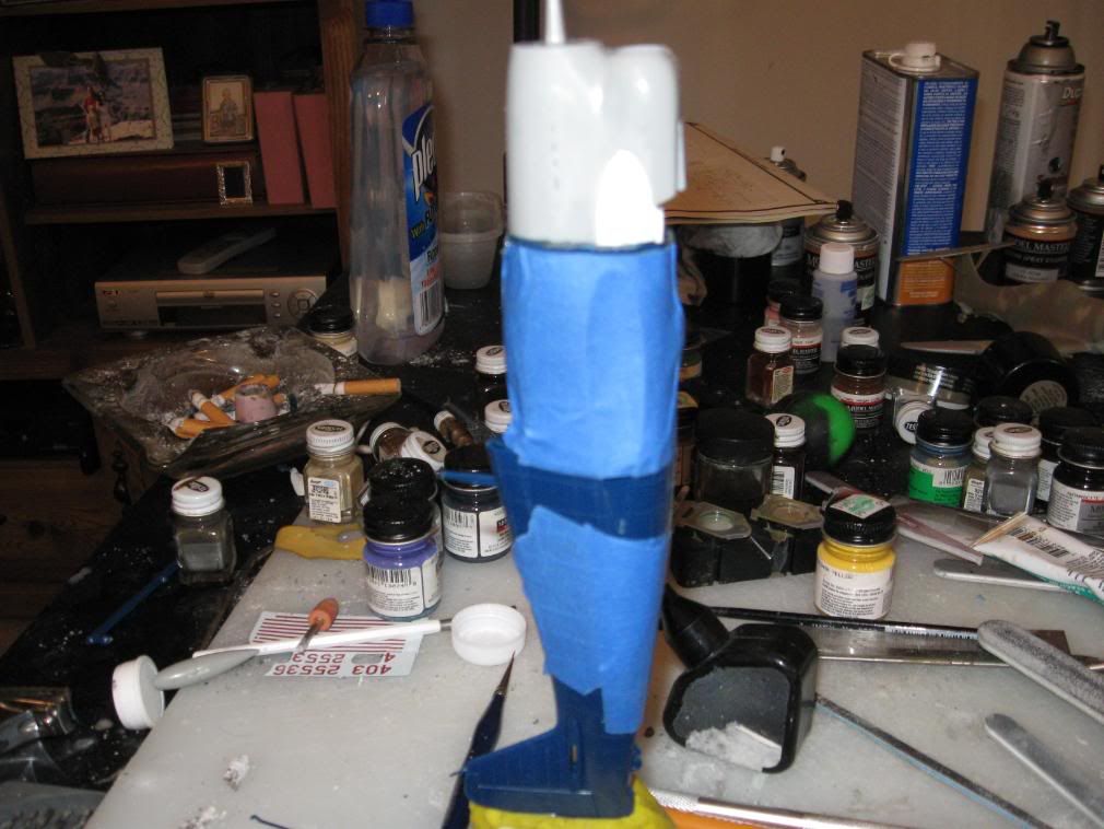

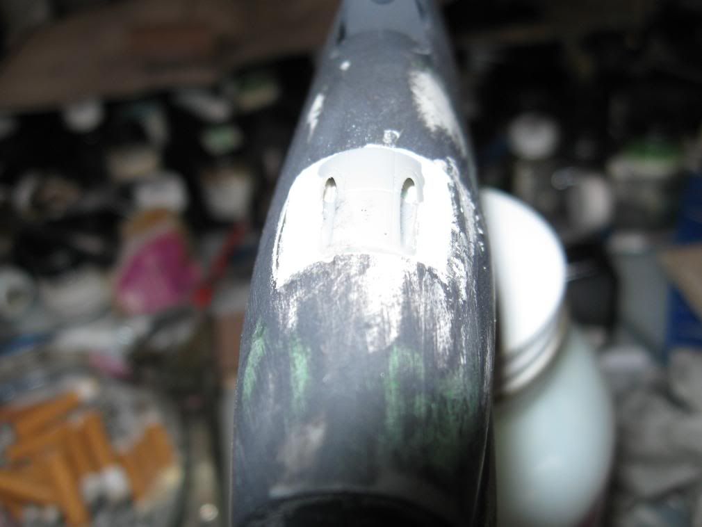

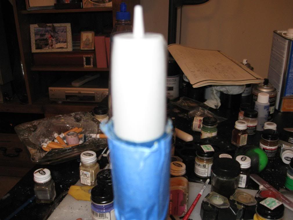

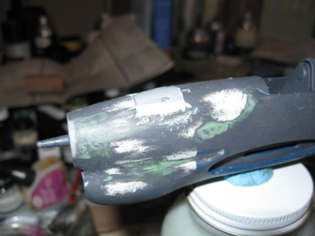

More PSR
.75 cal machine guns ( synchronized) installed in nose
These are of course 15 mm cannon with explosive rounds so the aircraft actually has 6 cannon :wacko:

No big surprise that I'm liking this with great intensity.  You're making the blending/PSR look easy.
If you'd like: Now that you have your airbrush out, you can easily make some raised panel lines on the revised cowl (to match the rest of the fuselage) using Tamiya masking tape and your Testors Acryl paint.  After only 2 or 3 coats, when you pull the tape, you'll have perfectly matching raised panel lines that you can subsequently paint over with whatever your final scheme is to be.

proditor
That's is freakin' awesome!  I'm really stunned at how natural the engine looks on that fuselage.   :thumbsup:
Thanks Pro wait till I get the 24 separate exhaust stacks on :wacko:
