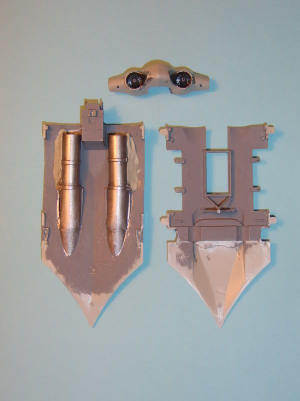

It's a little bit unusual this kit compared to others I've built, as there's a fair bit of internal work to be done before you can put it together.  One slight problem is that, being derived from the Dragon 1/48 kit, there's a lot of space visible in the wheel well area because Revell decided to leave the engines out.  I decided that I'd kill two birds with one stone here, I'd scratch some crude representative engines to fill the space, & I'd use these as noseweight.  They are plastic tubes on the outside, filled with ever smaller pieces of brass tubing fitted into each other.  No way is this bugger going to tail sit (thanks Trev! :thumbsup:)!  I also covered the bottom of the exhast shroud, as light was visible through this.  This caused me a few fit problems, but a bit of cutting & sanding sorted that out.

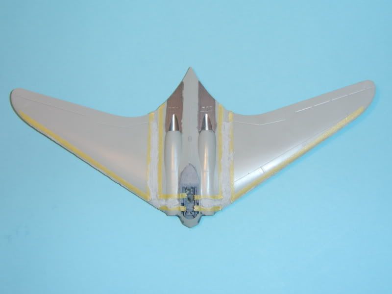

Once that was over, it was prett simple to put the whole shabang together, with no tail to worry about.  I was surpsied to find when this was done, I had a lot of PSR to do.  From the reviews I'd read, I didn't think this would be a problem.  Part of it was my own making, I think if I'd spent a little more time putting it together, I'd have saved myself some work.
One thing I'd discovered from a three view, was that there was some dihedral to the the wings.  If I'd have oriented the wings flat, I'd have had less to do, but introducing the dihedral caused a gap on the lower sides, especially on the right wing.  I'm not too worried, as I prefer this look & it's correct too, which is a bonus!

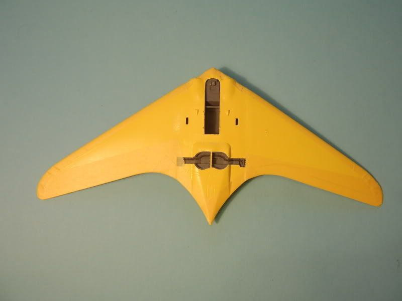

Underside done with Halfords Rattle can & masked off ready for the top coat, which I'm not quite sure how to go about yet:

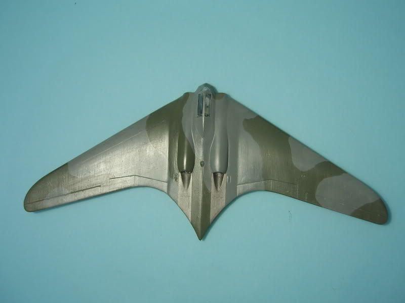

Top sides done.  Okay, it's fairly obvious now where I'm going with this!  The reason I was  deliberating over the top sides was not the colours, it was how to apply them.  I didn't want to paint this one by brush & fancied using rattle cans, of which I've used Halfords Fiat Broom Yellow for the undersides as reccomended by The Wooksta!.  The top sides where more of a problem, I couldn't tie down the right rattle cans.
I've had an airbrush that I bought from Telford in 2007.  The guy supplied me with a hose, which I found didn't fit the compressor I had.  I'd bought this for another Airbrush that packed up after a single use (not the 'brushes fault to be fair), my only experience with an Airbrush.  I found the hose didn't fit the compressor & I assumed this was because it was an old Holding (big, noisy but bomb proof) & despite the very freindly guys at my LMS going to the ends of the earth we couldn't find a suitable adapter.
When trying to source the rattle cans, I remembered I could use air cans & went about getting a couple of these, which my hose didn't fit either. :banghead:  Cue another search by the LMS guys which this time yielded results with a regulator & hose to fit it.  I got them home & tried the cans with my airbrush.  It's probably the fact I'm not used to an airbrush, but I found it difficult to control the variation in pressure as the cans got cold.  I was getting dispondent & very much thinking of going back to my hairy stick when I something in the back of my mind made me rumage through my model tool box.
There it was a part that came with the old airbrush that fitted both the new hose & the compressor.  So it wasn't the compressor that was at fault, it was the hose I was supplied, I'd made the wrong assumption, which took me a year & a half to work out!  I'm reasonably happy with the results, but the Ocean Grey didn't go on too well, there were some patches which spatterd & dried darker than the rest.  By the time I put the Dark Green on, I'd got more of the hang of it & that went on evenly.  Far from perfect, but I'm learning.
Here it is after a couple of coats of Klear, which on another forum someone insisted brush painting left no marks.  Okay, they're reduced, but they're still there, I'll airbrush it next time.
