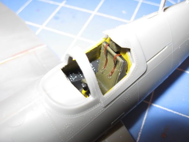

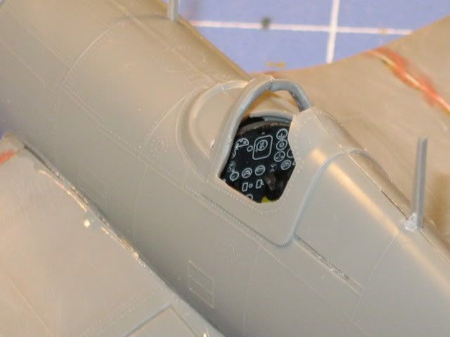

The cockpit. Please excuse the mess, but the cleaning lady won't be in till Mon. :banghead:
This is the first time to use a panel decal. I should have done it myself.;) :rolleyes: ;D

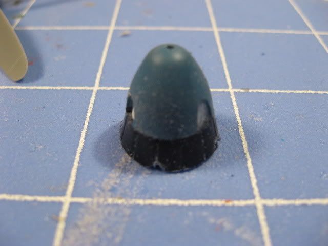

The Spitfire spinner mashed with half of a Hornet burner can. :cheers:

Not after what just happened. During the wet sanding, water got in the pit and now the canopy "glass" is fogged. I don't know if it's the Future or the glue I used to attach the canopy. I'm waiting to see if it clears. If not by night time, it comes off and rehab starts.
    Eddie
future will fog when it gets too moist...it should clear up, I'd leave it overnight.
Quote from: cthulhu77 on July 06, 2008, 06:24:37 PM
Too late, they are off and in window cleaner. That is what one uses to get Future off, right ( crosses fingers)
   Eddie
Quote from: nev on July 07, 2008, 01:35:50 AM
If its ammonium based, yes.

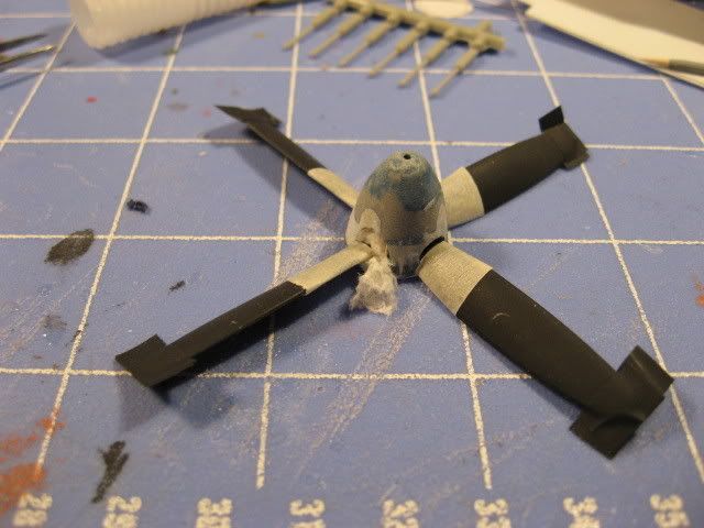

Yes it was and it worked. Painting has started. While I wait, I tried a new trick. for the gaps in the spinner, I stuffed the cavity with tissue and added a couple of drops of CA with a kicker. It hardened into a sandible fiber that I covered with putty. Worked okay I guess. :)

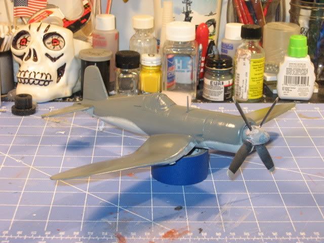

Here's how the work is coming along.
