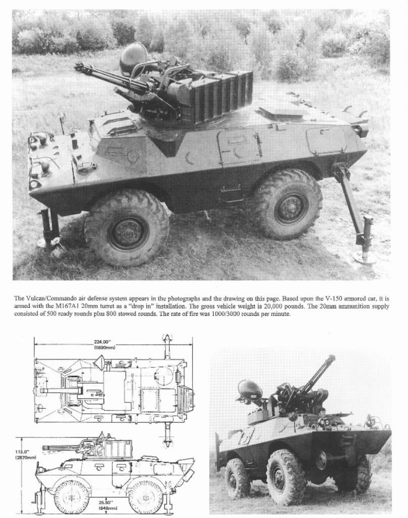

Wow that Vulcan Commando! Imagine that beast for convoy escort :o

Quote from: Cybermax on March 19, 2010, 05:40:15 PM
Exactly what I thought of.  Give it some RPG screens or bar armor, and maybe beef up the turret protection a little, and set it loose in SW Asia.
Vulcan Commando looks cool!  :wacko: *eyes-HobbyBoss-Commando-in-stash*  :wacko:
For some reason, I'd have thought a fit like that would be much bigger. But this is not the turret as seen on the M163 Vulcan, is it? Or is it the same turret, but only with an exterior ammo can? :unsure:

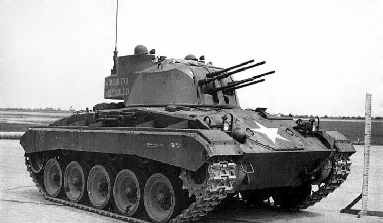

T77. Experimental SPAAG with 6 x .50cals on a Chaffee chassis:
Quote from: ChernayaAkula on March 20, 2010, 11:36:14 AM
Same turret.
It is not the same as the M163 (which uses the M157 mount), the M167 is the trailer mounted version with linked feed,
and numerous other differences.
Cybermax
You wouldn't happen to have a slightly larger version of the profile view here. I'm curious as to know what the dimensions pictured are.

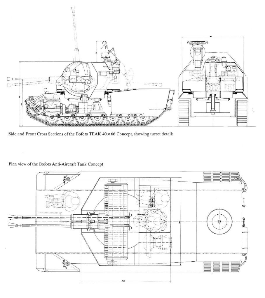

Quote from: GTX on March 05, 2010, 02:38:47 PM
Ancestor of the M247 Sergeant York DIVAD (Division Air Defense) SPAAG?
The Bofors TEAK proposal:
I like this design :wub:
