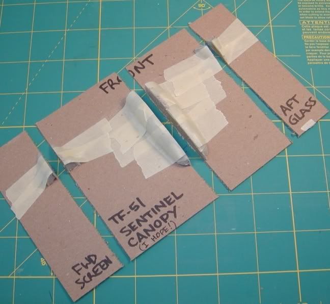

In the past (like on the A-5 Menaz, when I've had to cut similar canopy pieces, I usually get cracks and chips if not the complete destruction of the clear parts so I came up with a new technique:
I stuffed the clear parts with Plasticene to better support them as they pass through the bandsaw.  Likely not good for the bandsaw but it worked extremely well.
1. The parts mounted to cardboard (safer as it keeps one's fingers away from the blade) with the modelling clay packed in underneath to support the pieces from the downward blast of the bandsaw blade's teeth:

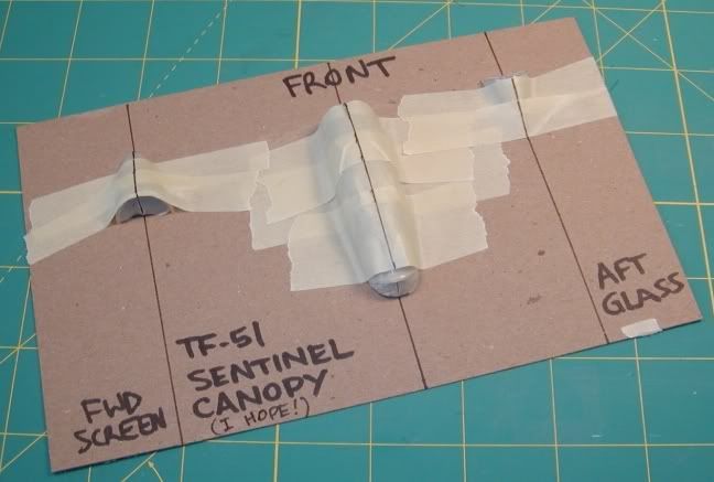

2. You see here the parts split in nice, clean halves:

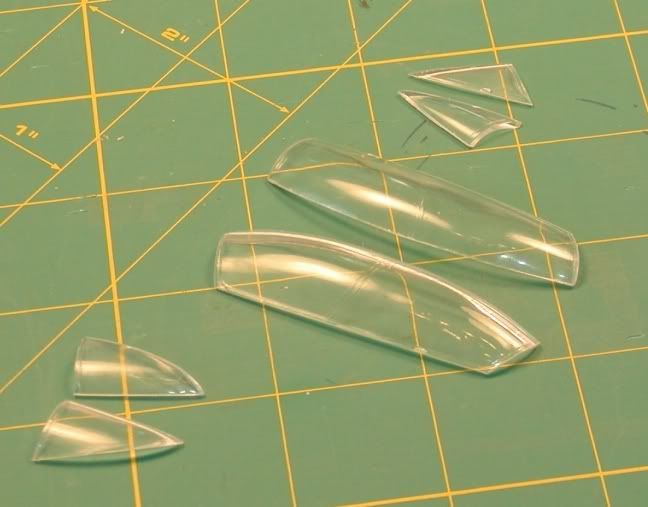

3. I was very happy with the results----far better than I obtained with the Menaz (no plasticene clay used on that):

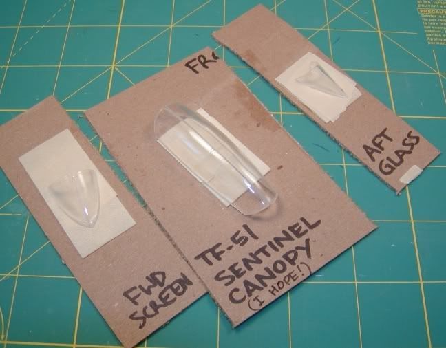

4. Although not yet polished up, they already look pretty good mated back together:
But now I have to file down 2mm from each inner edge to get the final cockpit as close as possible to the cockpit aperture (scroll back a few pages).  Will it work?  Stay tuned: Same What If time....same What If channel!   :thumbsup:
