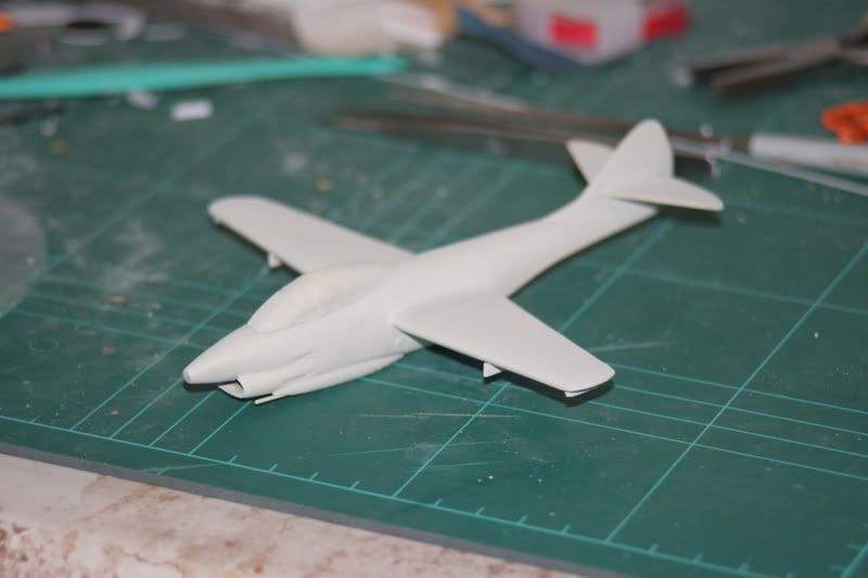

Progress pictures. The Migina's back upstairs for some minor PSR fixes, having had an overall spray of Humbrol 147. This is the undersides and lightest squares colour.
Boy do digital photos flatter! What you can't see here is that the gear doors are very rough: I've actually re-scribed some of the filled lines now, just to make them consistent. The paint has also got a curiously mottled look in places: too much thinners, I think....
BTW, the rough-looking intake lip is actually internal masking tape, to protect the black.
