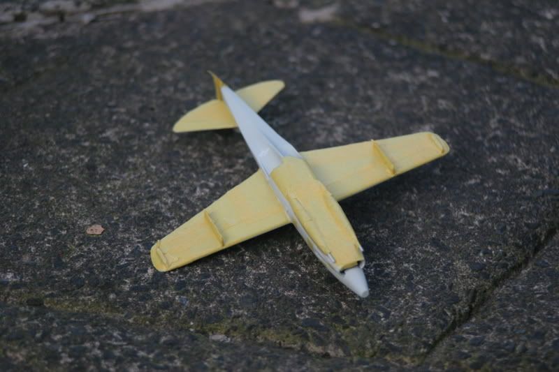

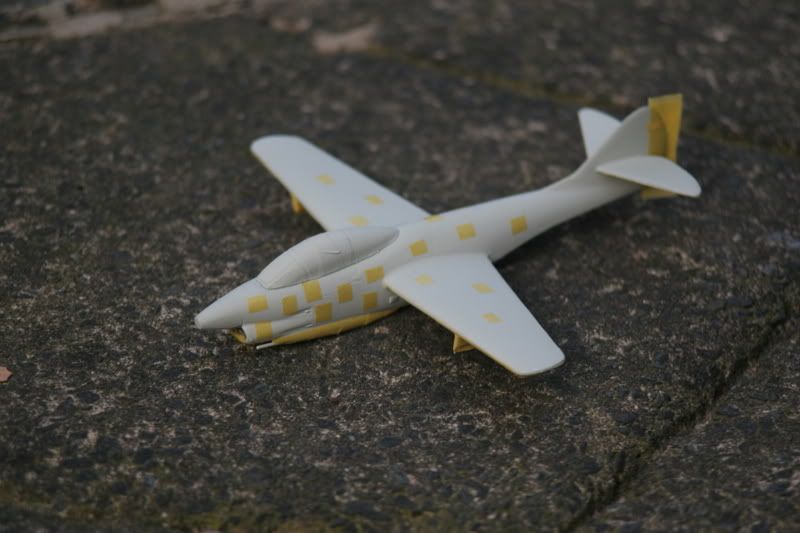

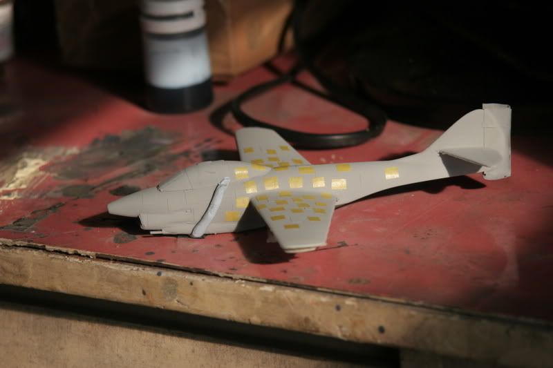

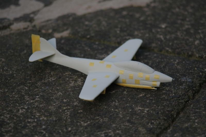

Yes I know that my squares are bigger than Arc's: that's because some experimentation showed that when I try to cut masking tape squares smaller than 5mm, I end wearing more of them than I manage to apply.... :rolleyes:
The rear fuse underside doesn't need to be masked because I'm hand-painting it Steel after the spraying's over.
Hey this weekend we've had the first decent sunshine the UK has seen for months and I am NOT spending all of it in a basement and an attic, deadline or no deadline!

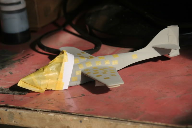

Anyway, coat of Humbrol 64 Light Grey (Zone 1 base colour and Zone 2 spot colour) on, and more square-bashing done:

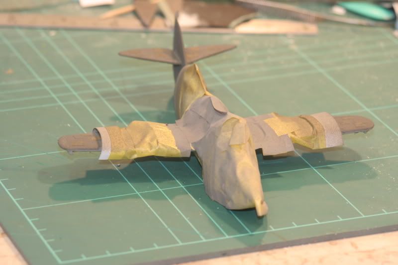

The Blu-Tack "mule collar" is there to make a "soft mask" for the feathered dividing line between Zones 1 & 2. Yes I know I could, in theory, have just sprayed it by hand, but given that I've used an airbrush on exactly ONE model so far, my confidence in my abilities is justifiably low.
Here's the soft mask finished, with a strip of thin card and total masking job on the front fuse:
From this angle, you can see how the mask stands off the surface, allowing the paint to "scatter" under it:
Is this a good technique? No idea: I've read about it , but never actually tried it before........ :blink: (where's a fingers-crossed and/or praying smiley when you need one, eh?)

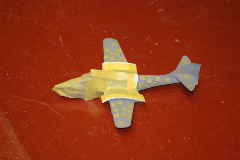

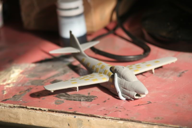

One coat of Humbrol 140 Gull Grey (Zone 3 base and Zone 4 dots) applied, and the square dance continues:
And here it is ready for the Zone 4 coat, which I've just applied:

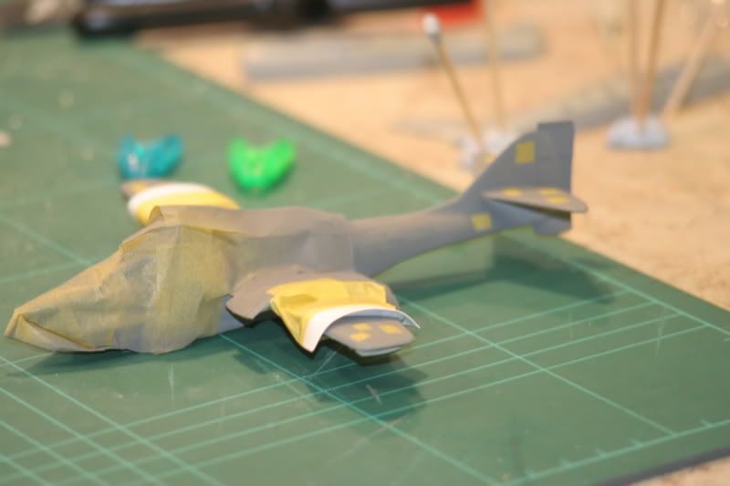

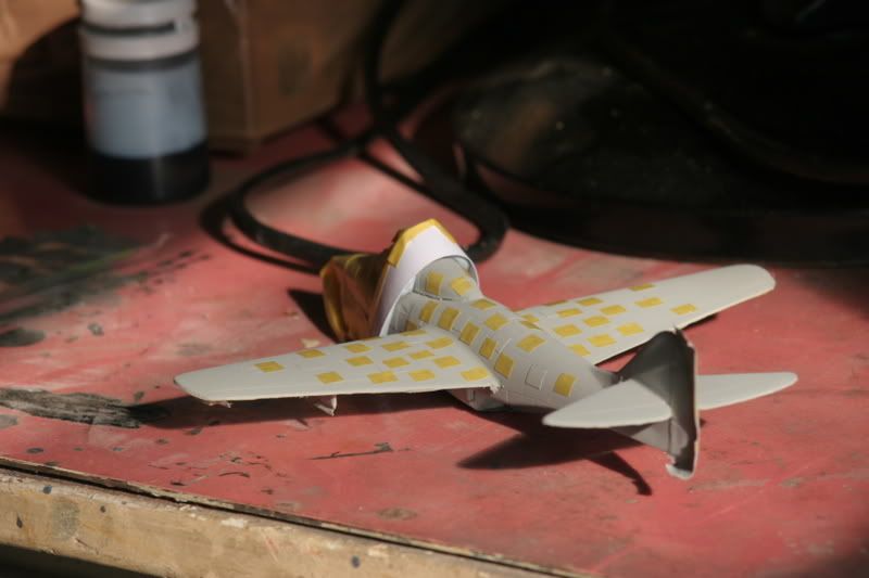

Coat of Humbrol 27 Sea Grey (Zone 4 base and Zone 5 dots), dotted and collared:
(Forgot to do a "clean" picture before I started masking again - sorry)

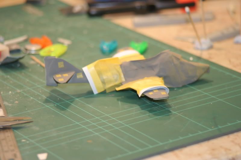

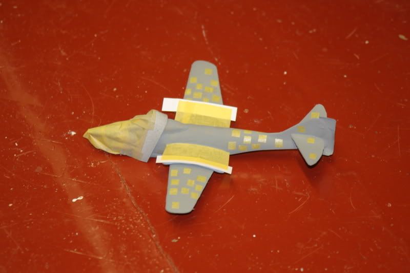

Full mask and collar:
It's now sitting in the cellar with a coat of Humbrol 32 Dark Grey (Zone 5 base) drying....
