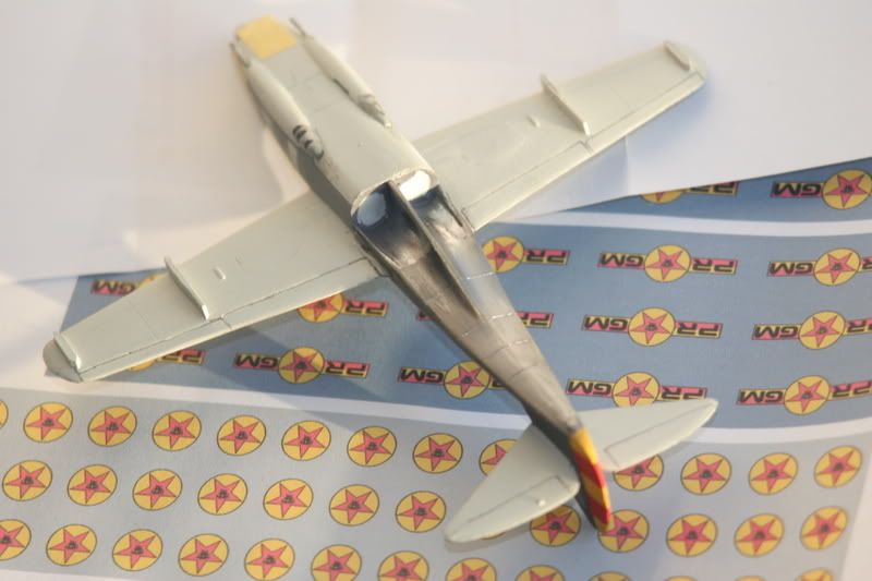

Decisions, decisions... :angry: The decals are beautiful, and on test have proved FAR too translucent to go over a variably dark grey background, AND my only tin of spray varnish just died  :banghead:.
So, options are:
1. Reprint the decals on white transfer paper and then go in search of matt varnish on a Sunday (and then try to cut the ****ing things out accurately,
or
2. Mask and paint white bits on the model to act as a background for the translucent decals....
Hmmmmm  :huh: :huh: :huh:
Managed to get some more matt varnish and had a brainwave: I'm printing the decals on white paper with a grey background that kinds matches where they go on the model, so if I do have to cut a little wide, the extra will still blend in.  :thumbsup:
Soooo I've just had 97 goes at getting the shades of grey right, because my printer, inevitably, doesn't produce the same hue as the screen...... :banghead: :banghead: :banghead:

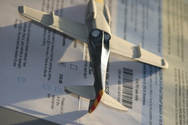

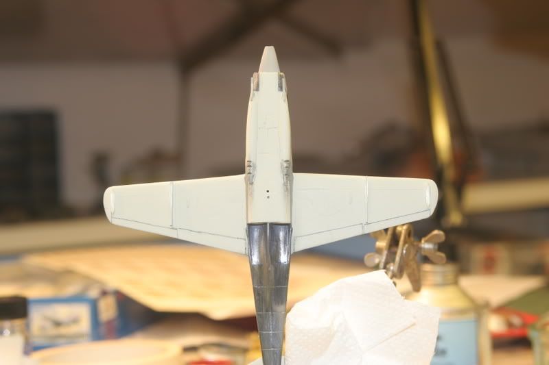

Here's some pics of the stripey tail and the Metalcote Steel underside (think the Humbrol code's 28003, but don't hold me to that):
Always difficult to photograph shiny things, and these were real quick and dirty....
I made a bit of a hash of this, to be honest. Since you have to polish the metalcoat to get the shine, I thought I'd better lay it on thick so that it didn't wear through, so I did the normal trick and painted with the gunk off the stirring stick. BIG mistake: this stuff is gooeyer than normal Humbrol and dries VERY quickly, so it ended up looking more like plaster than paint: I had to flat it off with 1500 grade wet'n'dry to get a flat enough surface to polish.... :rolleyes: However, since these plates are there to protect the airframe from the jetwash, I dare say they wouldn't be exactly pristine on the real thing....

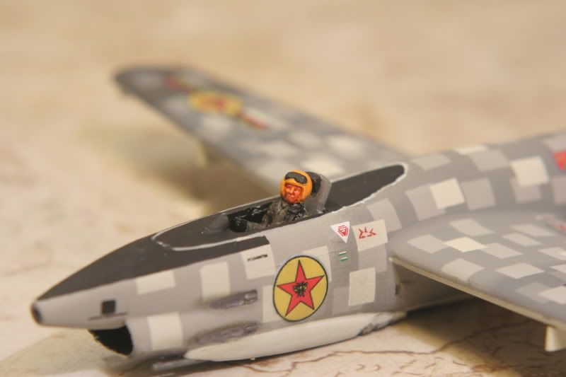

Had a blazingly successful evening, and short of decals, it's almost finished!

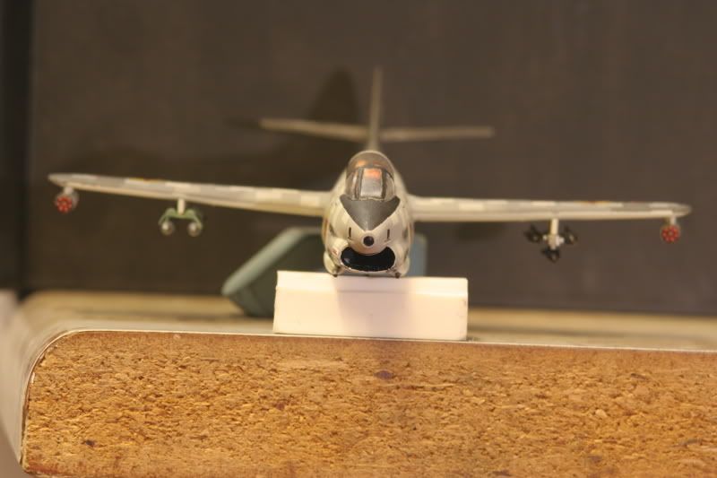

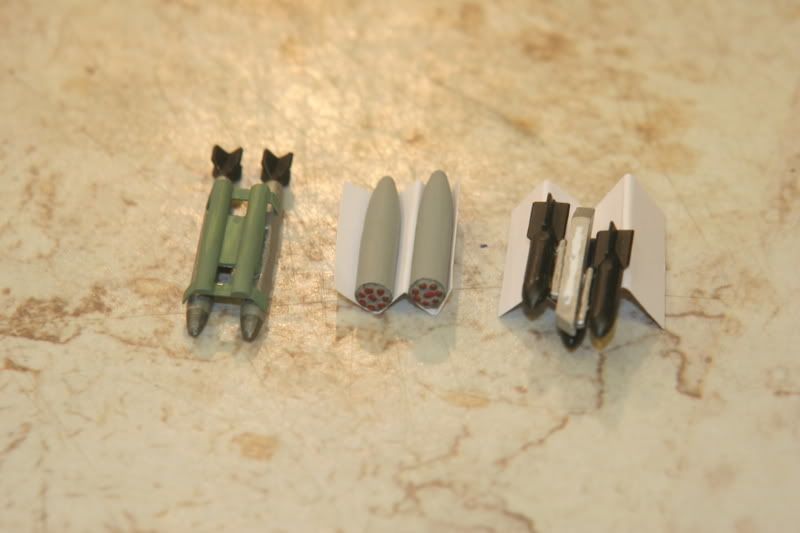

Weapons. Left to right, 2 x armour-piercing bombs on a scratch-built carrier, two rocket pods, and three anti-personnel bombs also on a scratch-built carrier. Yes I have noticed that one of the rocket warheads has "blobbed" - 'twill be fixed shortly (scarily, I'm spotting things on the photos that I've missed IRL!)

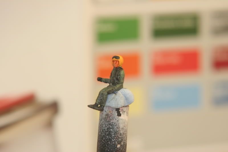

Case in point: I've just noticed a flaw in the paint on the pilot's face:

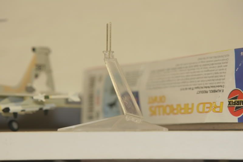

I ummed and arrrred for ages about the stand, because the only place you can really attach it is right where I want a decal. Eventually, I came up with this:
The stand is actually from a KP kit, chosen because it resembles a section of the "facetted" star in the PRGM flag. The two rods go into these holes in the bottom, which will let it bank to each side with NO chance of it falling off. The two holes should vanish quite well in the middle of a decal.
Think that last picture shows off the metalcoat better than the others, actually. The plane's currently suspended like that because, with heart firmly clamped in mouth, I took the Dremel to the nose and cut a forward camera port with a cylindrical diamond engraver and then filled it with black paint, which must not sag until dry. Once dry, it'll get a blob of Clearfix in it.

Looking very good, Weaver... the base join is definately of merit with the pin joins, allows you to remove it for transport if necessary.  Also an interesting choice of warload, but hey, it's what if for a reason!
