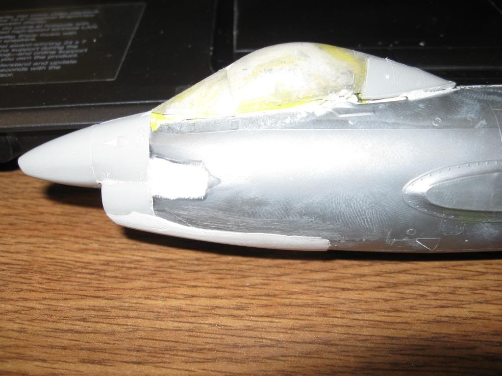

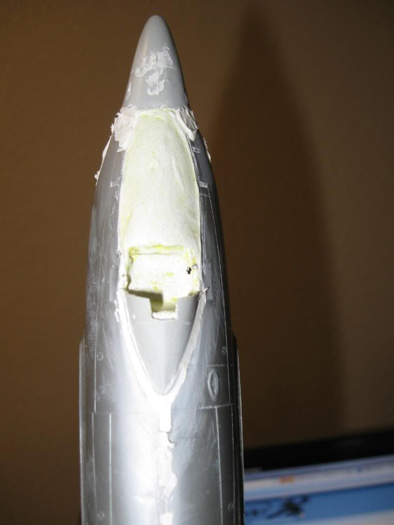

Ouch, that's going to need some sanding to smooth out the gouges you made... could have just puttied a smooth transition rounding over the cannon ports and drilled them in at the join.  Still going to need some work at that little ridge at the top of the nose join though.
Looking good so far though!
Actually those gouges will be covered in putty . I had to cut the excess material away to transition from the oval shape of the MiG to the  8 shape of the Gina. For the cockpit I will fill it with clay after installing the fairing from the Gina fuselage and then press it into a layer of epoxy putty on the MiG. That will give me a platform on the fuselage that will match the contours of the Gina canopy.
You're on a roll, Toolslinger! Looks like you got the putty work just right!
I think our old friend Mr Putty-Sand-Repeat will be dropping in soon.
"Like a good neighbor, PSR is there..."
Sauragnmon
I'm skeptical that you did enough removal then to transition it smoothly, but then I'm looking at a relatively flat image, and I'm not in your shoes, sotool.. though you could have used the rounded shape and the slight protrusion over the Gina nose to cover the gun ports a little more, allowing a narrower field of fire in perspective.  I don't know, I'm probably rambling.  I don't have the kits, and I haven't worked with either, so I can't really say anything definitive, but you're doing a bash-up job so far!  Keep working that sledgehammer, man!

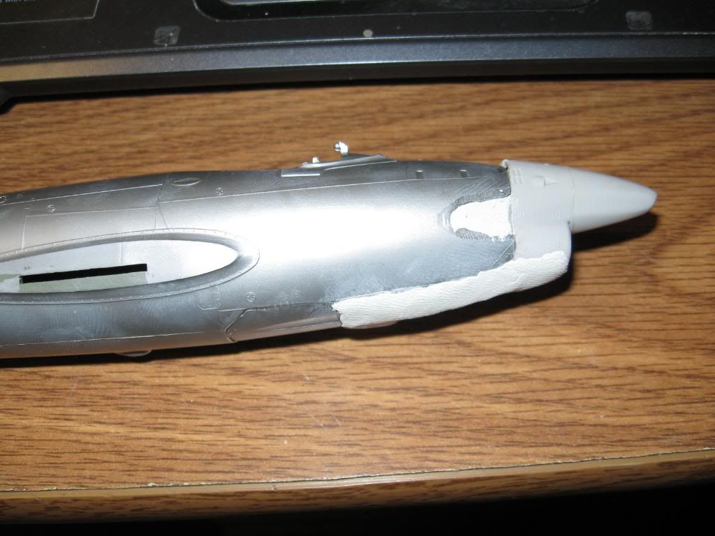

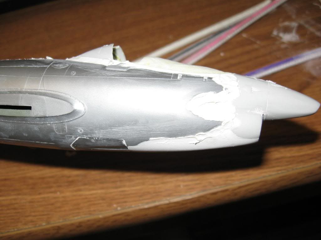

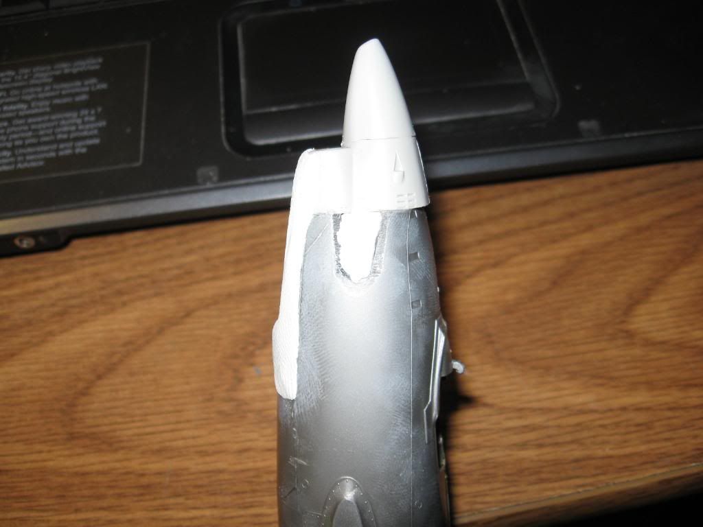

Carefully hand sanding  :rolleyes: the MiGina
I tried to give as many different angles so ya'll could see how she is blending

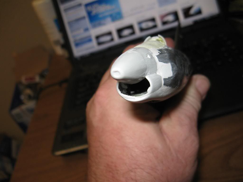

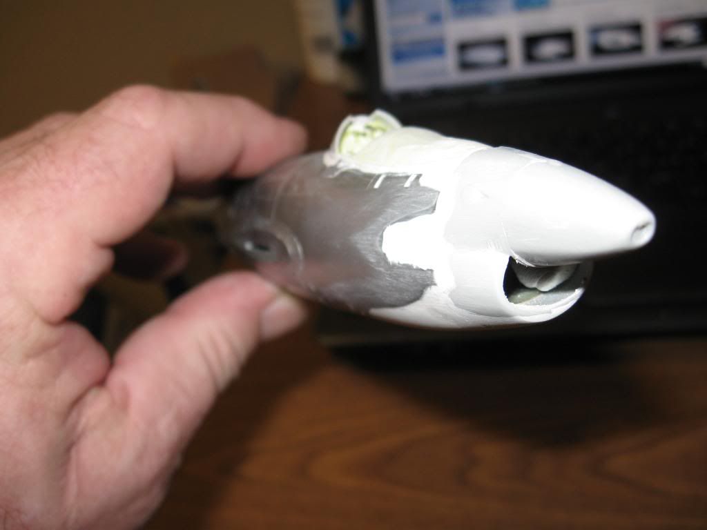

Looking good so far, tool.  The setup's different, and it looks a whole lot different after having seen the different perspectives.
Wow - I wouldn't have believed that those two pieces could come together as effectively as that - well done!
Question - how did you fill the sawn-off chunk of MiG? Did you put a piece of plastic card behind it before cutting and then fill in the resulting trough, or what?
My good friend epoxy putty. Specifically the kind made for fiberglass boats. It sticks to styrene very well.  I made the cuts to blend the Mig to the Gina nose with the dreaded Dremel tool with a drum sander bit and then just went in through the Gina intake with a probe.
