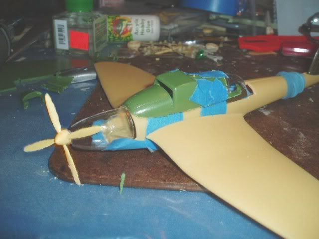

In order to allow the all-resin propeller assembly to spin, I felt compelled to drill V-E-R-Y C-A-R-E-F-U-L-L-Y through the center of the four solid resin pieces that make up the prop and shaft. In the photo (curse the camera that wants to focus on the FLOOR in stead of the subject), the thing to the far left is the bulkhead and pilot's seat rest (upside down), then to the right is the shaft housing, then to the right is the butt end of the propeller spinner (formerly attached to the shaft housing but carefully sawed into a separate piece to attach properly to the spinner) and then the prop/spinner. The actual shaft I will use is stainless steel tubing that fits within a larger-diameter stainless steel tube. From previous experience this has proven to be a nearly frictionless mount, so I am optimistic. The end of the shaft farthest from the propeller spinner will be behind the bulkhead. Thus this Aichi 119 will have a propeller shaft VERY SIMILAR to the real thing (since the engine was located behind the cockpit bulkhead). Hey! REAL HISTORY in a whif!  :mellow:
I think I am going to have to leave the flat clear piece at the front of the canopy so that the shaft housing has something to attach to, and just drill a hole in the clear piece for the shaft to go through. Resin-on-resin is almost friction-free, but as it looks now, the resin butt end of the prop spinner will be up against the flat clear piece. A little powdered Teflon should allow it to spin freely. I may also make a washer "flywheel" for this one so this old f*rt won't run out of breath trying to make it spin!

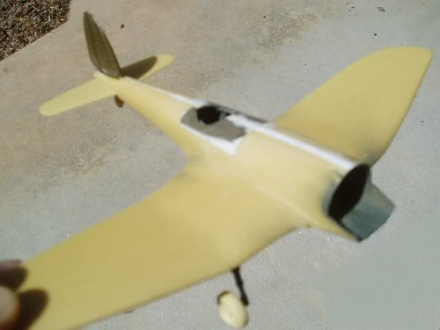

Not really picture-worthy, but I found that when the wings were put onto the fuselage halves (and they fit with virtually no seam) the wing angles, when seen from the front, were symmetrical, but the wrong angle (wing tips too far "up") so I had to put spacers in the top fuselage (.120--three sheets of .040--, tapering down to .020 near the rear fuselage) to bring down the wing angle. It worked, and I think adjusting everything else will be OK, too--just more work. Now I can proceed.

Here is a pic (slightly out of focus) of progress--I put the Italeri vertical stabilizer and top gunner's position in and PSR'd. You can see the white line down the top of the fuselage as the "spreader" to enable the proper wing dihedral. I have put "Rita" landing gear on, with aftermarket squashed main wheels. I have scraped off the four sets of built-in exhaust stubs, and will have collectors/pipes from a Roden He-111 in the appropriate places (underneath the fuselage, where two rows of exhaust stubs were right in the middle, the exhaust will now be spread out to allow for under-fuselage ordnance).
The photo doesn't have the top radiator setup and gunner glazing (some PSR drying) on it yet, but soon will have. I will have to paint the gunner, put in the seat/ring, machine gun assembly, drill out an opening in the glazing for the MG's, and put in some fine brass screen for the radiator opening, and then work on the cockpit/glazing/propeller module.

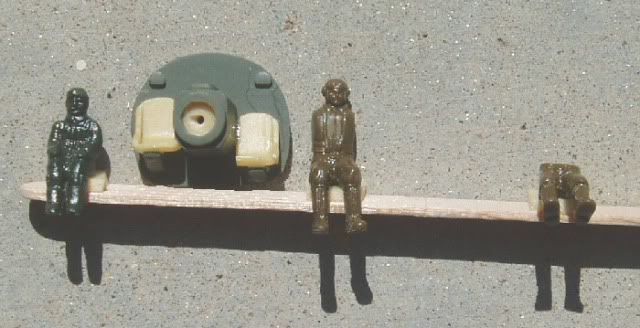

With few exceptions, all my model aircraft have pilots and/or crew in them. I just think it gives a little personality to the model, and a sense of scale. As we all know, model manufacturers these days seem reluctant to provide a pilot figure. Anyone who has a lot of the old Airfix/Frog and other such manufacturers' kits know the WIDE variety of both size and quality of pilot figures. Luckily I have enough decent pilot figures squirreled away to people the whifs I will likely make. Most especially, the crew figures from the Italeri He-111 are the creme-de-la-creme for me (highly detailed standing, sitting, and prone figures with separate arms come with the kit!).
I am now at the point in the Aichi/Heinkel 119 of crafting the pilot's compartment. It's complicated by the propeller assembly and the all-around canopy fit. I now realize just how SMALL that compartment is! The fuselage of the He-119 is wide enough (just barely) to squeeze in two figures side-by-side, even with the large propeller shaft housing. The "head room", however, is astonishingly small. That is, a "standard" pilot (estimated at 5'10") can't sit in the provided seat and still have his head in the cockpit--his entire head would have to be sticking out in the airstream. The fuselage HEIGHT at the pilot's compartment is about the same as, say, a FW-190, but WITHOUT the canopy bubble.
I had intended to have have a German pilot and a Japanese co-pilot in the cockpit (I already have a German top gunner), and had planned on a diminutive Japanese figure (roughly 4' 10" or so) just for grins. The Japanese figure fits comfortably in the seat provided. The German pilot does NOT. The model comes with a set of pedals for the pilot that would be usable by his KNEES given the distance provided. I dropped the model's seat down nearly to the floor of the cockpit, had to break off and re-attach the legs of the "sitting" pilot figure to make his legs stretch out instead of down, and will have to re-configure and scratch-build a new pedal setup commensurate with the pilot's height.
The above, and some PSR setbacks have delayed progress. I am also conflicted with resin kits--their simplicity and sturdiness are appreciated, but the necessity of using super-glues with their short working time is a bummer. Maybe others will not notice, but **I** notice some slight alignment problems that would not have occurred with styrene. With cyano-acrylates there is no time for scrutiny and adjustment. Maybe I will just chalk it up to sloppy "manufacturing tolerances" within the Japanese aircraft industry.
Anyway, here's a picture to show you the relative sizes. Note the fuselage bulkhead bottom is flush with the stick upon which the crew are sitting. I also have a double-sticky "pad" that the crew are sitting on so I can paint them easily without handling them. The height of the bulkhead is all there is! The "tall guy" is really the gunner, and had actually been downsized a bit to properly fit in the gunner's perspex (the Italeri figure has a separate torso). He wouldn't fit in the cockpit without further modification. The torso-less legs on the right are the revised pilot's legs I will have to use, and still I will have to downsize him to fit. I have discovered (and will use) the He-111's pilot setup with pedals and control column for the 119.

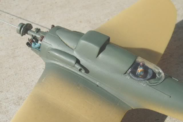

I use lacquer thinner to clean my airbrush. It's more aggressive in cleaning out the crud, but it's also DEATH on plastic, melting it fairly quickly. I have even used it sometimes as a styrene bonding agent. Wouldn't you know it, I had all my styrene and resin parts out on my desktop, when the lacquer thinner bottle tipped and spilled. A tide of lacquer thinner washed over my parts!!! Luckily I had the presence of mind to forget about the resin parts (immune to lacquer thinner) and quickly grabbed my styrene parts. Too late for some, but BARELY in time for some others. I had a spare He-111 tailwheel to replace the "crazed" version:

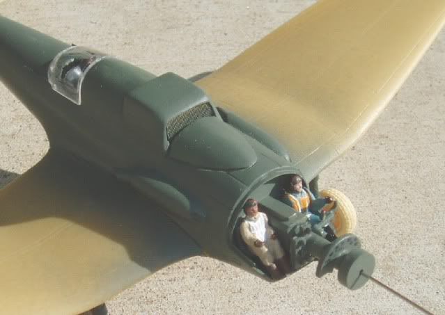

The rear gunner's perspex ate it, too, but luckily I also had a spare of that one. Here is my cockpit module done, FINALLY. The German pilot has his Japanese co-pilot. WHAT A HASSLE trying to pre-fit everything in that cramped environment! I had to grind down and thin the cockpit opening and add thin tabs for attaching the thin canopy halves. I had to shave off the pilot's right arm and make it seem like it's just up against the shaft housing (and I painted a "glove" on the pilot's right thigh as if his hand were resting there). Notice the red firing button on the control horseshoe. You can see the dorsal radiator setup, and the "movable" conic section in front. The long "wire" is the propeller shaft that is attached behind the cockpit bulkhead so I can "pull" the module up against the front of the clear canopy when I get to that point. The engineering and "foresight" needed here is almost overwhelming.

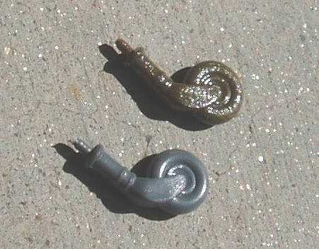

The gunner (minus his arms, which will be up holding the machine gun, also missing here) is in place, and his perspex slides toward the rear on the rails. Note the humongous exhausts--sticking out a bit more than I had thought, but necessary for night attacks, and the larger Jumo engines that replaced the DB engines of the original Heinkel product.
So the project is moving along. LUCKILY the actual clear front canopy was oversized to begin with, or my adding space would have left a big gap. As it is, the clear canopy fits PERFECTLY. I know attaching the canopy will be tricky, as the cockpit module and the canopy need to be attached simultaneously, and things are very squirrely.  The round thing in the front of the cockpit module should glue itself to the canopy, leaving the "wire" (actually stainless-steel tubing) free to rotate. The base of the prop spinner will then attach to the "wire", and eventually, after painting, the prop and spinner will attach to that and....voila, a spinning prop! Eventually, it will look like this:
