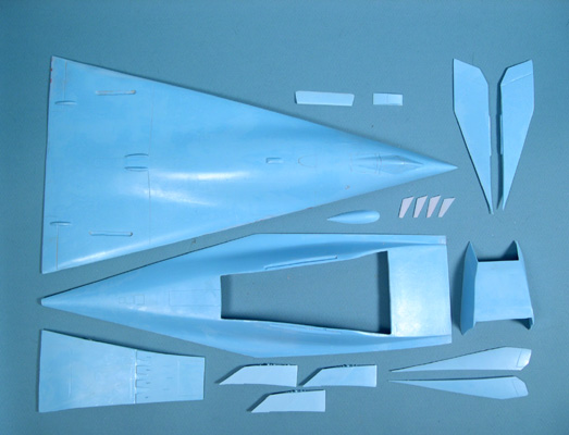

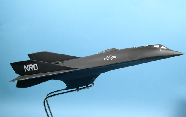

Orionblamblam
Rafael
Thanks, Scott. If my model vaguely resembles yours, that's a very big compliment :bow: :bow:
