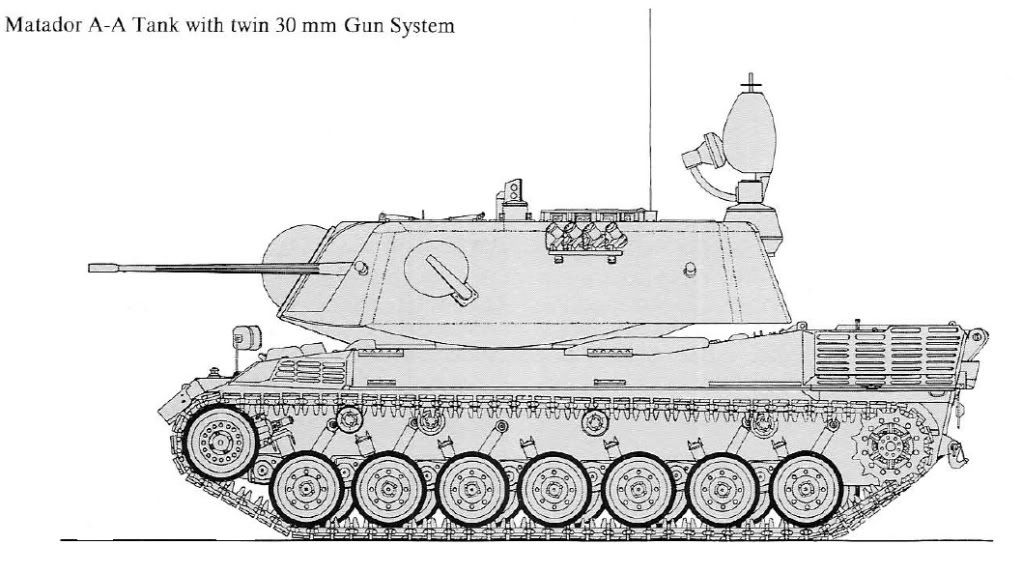

Matador was originally proposed to the US Army for its SPAAG programme which eventuated in the Sgt. York abomination.  If they had accepted either Gepard or Matador, they'd have had a functioning system up and running well and truly by the start of the 1980s.  Instead they have nothing worthwhile in 2010.

In 1965, the then West German Army was seeking a replacement for the clear-weather, United States M42. It would have an all-weather fire-control system and be based on the chassis of the Leopard 1 Main Battle Tank (MBT). In June 1966, a contract was placed for the development of a twin 30 mm vehicle that later became known as the Matador. Prime contractors for this were Rheinmetall (armament and turret), AEG-Telefunken (target tracking radar and computer), Siemens (search radar and IFF) and Krauss-Maffei/Porsche (chassis and power supply system).
At the same time, a contract for two vehicles armed with twin 35 mm cannon was awarded to a consortium consisting of Oerlikon (armament and turret) Contraves (computer and systems integration), Siemens-Albis (tracking radar), Hollandse Signaalapparaten (search radar) and Krauss-Maffei/Porsche (chassis and power supply system). These two prototypes were called the 5PFZ-A and were delivered in 1968.
Following comparative trials with the Matador and the 5PFZ-A, a decision was taken in 1970 to concentrate further development on the twin 35 mm version developed in Switzerland. This eventually became the Gepard

Drawing of the earlier posted Matador SPAAG should anyone want one:
regards,

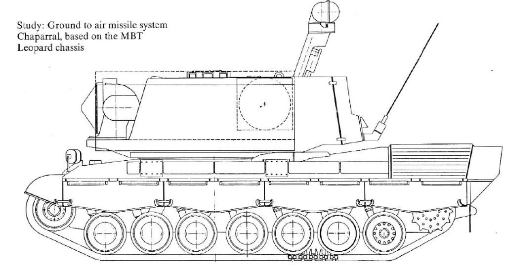

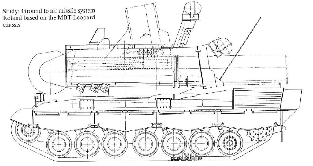

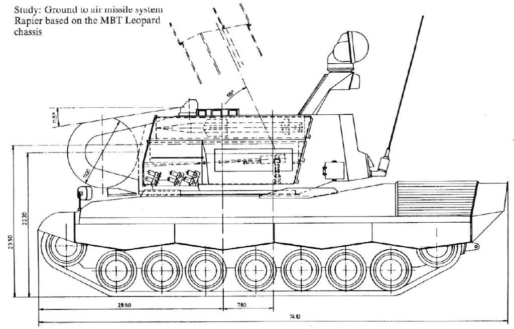

Some SAM equipped 'Gepard' proposals:

Again - great find Greg with the Gepard_SAM proposal designs!!!!!!!!!
Can I ask what the source is that you are pulling this gold from??
Book?
Web??
M.A.D
