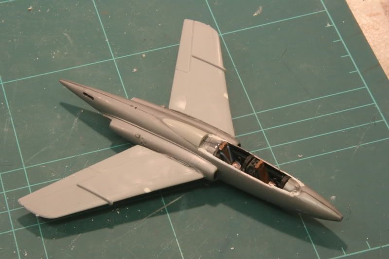

Make note of this though: when putting in a spacer to support a cockpit, don't push it in too hard or else it'll bow that fuselage half and they won't match up and you'll spend ages filing and sanding them down - ask me how I know this..... :angry: :banghead:

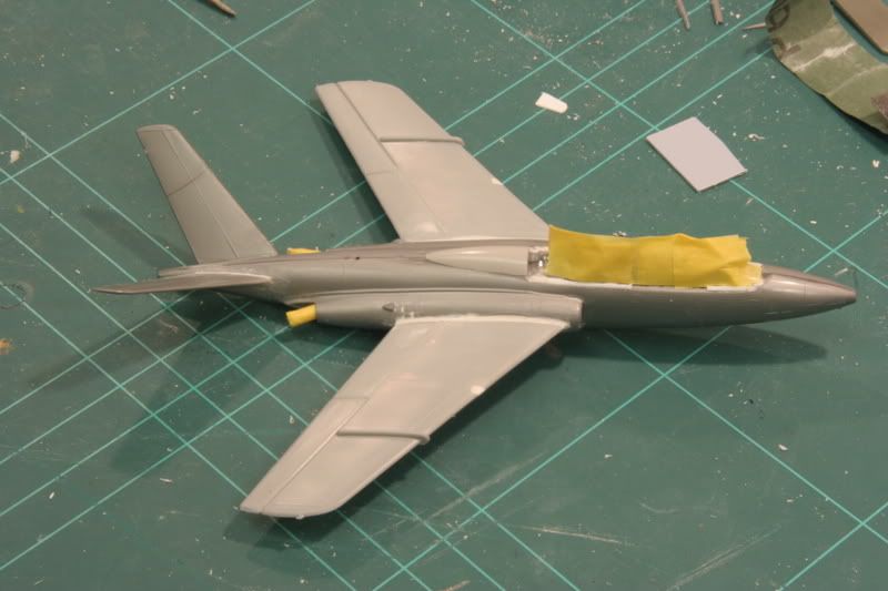

More progress - we have something that looks kinda like an aeroplane:
Since that was taken, I've filled in the wing root gaps with Evergreen and putty, but I've yet to sand it down. The white spots on the side of the rear headrest are where I've filed the corners off: turns out that with it all together, the canopy wouldn't fit over the rear seat headrest...... :banghead:

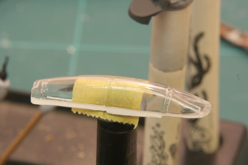

Okay, tailfins on, PSR done (I think) and cockpit masked ready for a first coat.
BTW, the bump that fairs in the back of the canopy (cut from some anonymous drop tank) doesn't follow the canopy line. Initially, I was going to sand it diwn until it did, but then I remembered the radio aerials under the back of the RW mag's canopy, so I decided to leave it and paint it radome-black: it's kind of the equivalent of that black teardrop on the back of A-37Bs.

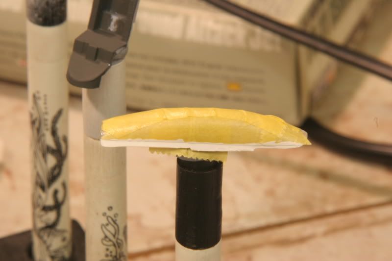

First paint, on the canopy rails:

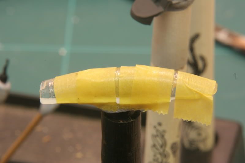

Canopy sill painted and unmasked:
And re-masked for the bows:
The bows have now been painted and this time I havn't gone over the already painted bits, thus hopefully avoiding the "crossed sellotape" effect I got on the Migina.

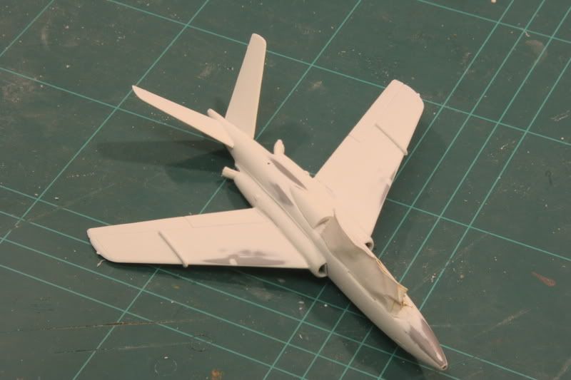

It's had another coat of white now (no point photographing it again) and some flaws are still there. In particular, there's a flat showing behind the canopy fairing on the RHS. You can actually see it on the pictures below.
Well it's as flawless and white as it's going to get for a while: I've started the long-delayed/promised re-organization/tidy-up of the cellar, so I have no where to spray for a while: no I do NOT want dayglow dust floating around the model den, ta.
It's had so many coats of white paint (which is pretty thick, too) that most of the surface detail has gone: wish I hadn't sanded down the "excessive" rivets now........ :rolleyes:
