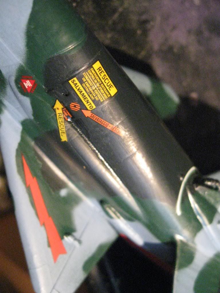

Yeah as bad as it is I can't imagine starting over. If I didn't have the effin decals on already I would strip and repaint. I can't replace the decals though with out actually starting from scratch and printing them custom. I was ready to peel the canopy and mount the danged load out. I can't freaking stand the thought of starting over on this effin putty monster. :banghead: :banghead: :banghead: :banghead: :banghead: :banghead:

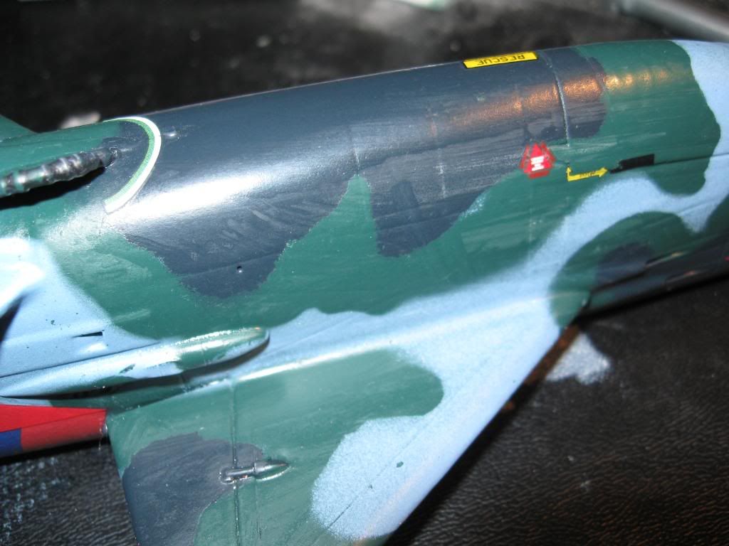

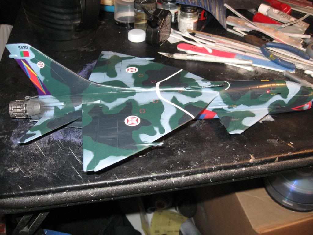

Well actually I think I pulled this one out. I have it totally stripped down now and only lost 1 decal . I want to let it set for a while to totally outgas and then try another finish. :blink: I will post some pics tomorrow ;D

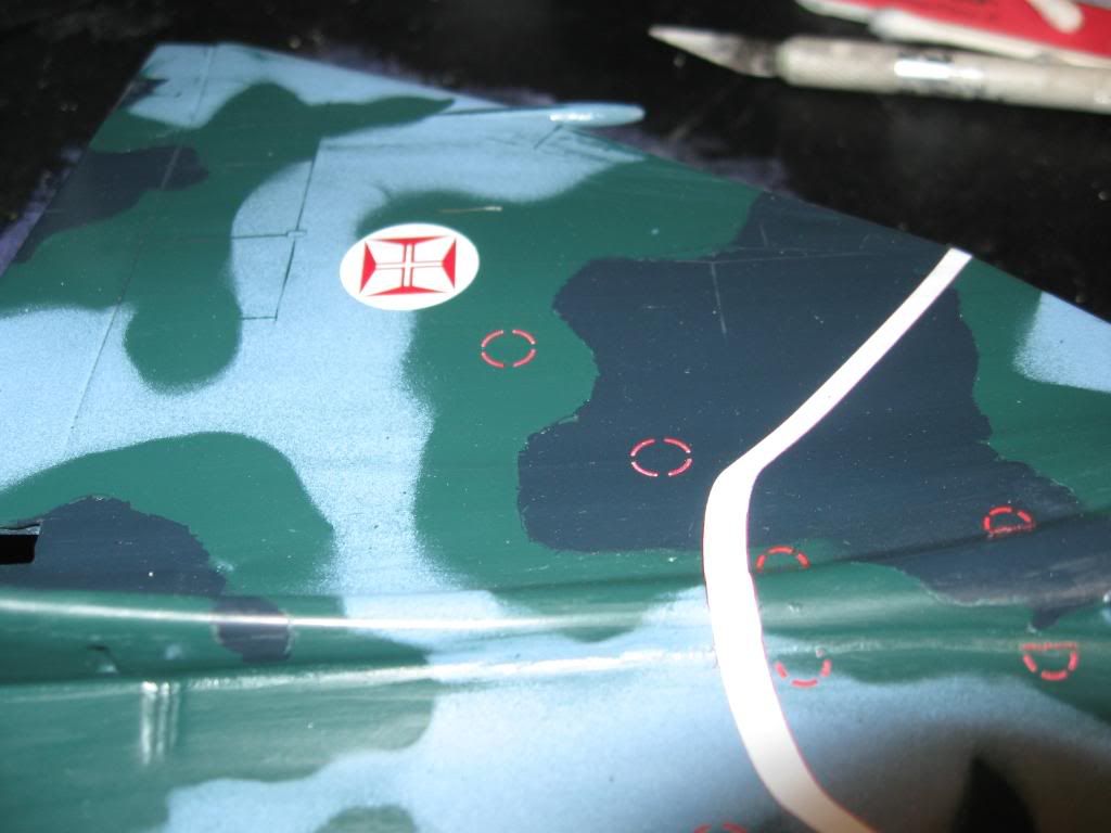

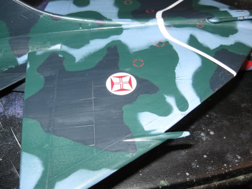

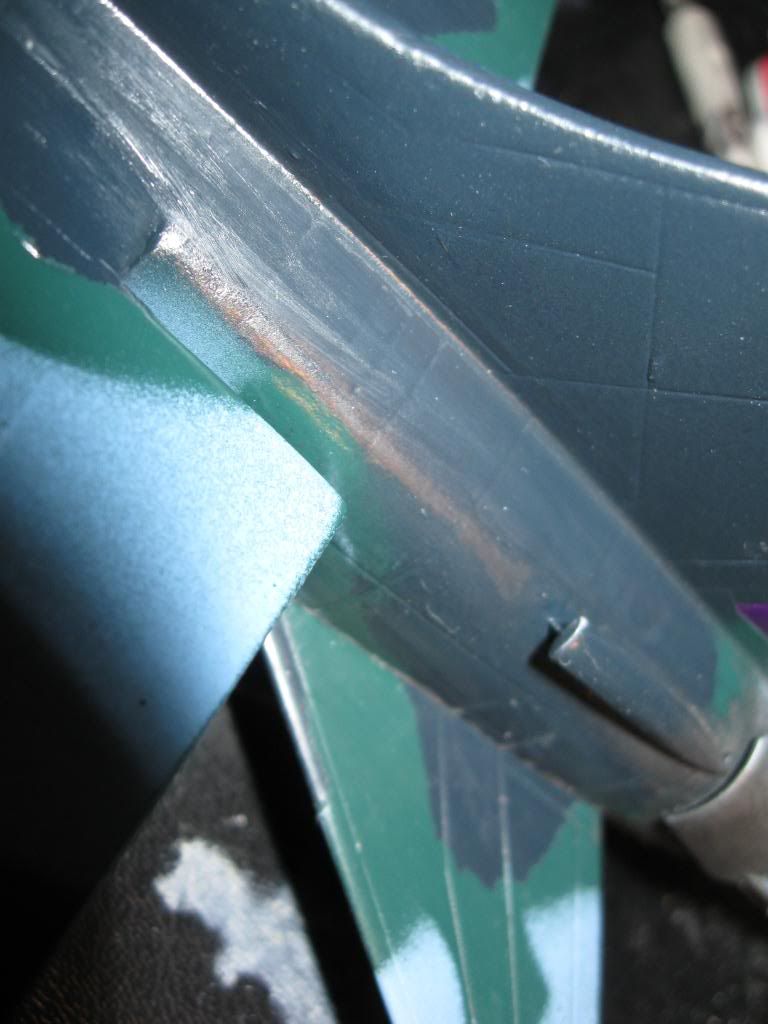

I got this fixed :huh: :blink:
I think the problem was just old can o dullcote. :huh: I warmed the can, shook well, and long and the model was not cold. But I bought the can at tiny LHS in Florida and I think it had set on a shelf for years. :banghead:
I just happened to have a can of denatured alcohol on hand and so just grasping at straws I tried it. It stripped off the dullcote down to where you see it now and I only lost 1 decal. It completely eliminated the pitting and after recoating with glosscote it pretty much eliminates the streaky appearance. But I will definitely be buying new dullcote before I try that again. ;D
