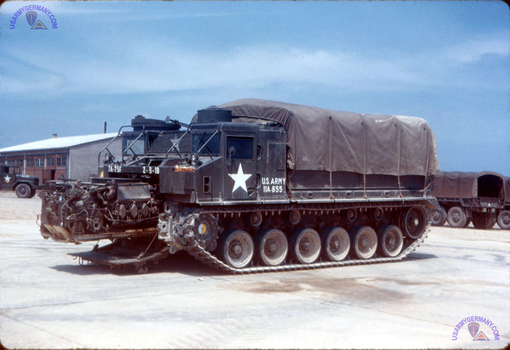

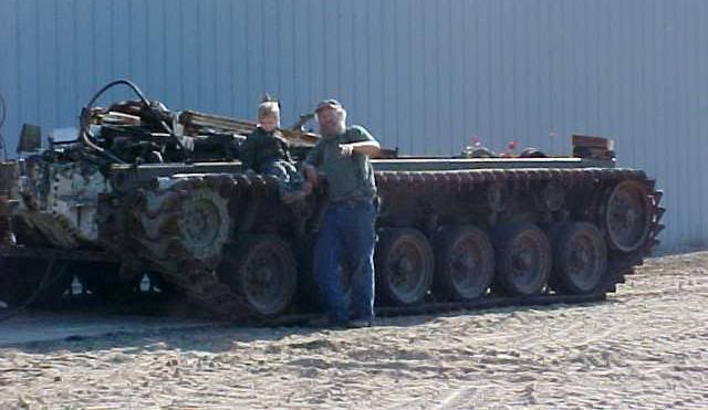

Logan Hartke
Sorry, I was the guy that was mean enough to post that one on another forum in the "Name that Tank" thread.  It is not an M48.  Look at the lower hull.  The M48 is rounded because it's cast.  It looks like a boat.  This one doesn't.  Why?  It's not an M48.
It's part of the M8 Tractor family (M8, M8E1, M8E2, M8A1, M8A2).
See?
It's actually a variant of the M24 and M41 family.
More pics.
In it's natural habitat.
Profile shot.
Do It Yourself Kit!
Model kit, showing you the details of suspension.
This guy's pointing and laughing at you for thinking it's an M48...
I'm just giving you a hard time.  It's a rare, rare vehicle and it's not too well-known.
