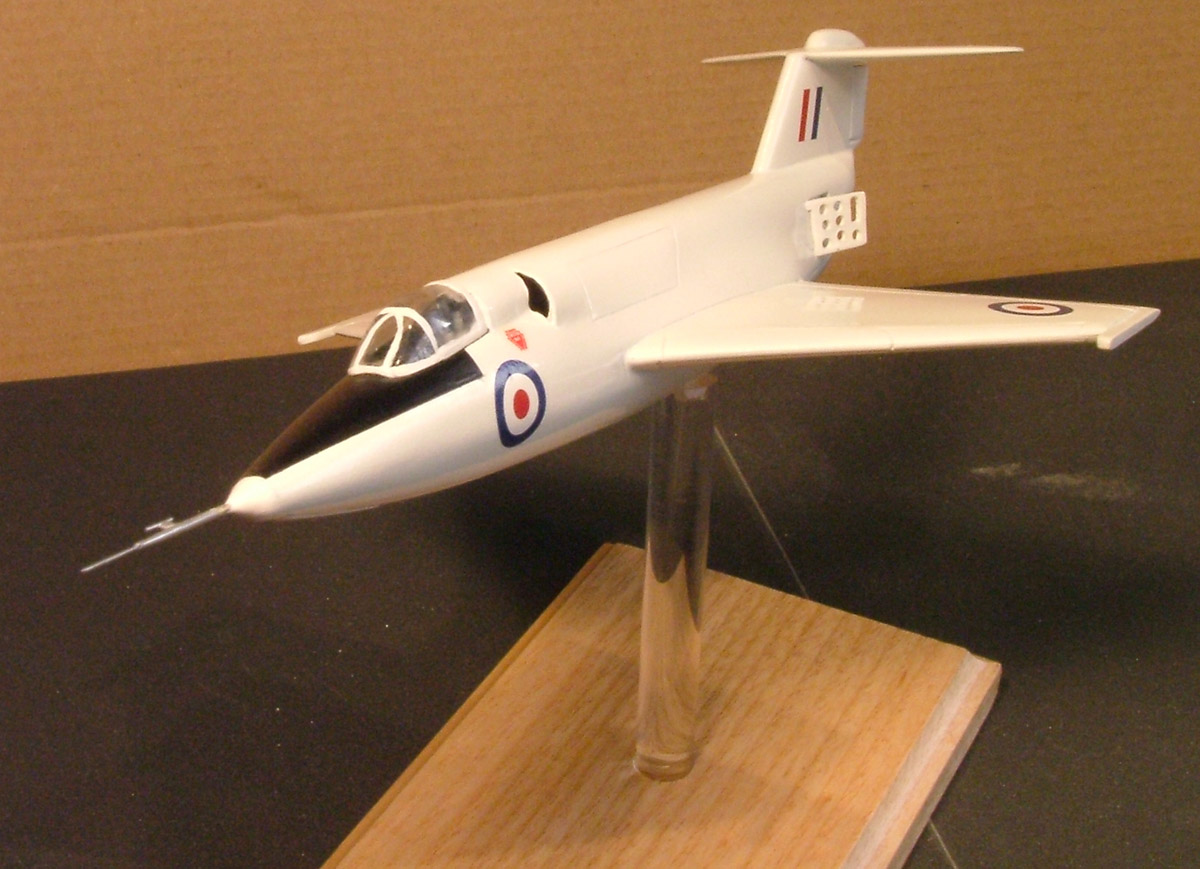

Hey, that's some pretty cool stuff ! Sure is a lovely looking aeroplane. One of these days, I'm gonna get me that kit !
Thanks for posting that !
Daryl J.
Saro aircraft like this are just so cool in a bulldog sort of way.    What are there in way of kits of these?
Daryl J.
overscan
Paul Martell-Mead / Overscan
"What if?" addict
I'm awfully tempted one day to attempts a large scale (1/48 or even 1/32) scratch build of this - thanks for the info.
Gawd what a misuse of a pure interceptor for ground attack! Was it supposed to have it's HTP tanks fuelled on these missions?
overscan
Brochure has emergency ground attack role, which has limited range due to retaining the HTP tanks and rocket, and full ground attack role where the rocket is removed and HTP replaced with additional kerosene.

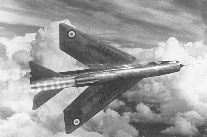

As we're talking about rocket motors, there's a photo in the latest Aeromilitaria (Summer, June 2011) of the underside of EE P.1B (XA847) as it turns away from the camera ship with it's attached 'twin' rocket pack at full chat ---. In this case it's a Napier Double-Scorpion.  This would seem to be an excellent subject choice for Colin (Freightdog) to do -- hint, hint  ;)
Would that be this pic?
Lovely shot it is indeed. :thumbsup:
