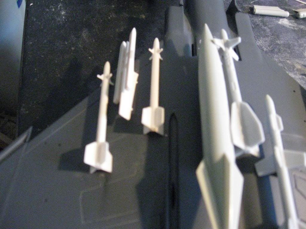

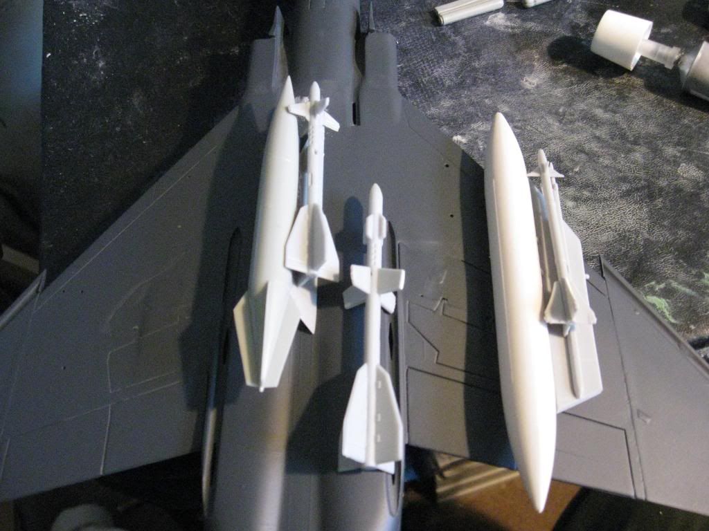

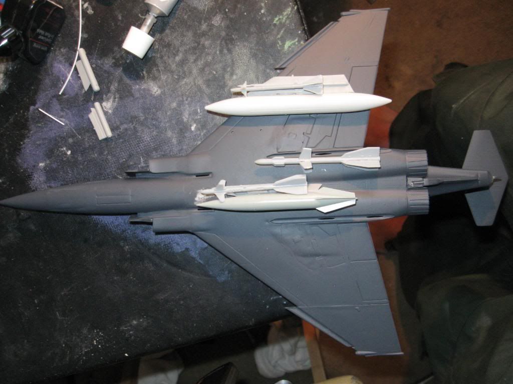

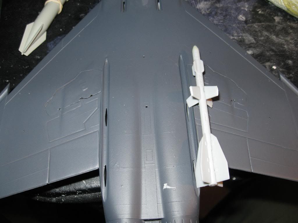

Now to keep my promise the proposed LOADOUT
The remaining recessed missile slots will be packing these long range radar guided honkers
The centerline hardpoint will be sporting a 200 gallon droptank with 2 medium range radar or ir homers
While the outer wing hardpoints will wear 325 gallon tanks +2 (each) short range heat seekers
She will also be hanging two multimode missiles on the Phantoms standard inner wing hardpoints.
That would be a total of 12 AAM's and the 20 mm :wacko: :wacko: :wacko: :wacko:

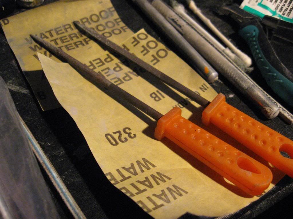

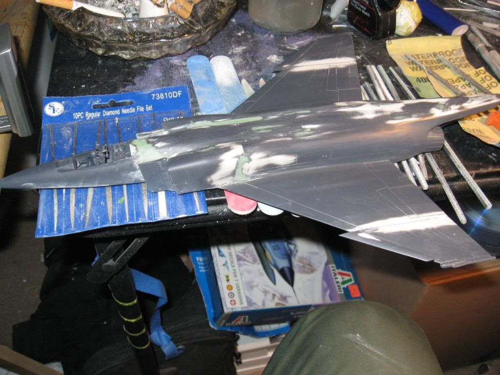

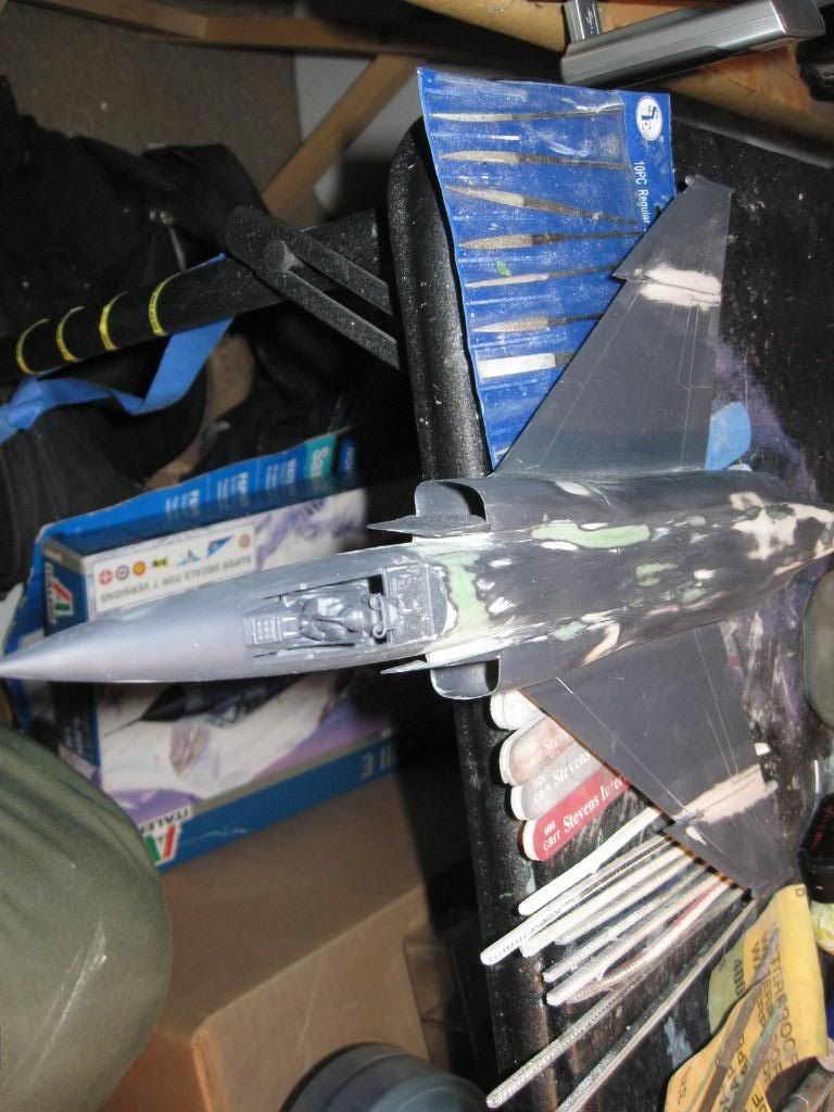

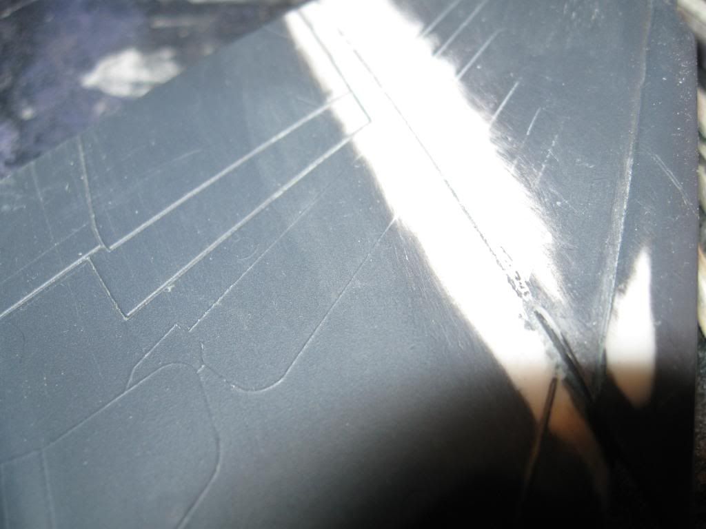

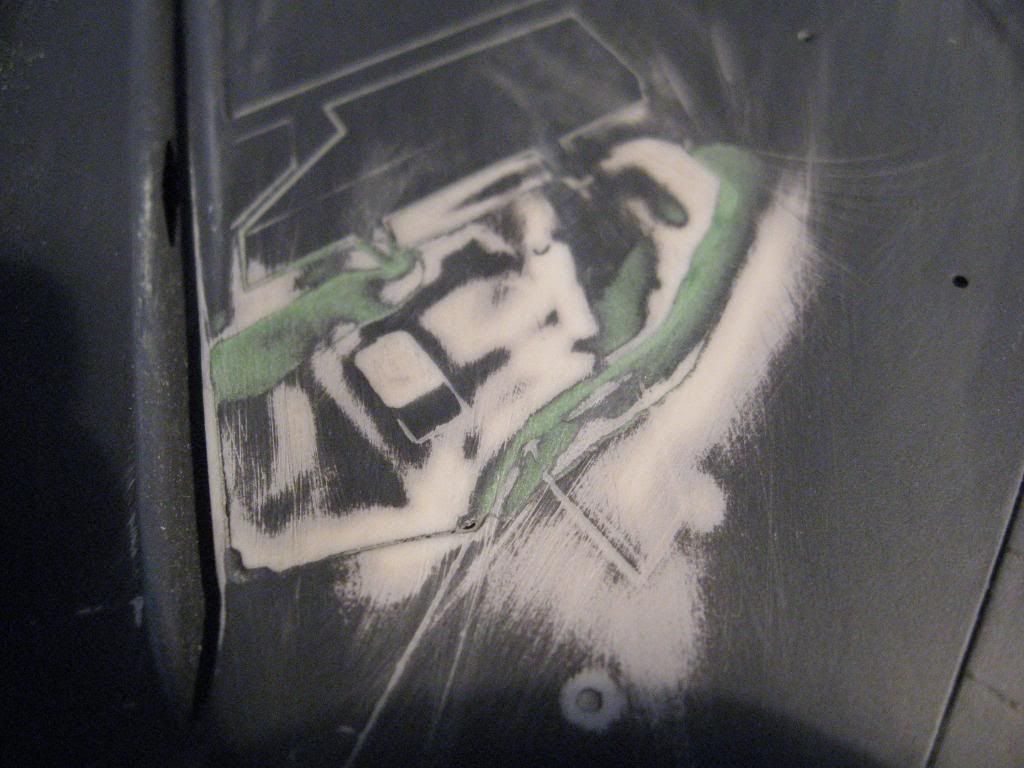

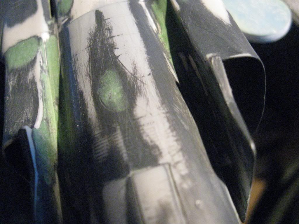

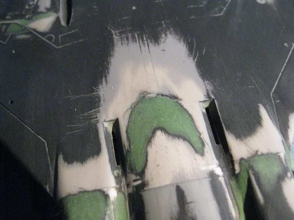

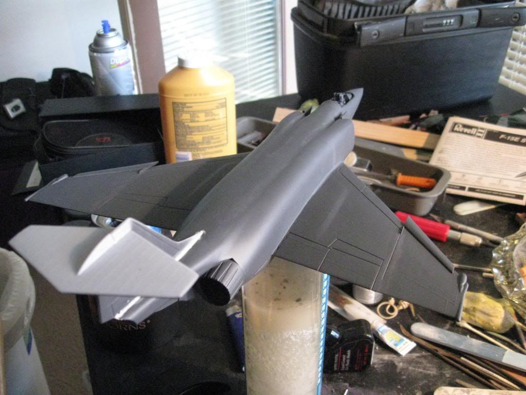

Now that you have seen the actual work here is what I use
In other words everything. Now I will repost

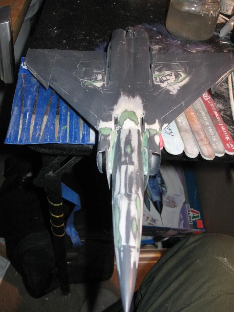

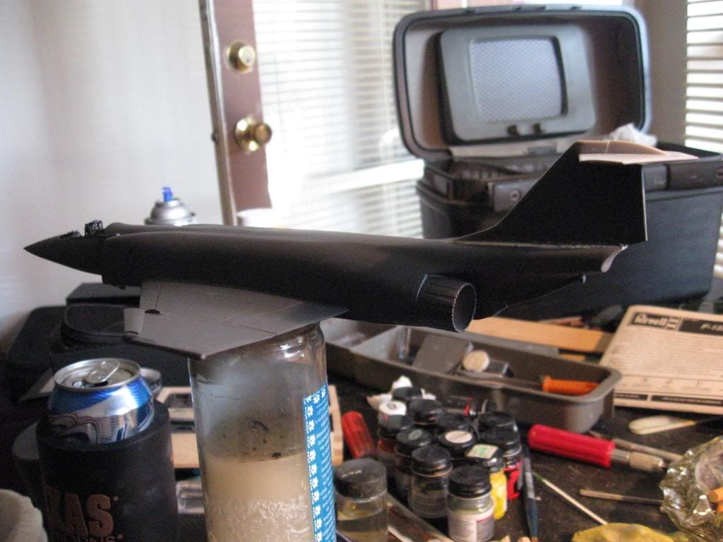

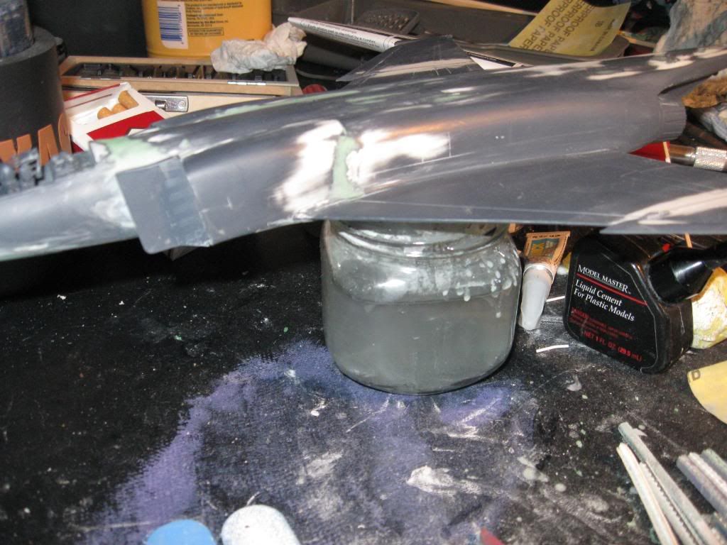

The important thing in this image is not the model it is the little pot o water under it.

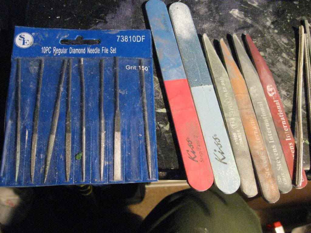

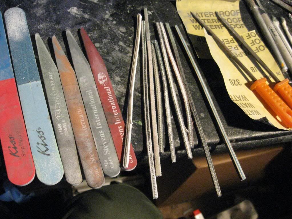

ALSO look back and see the files....all the fancy sanding sticks (which are very useful) can be replaced with sand paper(wet) backed up with various shapes  to fit various contours. I like mini and micro files wrapped with the various grits of sandpaper to get into hard to reach places. I almost never use my hands to hold the sandpaper. I generally always use some sort of properly shaped backer .If I have to I will use a dowel or a piece of wood or plastic and custom carve a shape to wrap sand paper around.

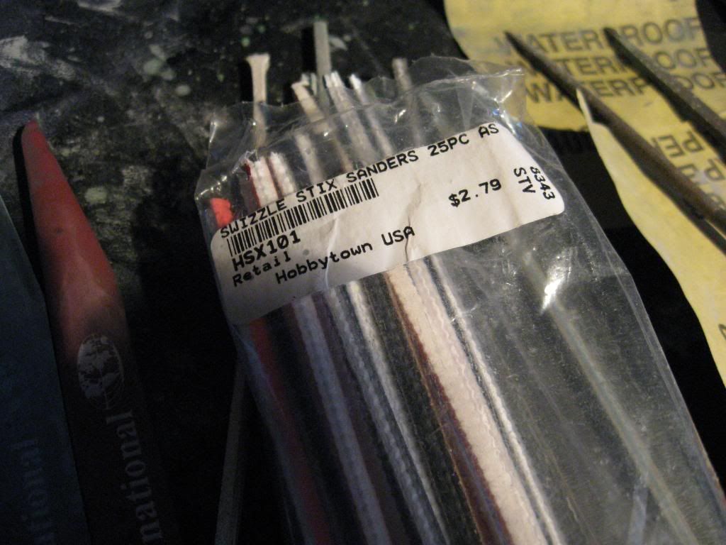

Swizzle stick sanding strips?  Never heard of those.  How do you use them?  Like jeweller's filing cords?  Do you have any riffler files (see below)?  I find those really useful for odd-ball curved crevises, etc.
And I normally wrap wet sandpaper around a used credit card (with its magnetic strip removed) to get into tight places, too.
http://www.woodzone.com/Merchant2/merchant.mvc?Screen=PROD&Product_Code=828131
Yep ,thanks for reminding me I got all those . Look here

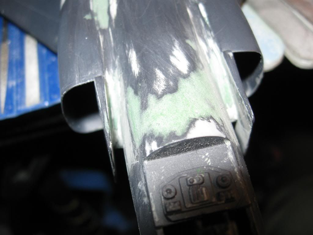

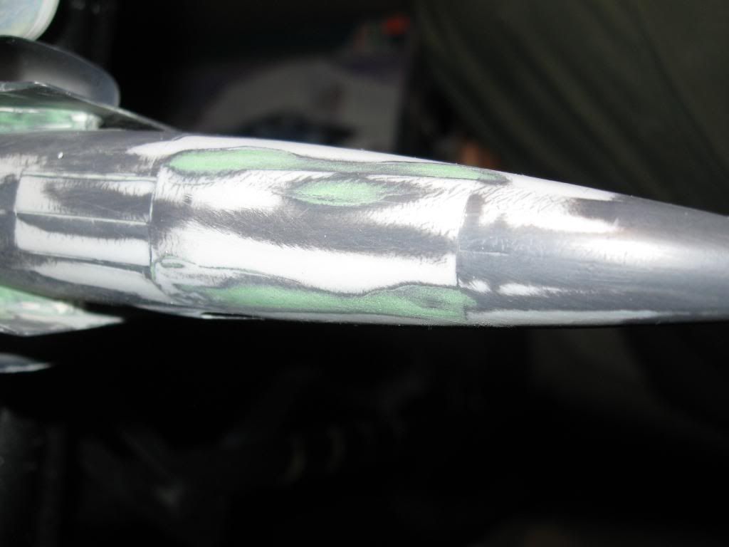

Looking rode hard and left...
Scooterman
I have to say it again.........
Your PSR is Fight, my Master :bow:
Hey she was dry when I put her away  ;D

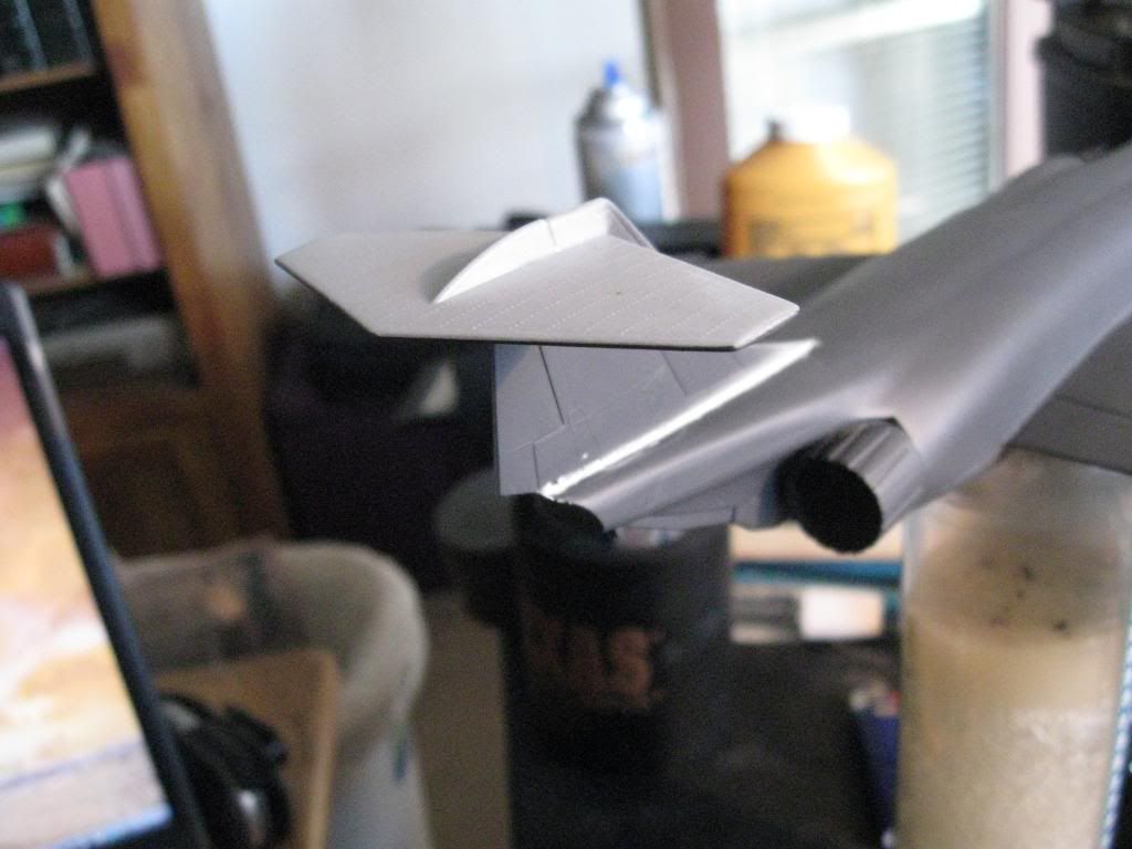

Ok she is getting close so I went ahead and permanently mounted the tail

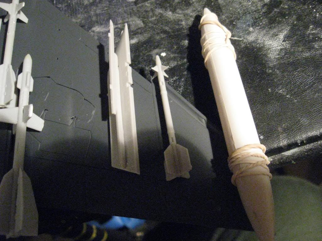

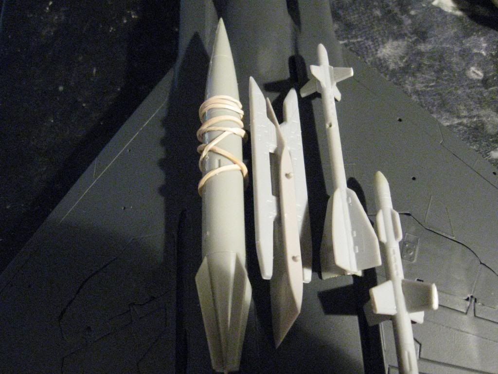

Here is more on the proposed
Load out a total of 850 gallons o gas and 12 varied AAM's
I have to go look up missile and jet fuel weights so I can figure empty and loaded specs :wacko:
