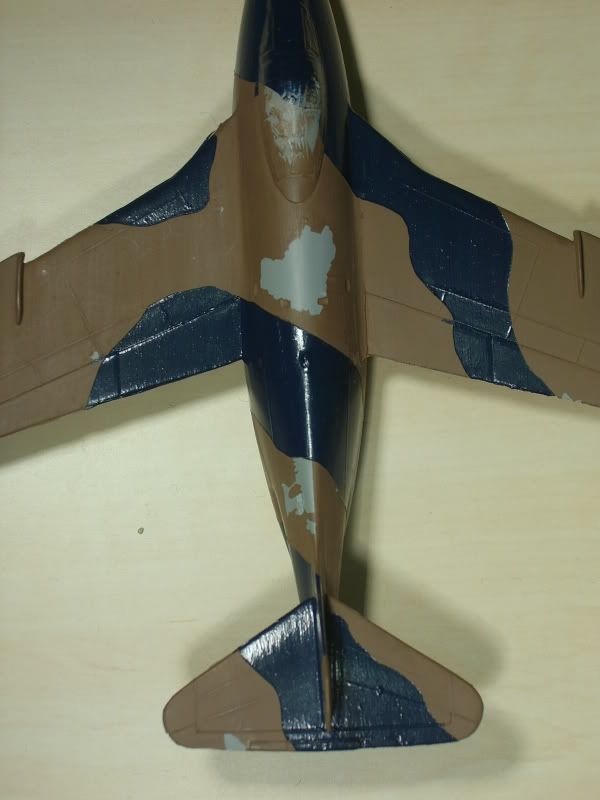

Bit of a disaster this morning.  I put the second colour on last night & removed a small amount of masking before I went to work.  The masking has taken large chunks of paint with it.  Trouble is, the brown coat was hand mixed, so I'm probably going to have to re-mask it all.  Pictures later.

Mossie I have been there an done that. Arcrylics have a hard time sticking to oil based primer if that is what you used. Regular masking tape is very hard on paint. You really need to get some painters blue masking tape. Buy 3M brand .
Thanks Ron, I'll have a look for it.  I used the bog standard white decorators masking tape.  I've had this reel a few years, & I find it can get more aggressive with time.  I deliberately de-tacked it before hand as well.  I'm finding the to acrylics quite 'challenging', they have a few problems that enamels don't have.  The only benefit for me is the improved drying time.

I've got three different sizes of Tamiya tape!  I use Tamiya tape for the edges & fill in the middle with decorators tape to save on cost as your both right, it's pricey.  Trouble was, when I took the rest off, it peeled in places where both type were used.  It's only peeled where I used it on the brown coat, the grey undersides are fine except for a tiny patch which can be quickly sorted out.  I should have thought about this & left some of the mixed brown, I knew I'd have to touch up bleed-throughs.
This leaves me with a three-pronged dilemma.  I can mask off the blue areas & repaint, but they're painted over the brown & might suffer the same fate.  Instead, I can re-mix the brown, paint over the peeled patches then attempt weathering it, something I've never done before.  Or, I can strip the lot & start again, although I've found that Humbrol Acrylics don't react well to Fairy Power Spray.  Decisions, decisions, but I'll be ditching the Humbrol Acrylics for the next project.  I'm leaning towards the weathering, it'll be the most fun to try at least!

I know photos can be deceiving but your primer looks awfully smooth, bordering on semi-gloss for "primer."
It looks like bare plastic, almost has a sheen back in your first head-on pic of the primer.  Should be a dead-dull surface, giving the
paint more "tooth" to grab onto.
Did your paint pull off leaving the primer intact or did it pull up the primer as well----looks like bare plastic where the paint is missing.

It's Halfords (Britains largeset auto store) primer & it's intact, except for a tiny bit that might be due to a light sanding I gave it.  I'm not sure if you can get Krylon or Duplicolor here, I'll check some of the smaller car shops.
Halfords is pretty much worshipped by modellers here & settles very smooth, part of it's appeal.  I've got a feeling the Humbrol Acrylic isn't bonding to it.  I've used this brand before over Halfords primer, both with Tamiya tape & blue tack & not had a problem.  The underside colour is Humbrol too (although over the earlier Tamiya coat) & that hasn't lifted.  Just one of those things I guess.
I think I will use Tamiya tape on it's own in the future, I started using the decorators tape at a time when funds were much tighter.  Saying that, the Tamiya tape lifted it too so wouldn't have helped me here.  I should really have kept back some of the mixed brown rather than rinsing it away....

With no experience with that brand and just going by the pics I would say it does look too glossy . Is it labeled as sandable?

Ron, I'm not sure if it says so on the can, but experience says it is.  It normally takes paint pretty well.  One possibility is that I got my greasy mitts on it, although I usually wash my hands before handling a model.  Just before masking I'd washed some very greasy pots, that's quite probably the problem, at least it's the only one I can think of.
