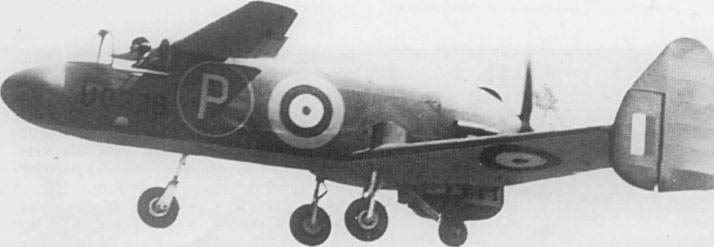

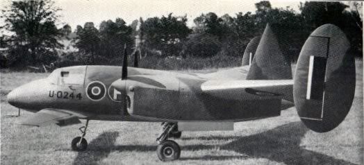

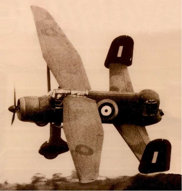

I've heard that said before about the P-12!  Yes, it's a Lysander with turret in the tail which is very similar to one from an Avro Lancaster.  The idea was for an aircraft that could strafe enemy troops as they landed on the beaches.  It started with a Lysander with a conventional turret in the fuselage, but the arc was restricted.  Then the 'Pregnant Perch', a Lysander with a gunner in the belly, again the arc was restricted.  The P-12 was more radical & had an entirely new rear which allowed a much greater arc of fire to allow the turret to be used both in strafing & self defence.  As the threat of invasion dissapeared, so did the need for the P-12.
