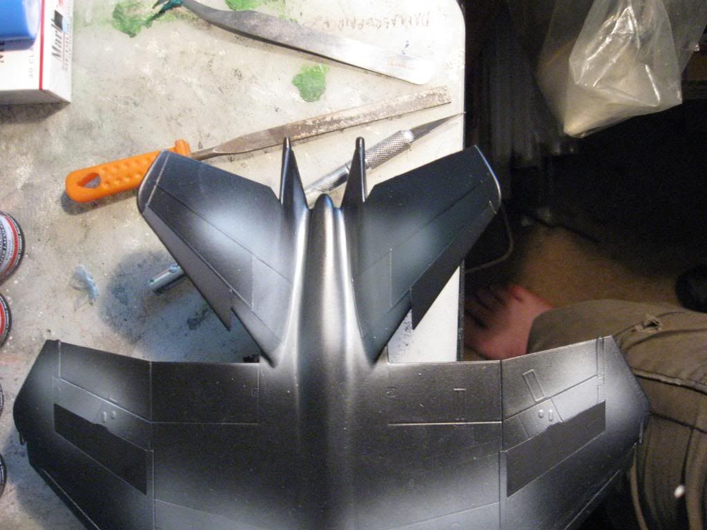

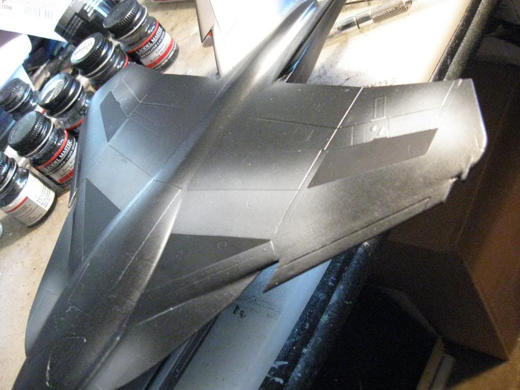

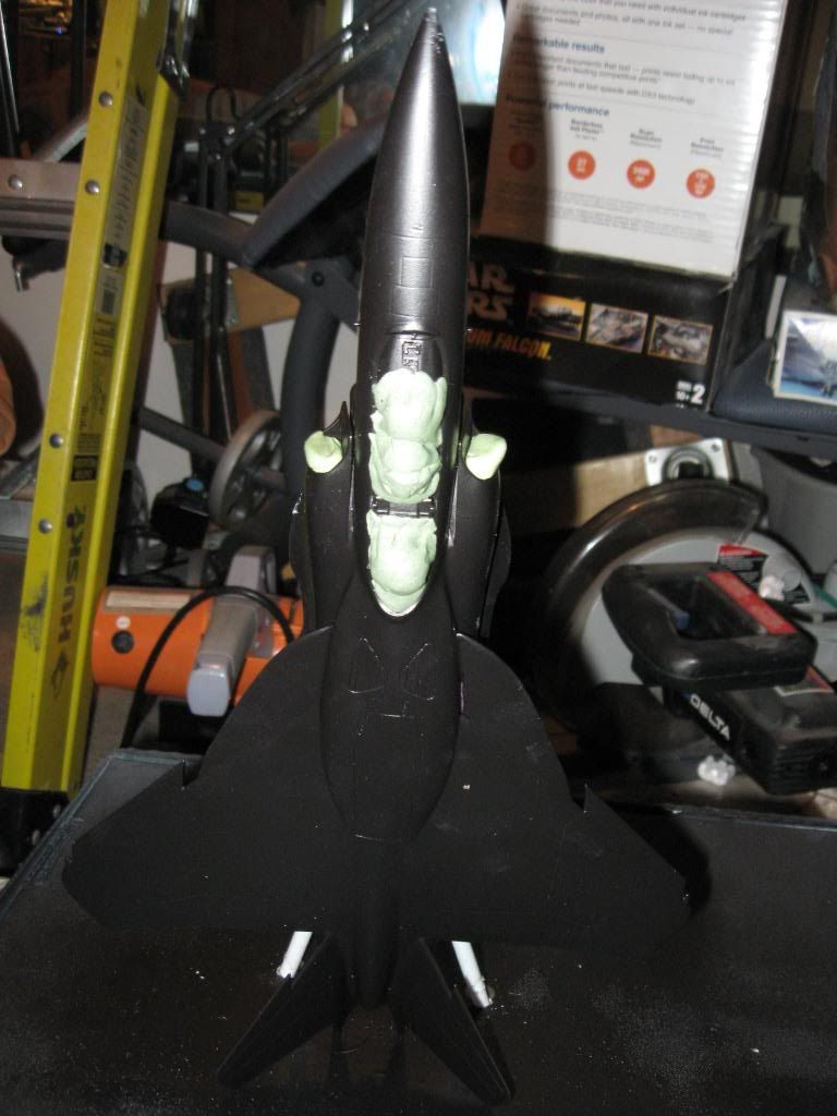

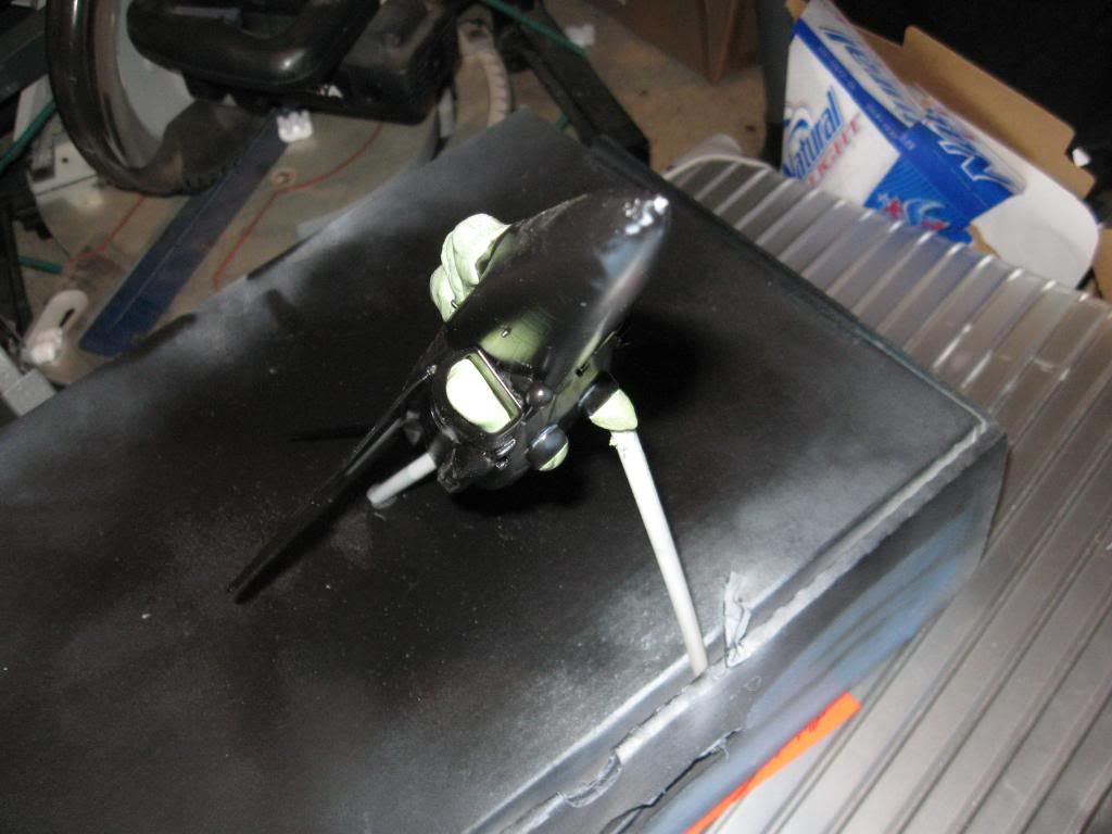

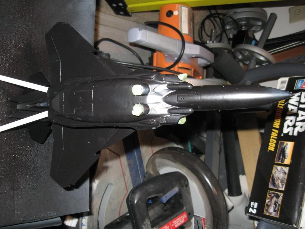

I am back home and have gotten back to work on this one. I plan on having it look like a dark ,mettallic , patchwork with all the separate panes painted in these colors

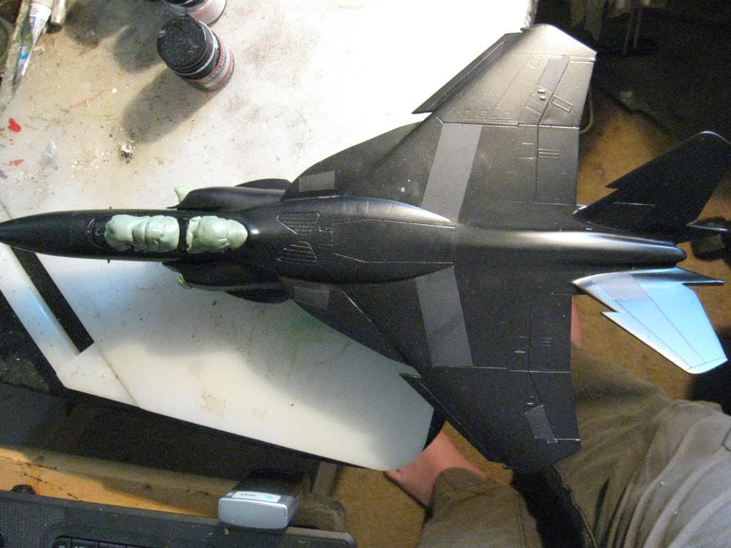

The only way I could figure out how to do it precisely was to coat the entire AC in liquid masking
I will cut out and peel each panel I want a separate color ,paint then respray masking.
Thats what she looks like with a couple coats o mask dried over night.
On to painting :wacko:

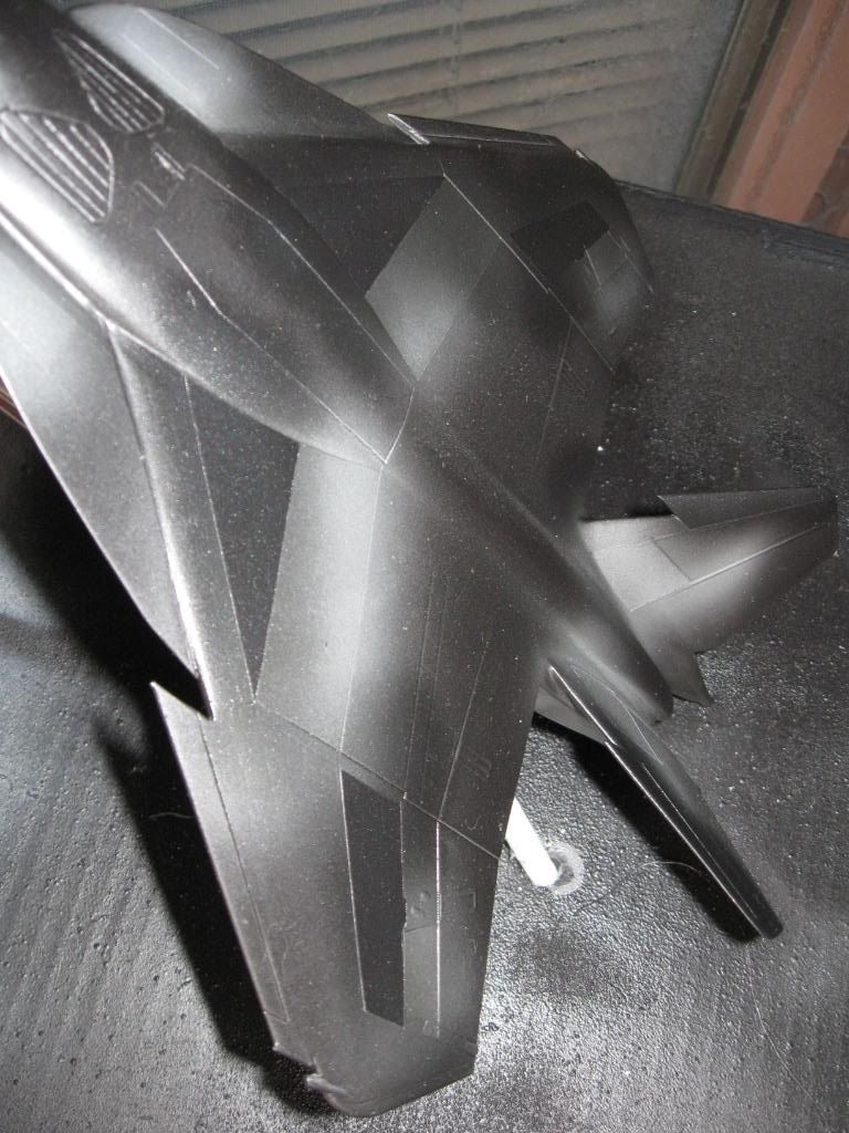

1st panels peeled
Color shot

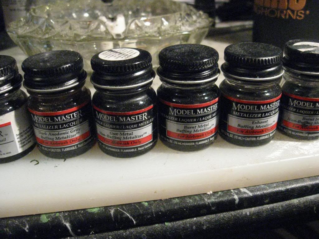

Dark anodonic gray
Peeled for the next color
Painted with graphite mettallic
ElectrikBlue

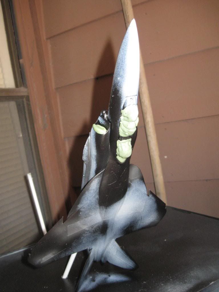

Yeah me too :blink: ;D. Actually the liquid mask is really working out well. The most excellent Cthulhu gave me a car detailing spraygun that is super for doing large areas :thumbsup: :party: :wub:
Liquid mask---cut---spray---re-apply liquid mask---cut next section---spray.....
