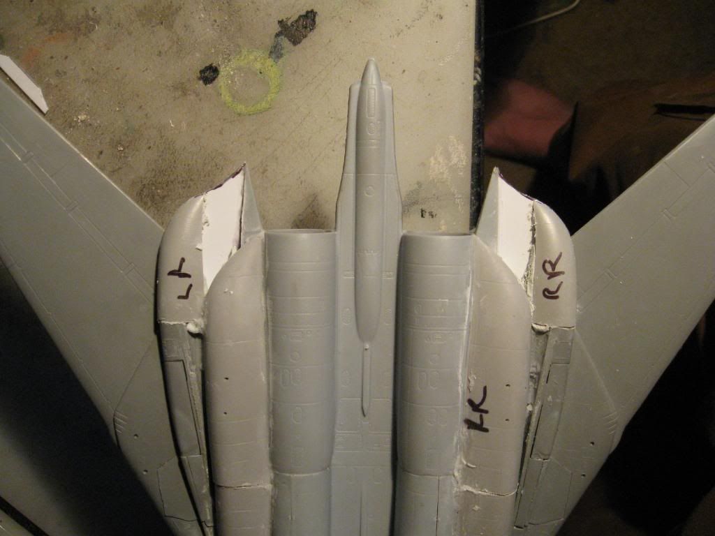

Yes I did .I cut the front portions off both sets and used them. Actually I scaleorama'd the tanks from a 1/72 for the landing gear fairings :wacko:

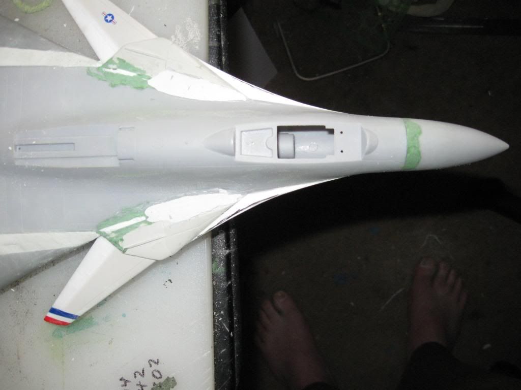

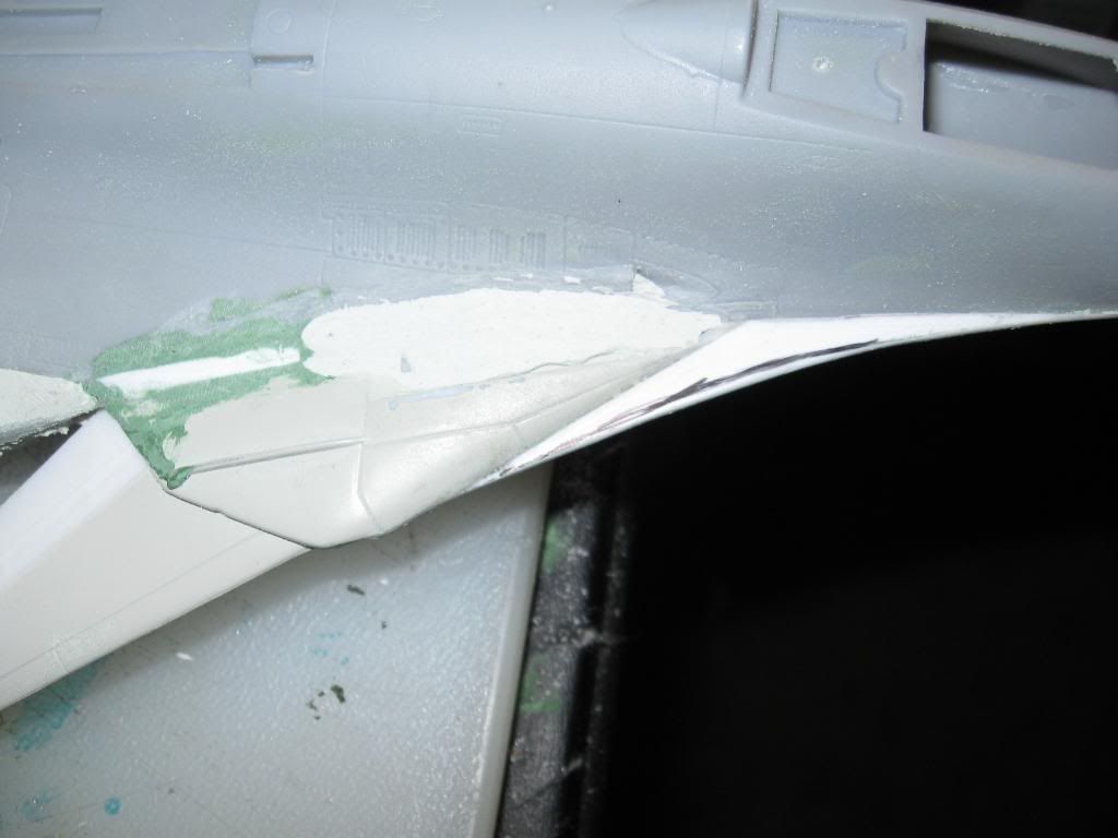

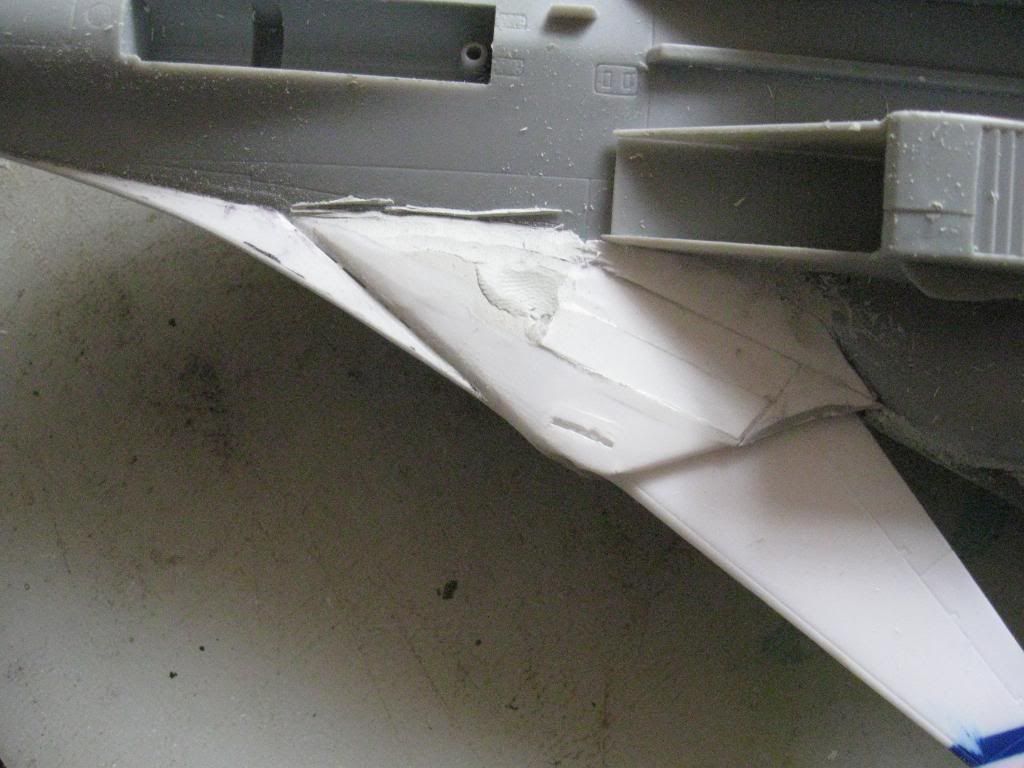

I did some blendification
The forward wing gloves will blend into the fuselage like the original wings did

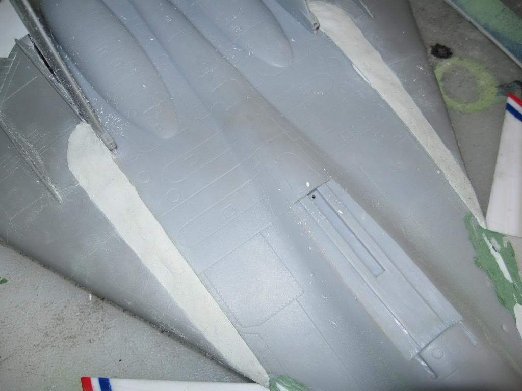

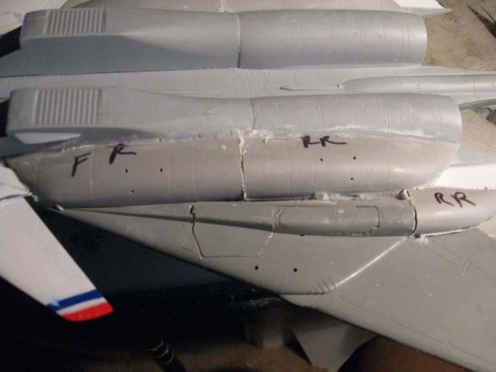

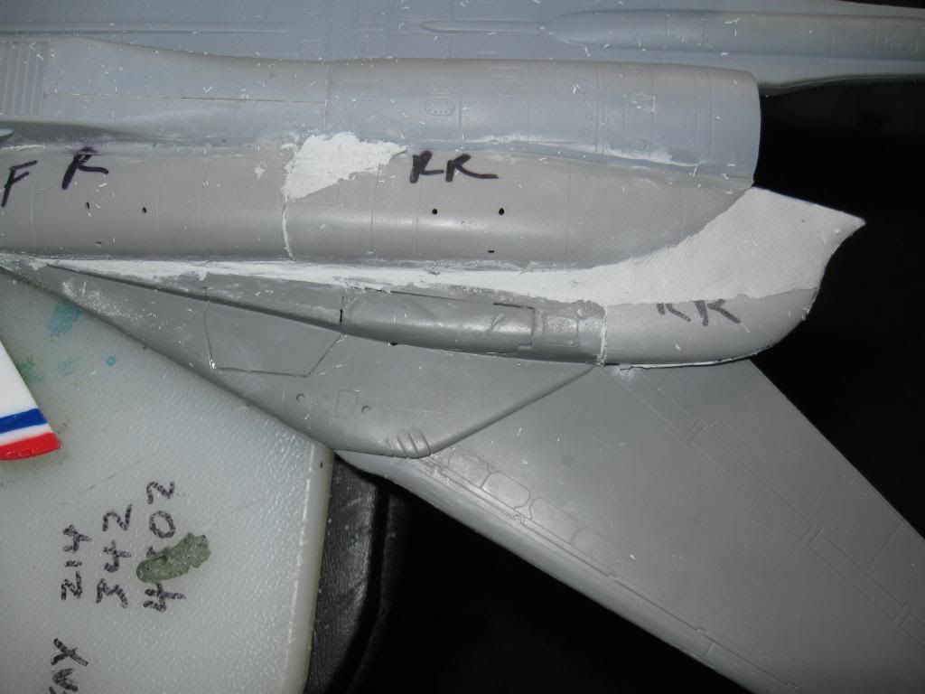

I also scratched up the lowers on the wing gloves to blend back into the tanks
Here you can see the two tank halves made into one tank

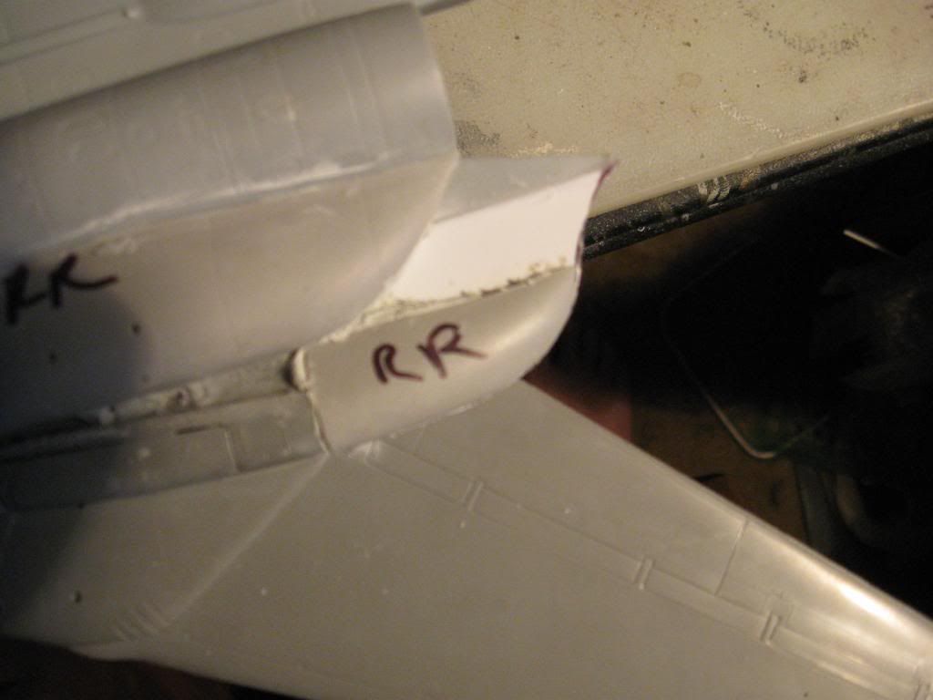

Here I used the front of a 1/72 tank to fair the landing gear in

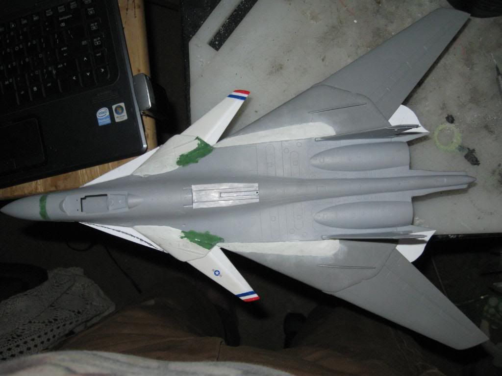

Now more putty :o :blink: :rolleyes:
Saur ,I knew the job was dangerous when I took it. I have no doubt about the amount of putty this beast will require. I have already used 2 complete sticks :banghead:
When I blend in disparate parts I always try to scavenge parts from other stuff so as to avoid scratch building. In other words.....cheat :wacko: :lol: :rolleyes:

Tons ;D I have already used 2 sticks of plumbers putty to solve the unsuitable joint situation :wacko:. The Aquamend stuff I have mentioned before is really good stickum in thick enough applications. It is the only thing holding the wing gloves and wings onto the Flanker fuse except for liberal application of gap filling super glue Gel .

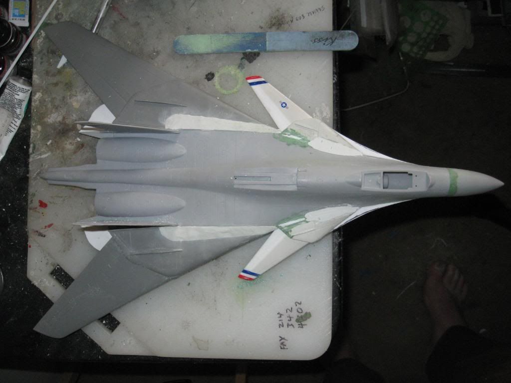

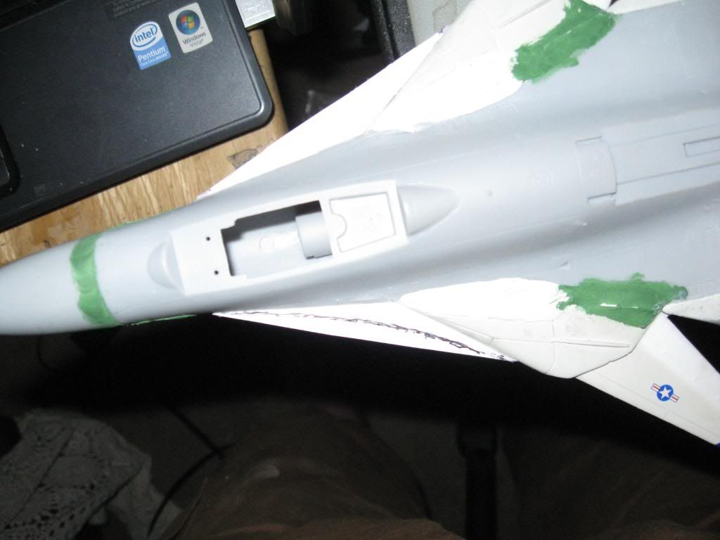

Thanks Blue ;D More curvy smoothifying

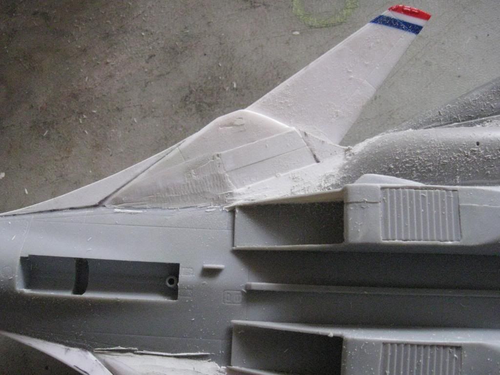

I did the curves on the LERX with a BELT SANDER ( I ain't skairt) :rolleyes:
I also rough cut the structural putty at the joints with a big burr in a Dremel so I could get down to some Serious putty work

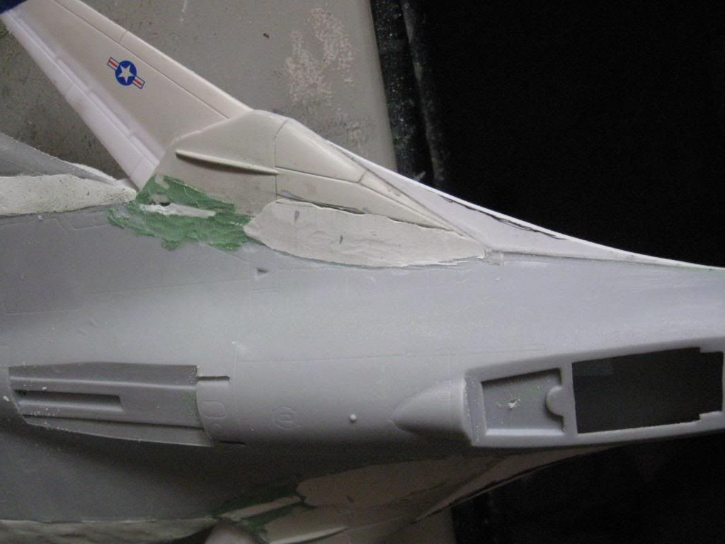

Blended the top of the wing gloves
And the tanks into the gloves on the bottom

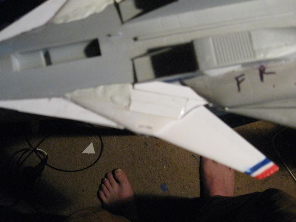

As well as rough cuts on the canards
