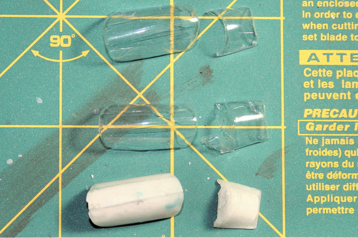

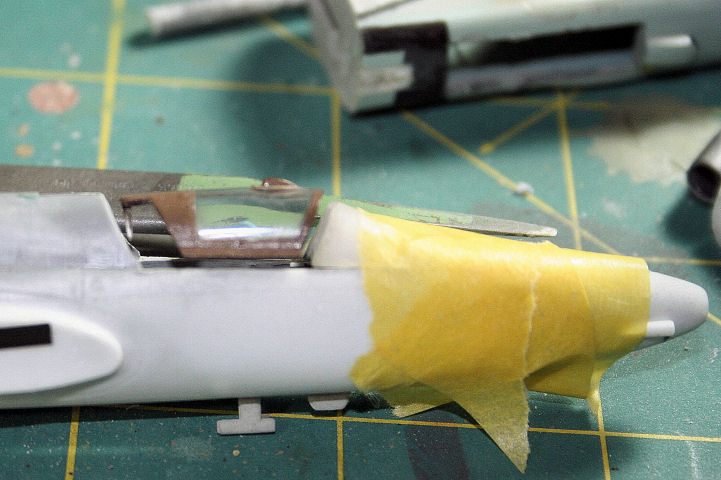

This time, I added some small scraps of styrene to the edges of the fuselage and just trimmed the bits to match the curve of the single seat canopy. It was relatively easy. In the process, I fixed the windscreen edge, which also had a curvature problem. Next, I taped together the fuselage and noticed that the windscreen had a height issue. The bigger problem was that the single seat canopy wasn't wide enough for the fuselage. It also wasn't very clear. So I split the canopy in half, glued it back together only slightly narrower than the fuselage, glued on the windscreen and filled both with acrylic spackle.
When that hardened, I tried to make a copy with my Mattel vac-u-form, but I wasn't getting good results. So, as a last resort, I put the canopy on a small length of styrene, held it in a vise and used an alcohol burner to soften some clear buterate. Using the "heat and smash" method, I was able to make several good copies of the canopy and windscreen:
Cool. But now I had a crystal clear view into the cockpit...and I was on the slippery slope of adding  yet more details.

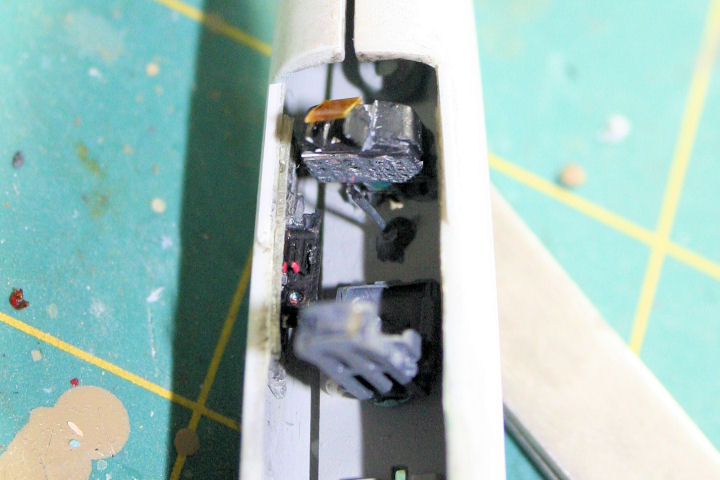

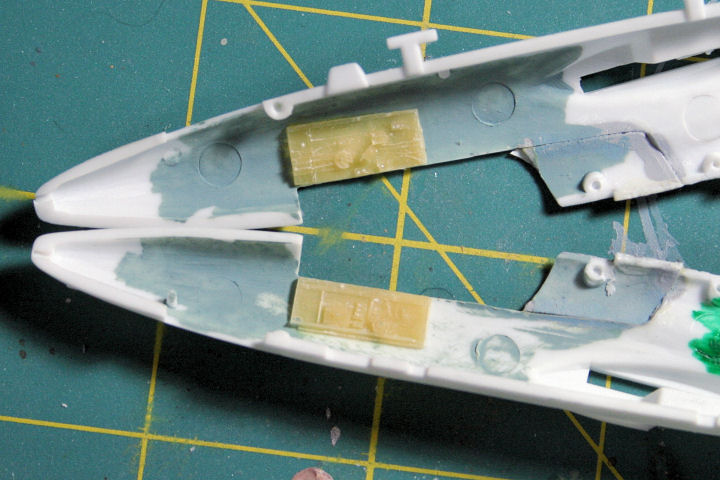

Going through my stash, I found some nice, generic resin cockpit sidewalls. I thinned the backs down and glued them to the cockpit:
Now is when the madness begins...
The kit's instrument panel is a decal, and it's so badly out of register that the black circles for the instruments are fully half way outside the white circles that represent the back of the instruments. I also thought that the kit's ejection seat was a bit anemic, so I tried a resin K-36 seat. That was just a little too wide for the cockpit, so I tried a T-33 Martin Baker MB-5 seat that fit nicely.

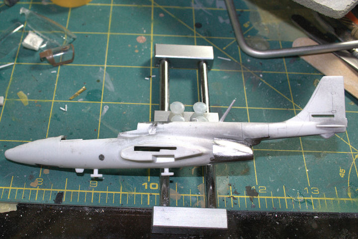

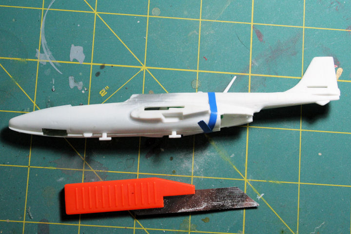

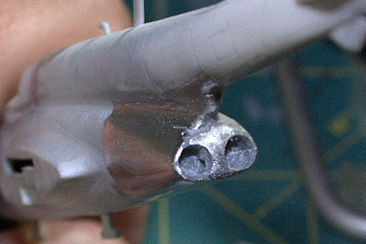

So out came my trusty micro saw and I cut away the engine exhaust section:
I replaced the single engine with an engine pod from a Dragon 1/200 B-52. This is still wider than the fuselage, but it just means more PSR to blend the pod into the fuselage. I'll also have to increase the size of the intakes, but the kit's intakes aren't very good, so no loss there.

But wait, there's more nuttiness. While looking for the resin seats, I found my old Hasegawa 1/72 Mig-27. It had been badly damaged in a fall and was in the parts donor box. Just for grins, I tried the canopy on the Iskra, and while it's not as deep, it is wide enough, and it looks good, to boot:
So I used the micro saw to cut out the fuselage area behind the canopy on the Mig-27 and with some extra styrene strips, I was able to make it match the windscreen. I'm not sure if I'm going with this canopy or the one I made. The advantage of the Hasegawa canopy is that it can be posed open or closed.

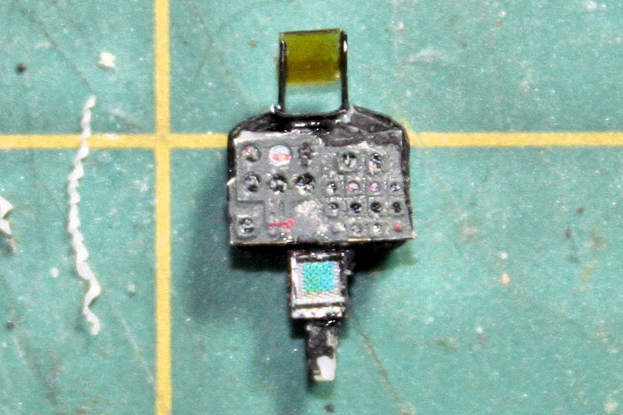

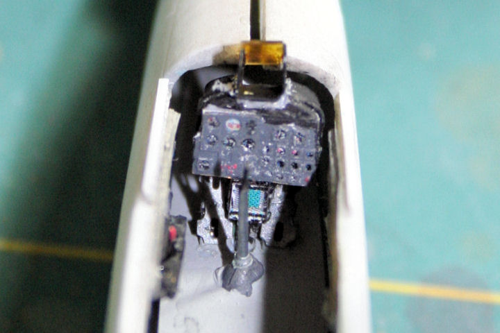

Some progress this week, mostly in the cockpit. I spent a ridiculous amount of time on the instrument panel. The kit panel was out because of the bad decals and I had a PE instrument panel from an old Airwaves ME-262 PE set (which has been a "parts donor" for about 5 builds - not one an Me-262). The Me-262 looked small, so I tried printing my own, but my printer tended to pixelate everything. So instead, I scanned in the Me-262 instrument panel, then copy and pasted real Iskara and other aircraft instruments into place behind the Me-262 instrument panel holes. I also drew a simple flat panel display and traced the HUD support from an F-117 PE set onto thin plastic and cut it out. Here's the result:
I still need to do some dry brushing and add some HUD buttons. It looks better in real life than in this roughly x10 blowup.

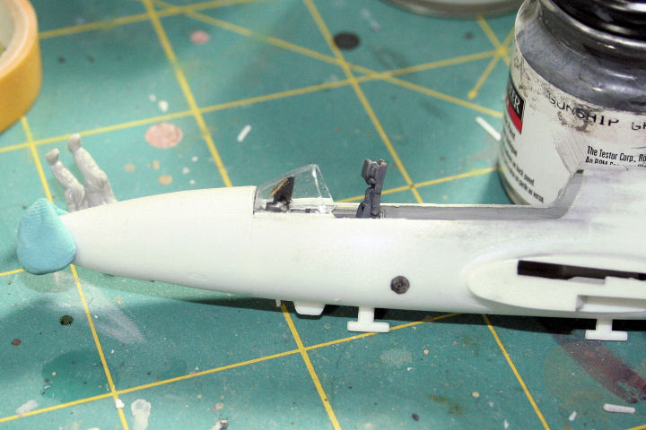

Just in case the HUD was too tall for the windscreen, I mocked everything up. It looks like it'll fit:
The ejection seat is from a T-33. It looks higher than it'll eventually be because it's resting on a blob of Blu-tac.
Here's a view of the cockpit - nothing is glued in place. The control stick is a thin piece of round rod, with a PE bit from the Me-262 set at the top, for the trigger and handle (too blurry to see in the photo). The rudder pedals are also from the Me-262.
The two throttles (again, modified from the Me 262 PE set) are easier to see here:
I'll take the instrument panel and ejection seat out - they'll go back in at the end. Next, I'll add weights to the nose and hopefully close up the fuselage so that I can work on the engines, There's going to be a lot of PSR back there.

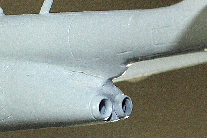

The PSR on the new engines went surprisingly well:
The shiny paint is from a Gundam chrome marker. Not only does it provide a mirror-like finish, it's very handy for a quick check of areas that might need more filing or putting. It's a lot faster than getting the airbrush ready.
The reflection from the flash makes the transition from the fuselage to the engines less smooth than it really is, although I may have to do some PSR to the very end of the engines to match the curve of the lower fuselage. About half of the material under the marker is cyanoacrylate + talc. It sands beautifully, since it's about as soft as the surrounding plastic.
The jet exhausts need some work. What's interesting is that the even though the new engines + CA putty have only been sanded down to 400 grit, it's already smootherthan the kit plastic, which has an odd, grainy finish to it. I may just fix some blemishes with Mr. Dissolved putty and move along to priming the fuselage.

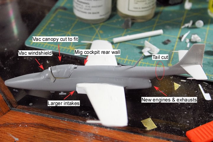

Here's an annotated picture with what I've done so far:
I decided to cut one of the vac canopies I made to match the Mig-23/-27 canopy that I was going to use. I then masked off both the windshield and canopy and shot everything with some Mr. Surfacer 1000. I did some PSR on the windshield to fuselage joint; the bumpy area is tape covering the clear parts. You can't see the transition between fuselage and vac windshield anymore. The canopy doesn't quite fit without coaxing, but I'll probably pose it open, anyway. It's raised in this picture because it's resting on Tamiya tape.
Here's a detail of the engine exhausts:
The Wave parts look good, I think. I'll add the shock cones from the original B-52 engines when I'm done.
I still need to do a lot of PSR - remove the plastic that's oozed out from the wing root connection, fix some divots and other issues in the engine section, clean up the landing gear area and the new intakes, shoot some primer on all the white areas and fix any problems that crop up after that.
Then finish the landing gear and add the doors.
