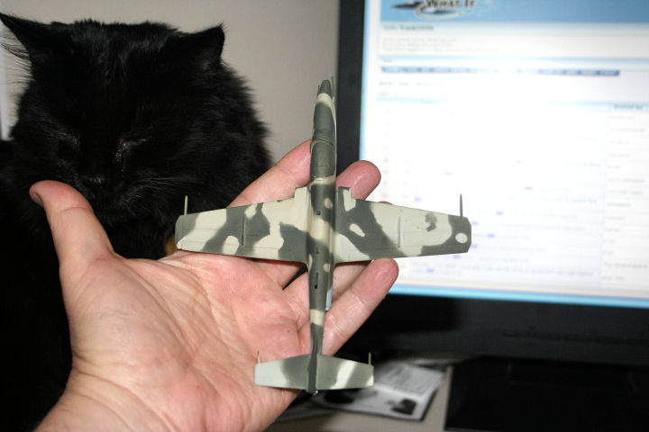

Luckily, Windex takes Tamiya acrylic off easily. Since the upper surface had been painted in overall IJN Gray, the Windex took it off andthe Testors Acryl on top. Which was fine with me - the lower surface was painted with Acryl RLM 65 and was unharmed. I sprayed some extra RLM 65 to extend it up the sides a bit, then sprayed Testors Acryl Marine armor sand as the base coat, used some blue tack to make a pattern and sprayed some Polyscale RLM 82 dark green on top. Acryl and Pollyscale are both made by Testors and are closely related paints - both are excellent acrylics.
Here's the result of the first pass, with Espresso, my modeling and computer assistant:
I still need to fix some "issues" (like the green screwup on the starboard leading edge) but overall, I'm pleased with the result.
It's looking good!
Does everybody on here own a cat?  :blink:
[/quote]
NO!

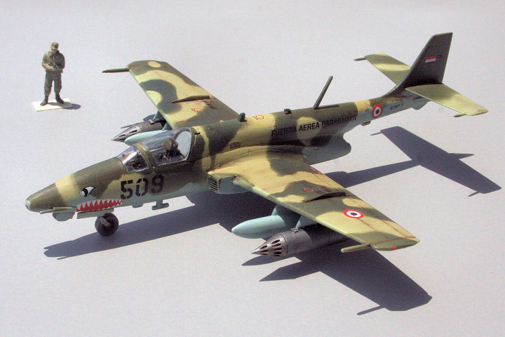

I finally finished this plane! It was almost non-stop grief - besides the well documented problems with the kit bits, paint somehow seeped under the many layers of tape and Future over the tape onto the canopy on both sides, so I had to use a microbrush and denatured alcohol to remove the paint "dust" and tape residue. I then spread some Future to hide some of the worst bits. I also managed to destroy one of the decals, and had to replace it. When I was done - and was showing my wife the plane - I dropped it and managed to break off one probe (which I glued back on) but also bent the antenna and another probe that I didn't notice until after I took the pictures. Then as I was photographing the model on the balcony, a gust of wind (on an otherwise calm day...) almost made the plane fly off. It's done and secure now, so...

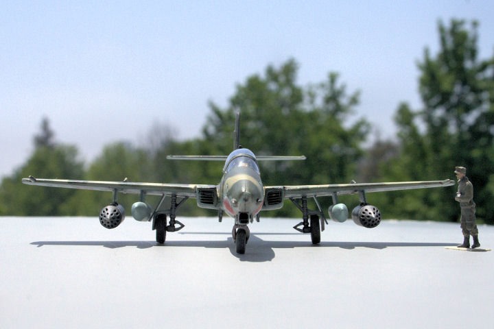

Front view. Wider main and nose wheels, FLIR and FOD screen made from 1/350 scale ship railing. The engine intakes are also larger than the "stock" Iskra:

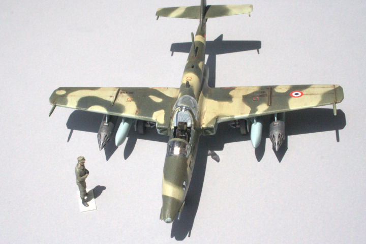

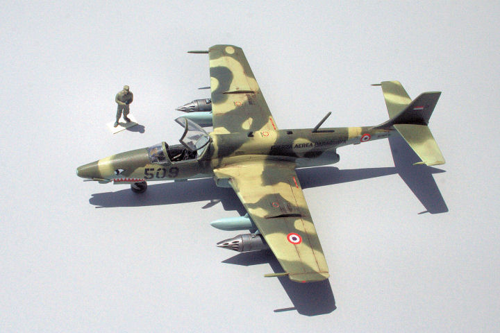

A view with the canopy opened. The HUD is the bright spot in the front canopy. The ejection seat is a modified T-33/F-80 seat:

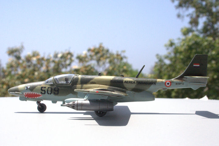

Side view. "509" is the aircraft number, but also the month/year I finished this model. Most of the decals (roundels, shark mouth, tail flash and "Fuerza Aerea Paraguaya") are home made, with stenciling from a Hasegawa P-38 sheet:

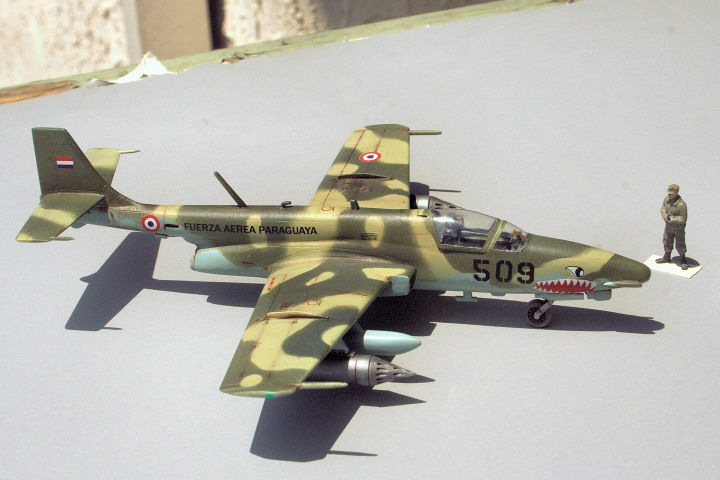

A starboard view, with the "Fuerza Aerea Paraguaya" visible (and peeling paint on the balcony railing):

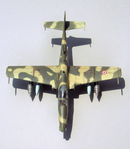

Two more views:

Ed S
Nicely done Frank.  It makes a very plausible and believable alternative CAS fighter.  Having build one of those kits myself, I can appreciate what you did with this one.   :thumbsup: :thumbsup:
Ed
Vulcan7
Thats a real beauty Frank  :thumbsup: :tornado: ace build!
Absolutely Top-Shelf Frank! The paintwork is excellent! This one would turn heads and win the prize at any show!
and the paint job looks just like the avocado I just ate!

Hi Frank - very nice job!  :thumbsup: :thumbsup: :thumbsup: The engine conversion's so neat that I keep forgetting it's got two now.

Sisko
Very nice build!
The camo job is top notch!
Get this Cheese to sick bay!
Cobra
2 Words:ULTRA SWEET :thumbsup: :thumbsup: :cheers: This is So Cool, Make me a Bit Jealous!!!!! Keep up the Great Work!!!! :cheers:
Nick
Very Good! Looks like a smaller Su-25 and absolutely right for the role.
