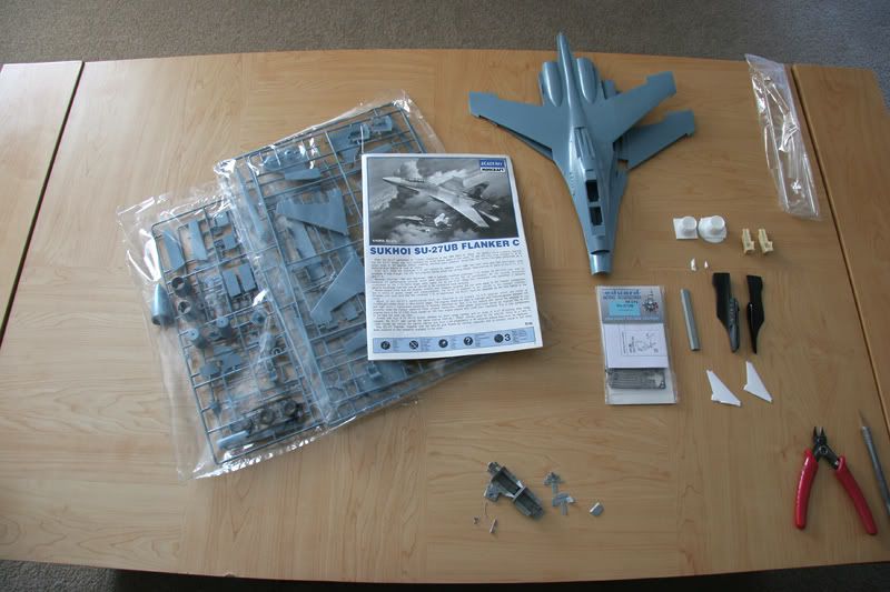

Well with my IAF A-10I done and two polls on what my next project was going to be, the USN Su-27UB was the clear winner. So today I started on my next FAR conversion.
On my IAF A-10I, I really don't do much to the cockpit just a resin seat. I want to do a custom or some type of updated cockpit for my USN Flanker. I thought about scratchbuilding it, take a try at making my own PE, but the cheapest way(cause I'm cheap) and because I get three of them in my stash, is to use Revell F-15E cockpit. It's a modern cockpit and it has some great detail. And since all the USN Flankers are license built by Boeing.....  :rolleyes:

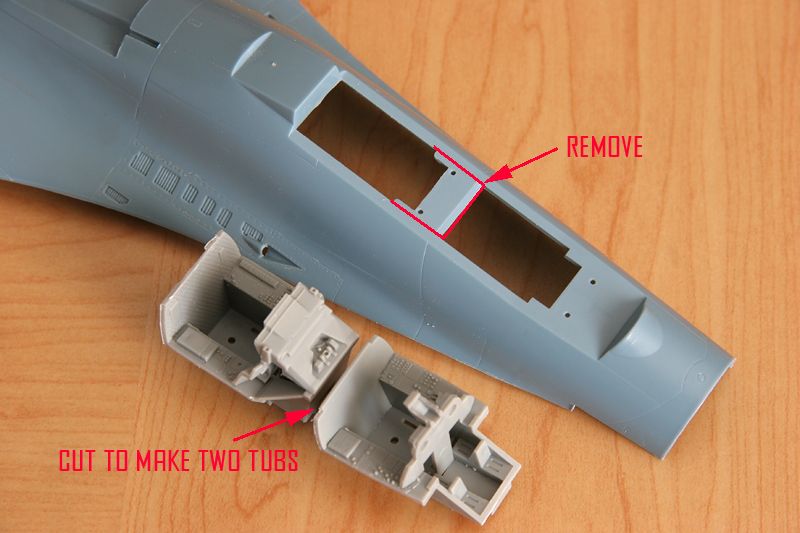

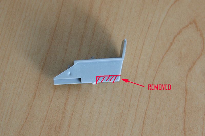

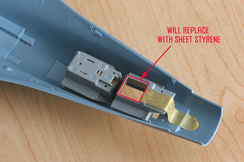

Amazingly, you can fit a Revell F-15E cockpit into an Academy Su-27UB fuselage. First, I cut off that plate on the bottom of the front seat and back behind the second seat as well.

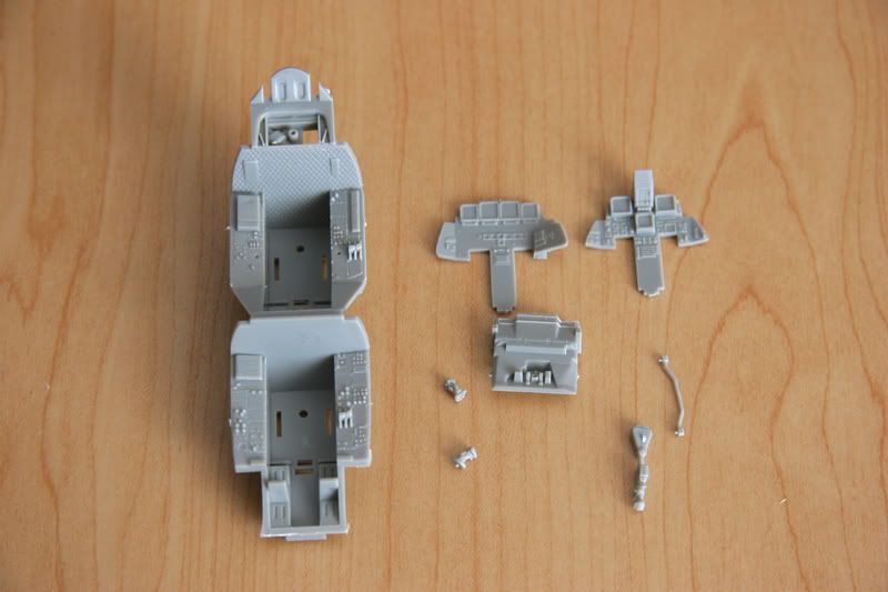

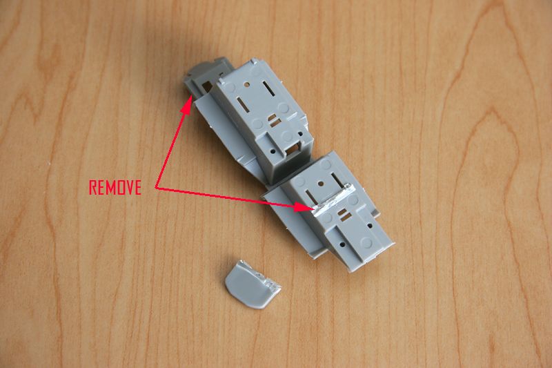

Then I had to cut the cockpit tub into two. And I had to remove the center part of the cockpit opening.

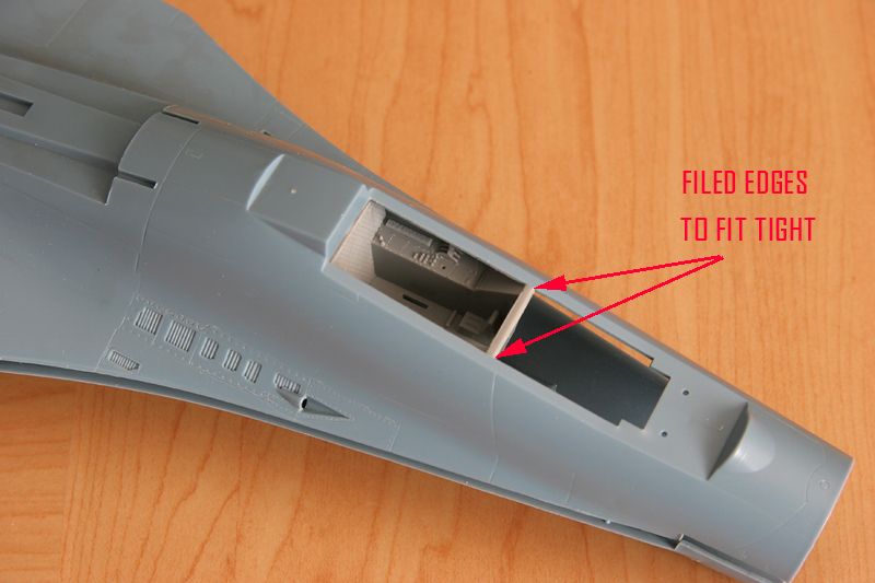

To get the rear tub to fit, I had to file the front of the tub so that it would fit tight.

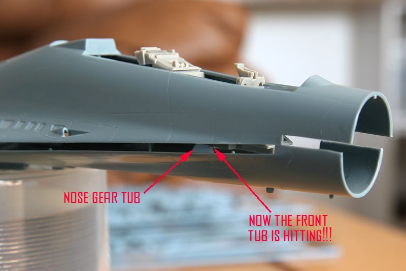

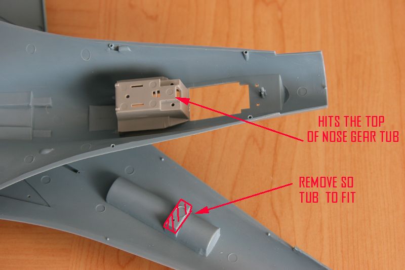

Also had to remove a part of the nose gear tub so that the rear tub would fit.
After removing a part of the nose gear tub so that the rear tub to fit, I went to fit the front tub in place and ..... It hits the nose gear tub too!  :angry:  So with my razor saw I removed the floor of the front tub and it will be replaced with sheet styrene.

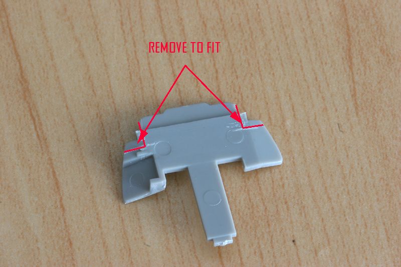

The front instrument panel fit like a glove as if was made for the kit.
On the rear, I had to trim a little bit off.

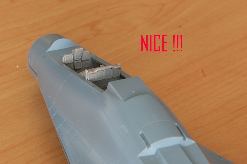

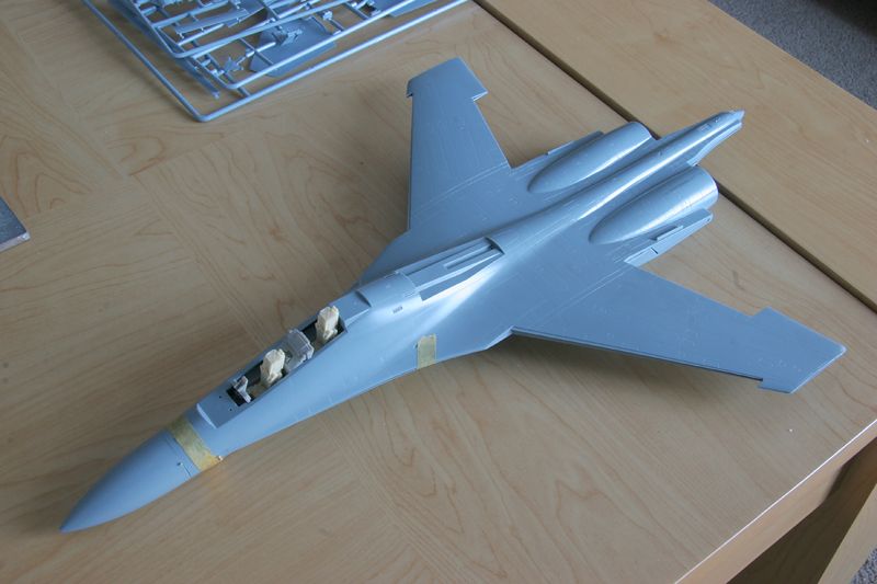

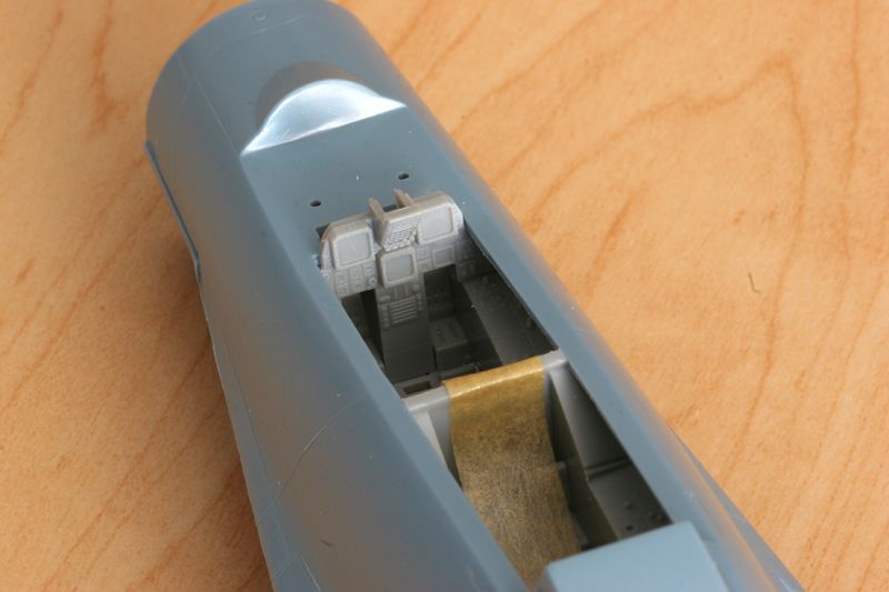

All mocked up! Nice
Add some Avionix resin NACES F-14D seats, not a bad start.
