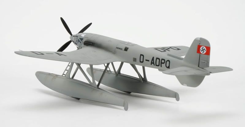

It all starts with this innocent looking He-119, the V-5 variant with the big fat floats...neat...
and an idea that it would look good as a rather differnt kettle of fish shaped things...
so it was gathered together with some random bits and pieces...

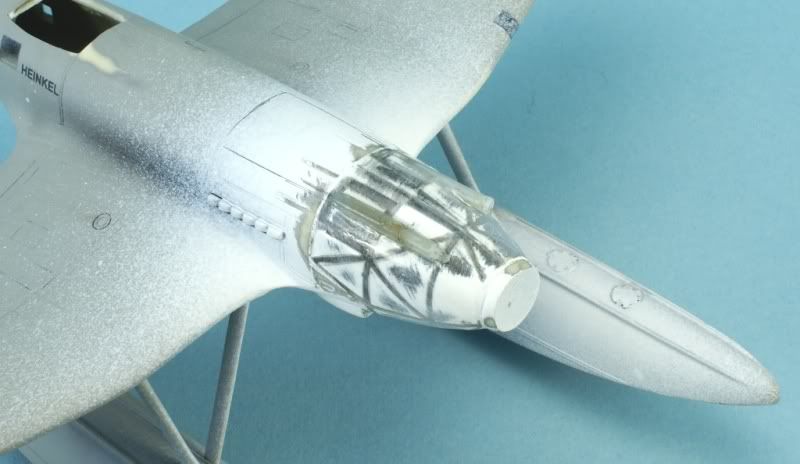

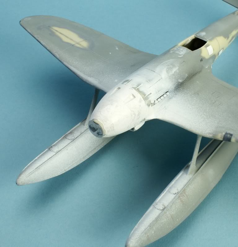

the nose section was given a spray of Halfords finest White plastic primer and rubbed down...I knew that this was going to be a real problem because this area on the kit is just vac-form canopy...
and a problem it was too...I tried to drill out the top decking and put a couple of plastic tubes in there so that I could slice them off and make gun-troughs...but the vac-form just isn't strong enough and it all turned to crud...fuksocks!...:(

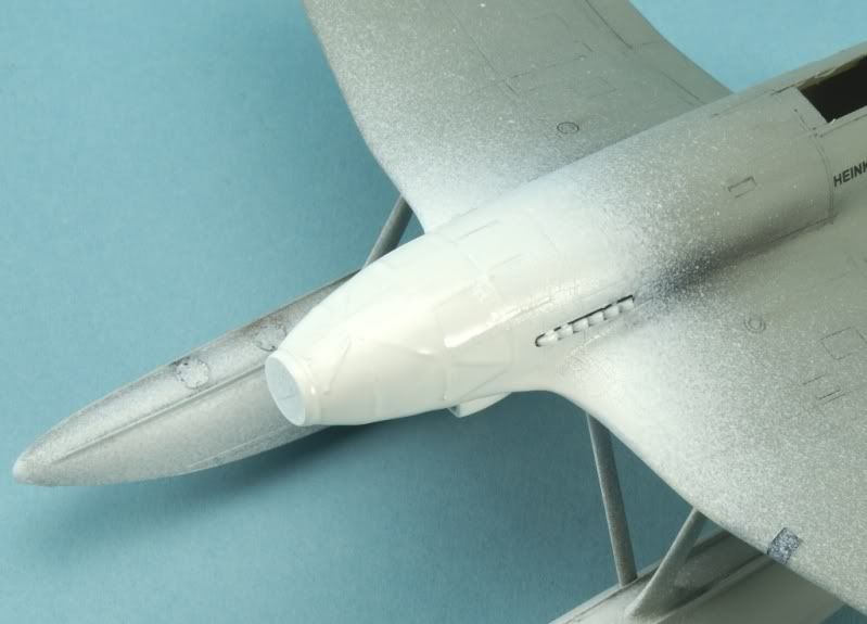

so I had to make a new nose section entirely out of Milliput, gun bit's moulded in, of course...
and that will have to do for today cos I have to wait for that to set and be all hard for the following sanding and scribing/drilling of details...

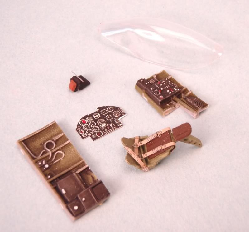

but at least it gave me a chance to work on the cockpit bits...

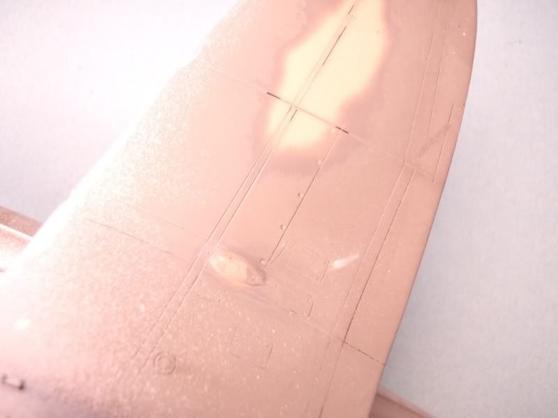

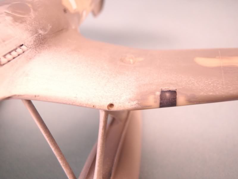

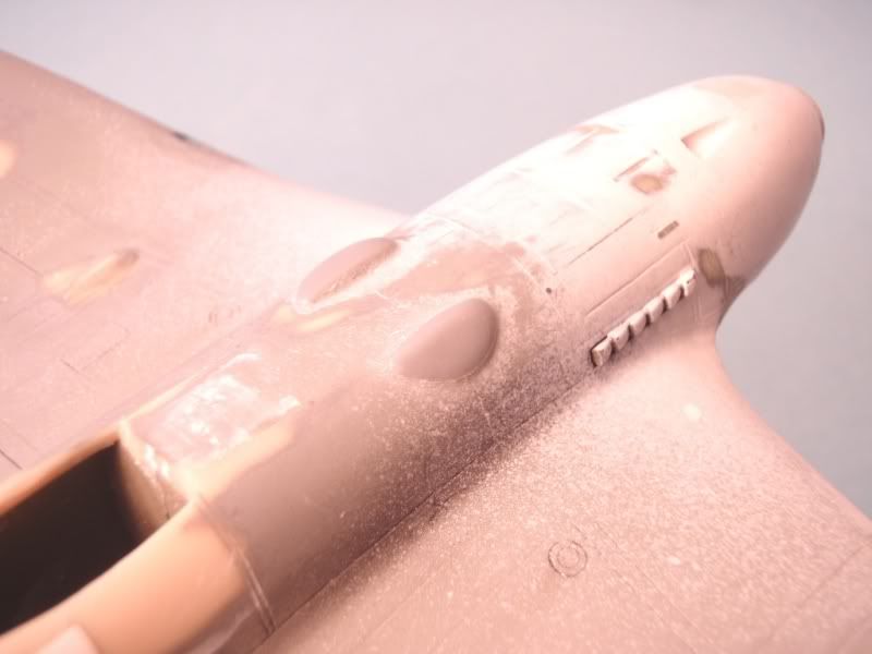

While the nose is hardening I've been working on the wings, so we get a bulge in the upper surface for the machine gun breech...
and the leading edge gets a counterbored hole for the gun barrel to be fitted into a little bit later
I also did some breech bulges on the nose decking, so it's looking a little less smoooth than the original...now with added lumpy bits...yum!

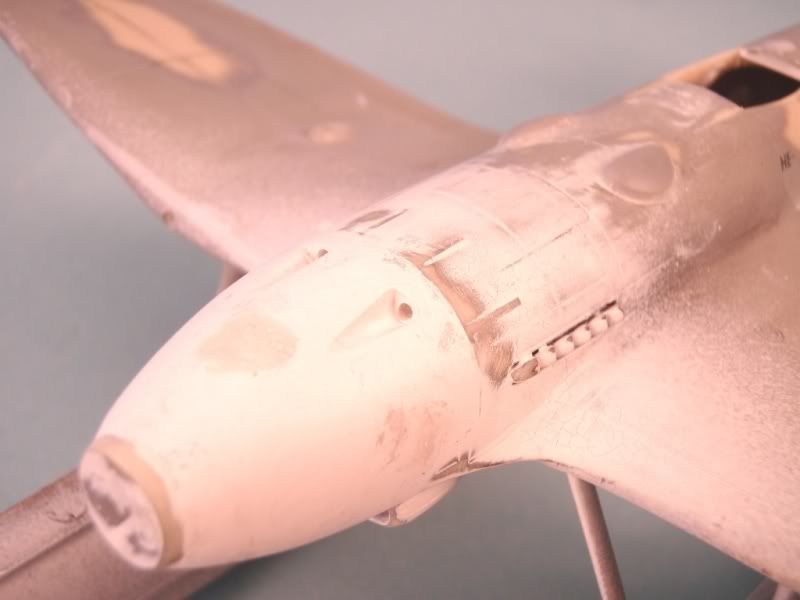

just a quick update...
nose guns have holes for the barells added...look like 20mm cannon to me...and the milliput nose is smoothed off...
cockpit area has been prepped for insertions...oooer!...

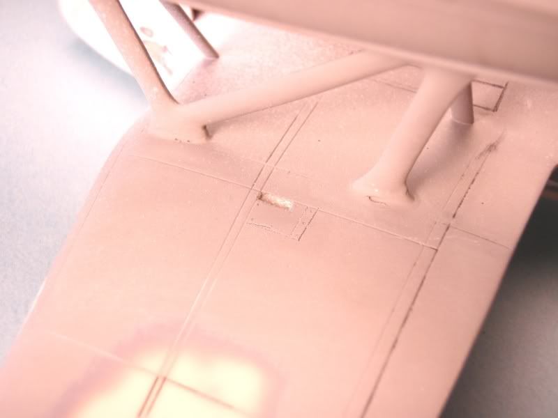

and the wing has had a cartridge case ejection chute and panel put into the underside...

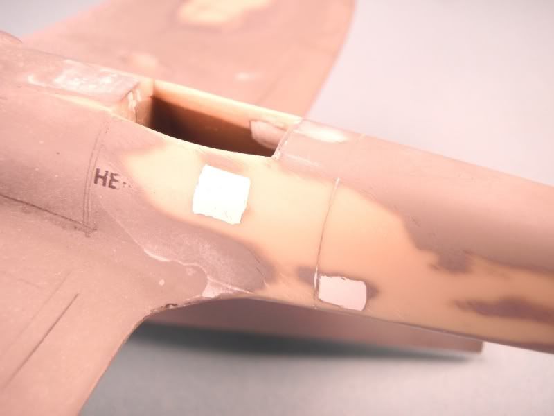

I've actually got the cockpit stuff fitted, including the canopy but no piccies yet...that'll be in the next update I think...probably tomorrow now...gotta go to work this afternoon, I mean, don't they know that I have important kit alterations to do?...How rude!... :angry:
