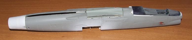

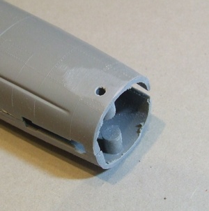

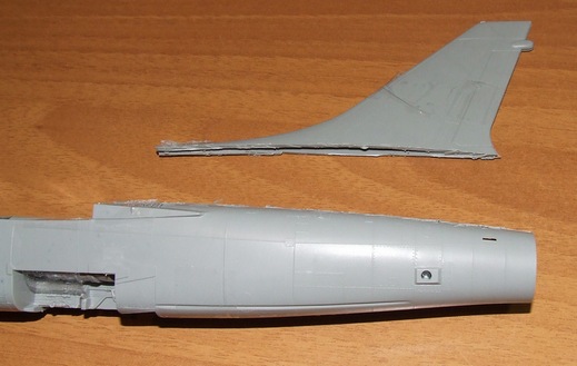

Cut away the original tail of the Crusader.
A pair of dry tests to verify how to couple together the F-18's upper part with the F-8's fuselage:
Now I will reduce the size the twin engine's section of the F-18 as the Super Crusader will have ONLY ONE engine.

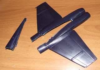

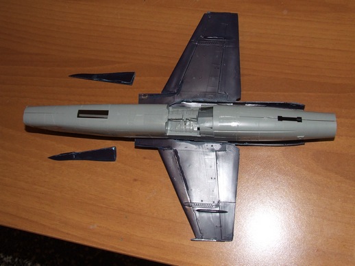

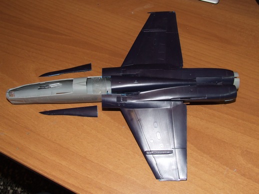

Today morning modified the F-18's upper wing group deleting all the unwanted items:

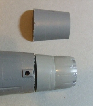

Sawn a portion of the original Crusader's tailcone to match the lenght of a Hasegawa Nozzle:
Sanded (out) and cutted (inside) the locations for the horizontal tailplanes in the tail:
And, the final arrangement for the wing repositions should look like so:
With a little of luck hope to retain the airbrake in the same position of the F-18

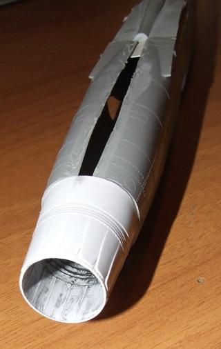

Having spent the last days painting some pieces, from yesterday finally begins to glue the parts in place.
Choosen the tail cone, opted for the type with the F-100's engine as installed in the early F-16s.
The fuselage have been glued a little open thanks to the lack of the tail so the installation of the F-16's tail cone have been easy!

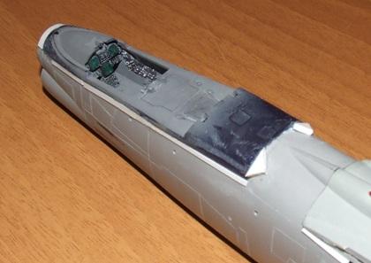

Installed the cockpit: not strange experiments this time, used directly the original interior from the Monogram's F-18

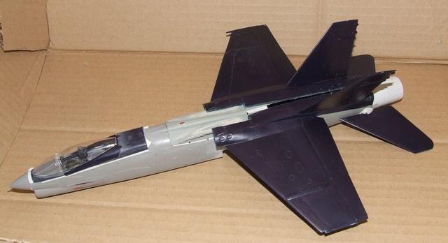

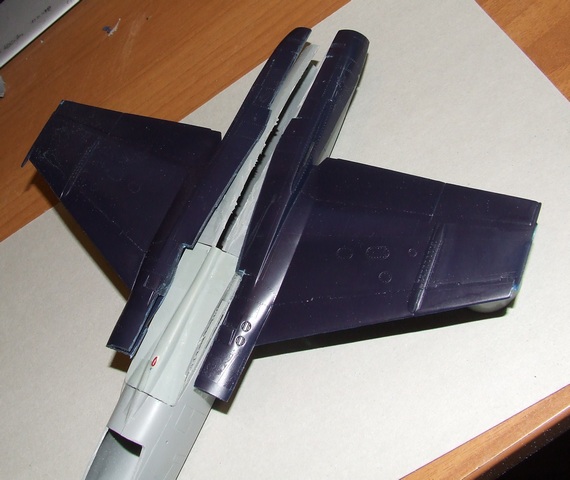

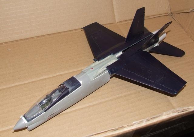

Yesterday night glued in place the wings.
Few moments ago assembled the model with  the blu tac and taken a pair of images to show how will come out approximately the F-818:
After taken the photos a touch of "BAD LUCK"... destroyed the front windshield...
This is going to be a head turner when it is finished! do you have another windscreen handy?  :banghead:

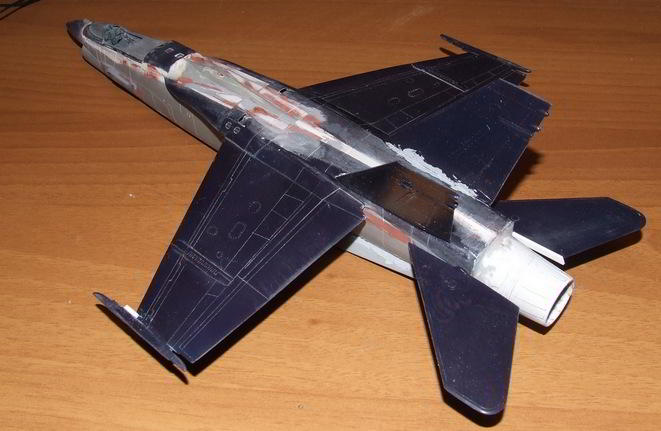

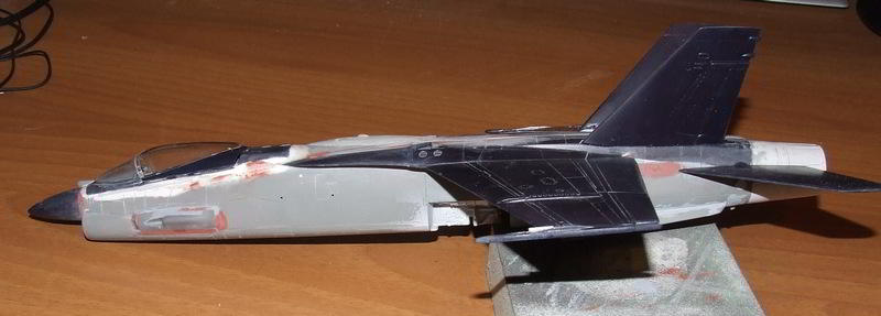

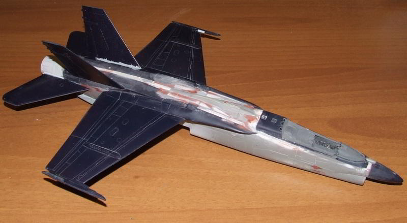

Waiting the arrival of the replacement front windshield in the last days assempbled together the main components of the F-818.
In this moment I'm filling the thousands of gaps with putty.
Here is the current status of the F-818:
