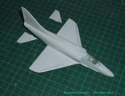

Fairy Power Spray....about £3 from your local supermarket
QuoteFairy Power Spray....about £3 from your local supermarket
Got some the other day, wil be trying it out on a really buggered up Harrier FA2.

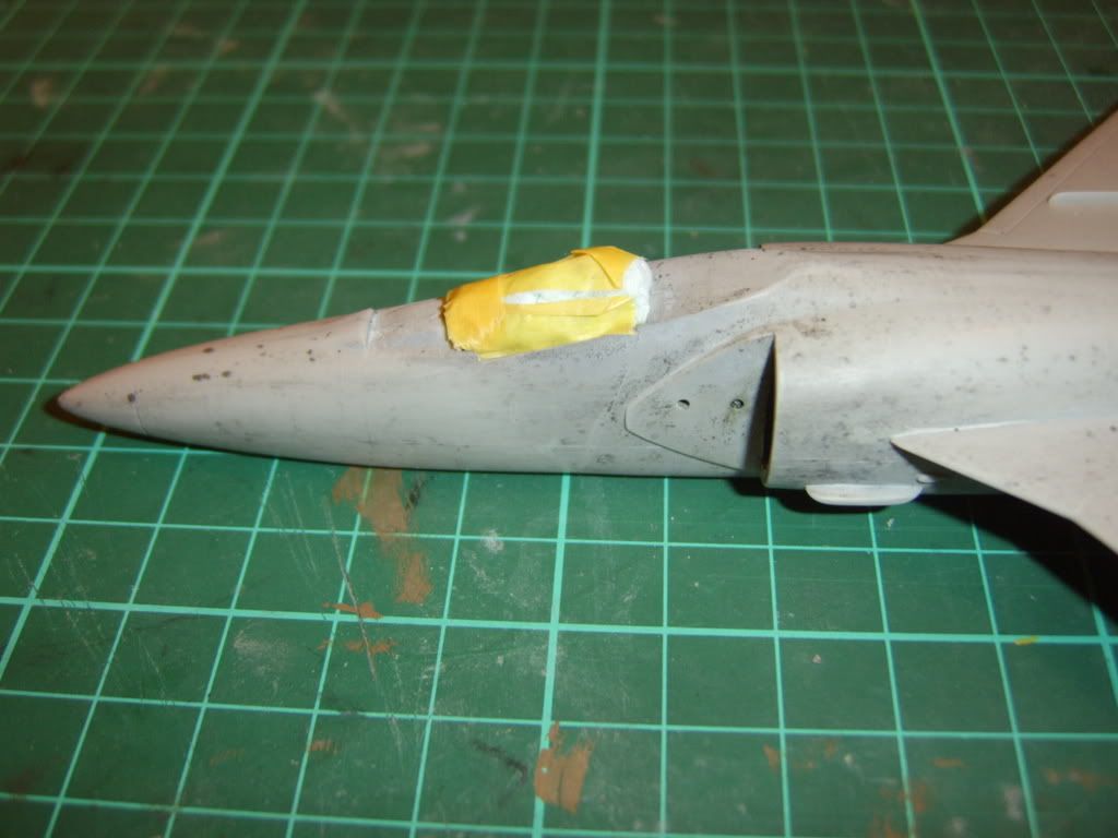

Tried this the other day on a F11F Tiger, I had a small amount of Tamiya acrylic on it.  Got a shock when the paint seperated into gobs & stuck in raised lumps: :o
Not sure why it happened, possibly because the paint had only been on a few days.  At first it resisted attempts to remove the blobs, more Power Spray didn't work, neither did a tooth brush.  I tried one of those green kitchen scourers, it didn't remove the blobs entirely but it did reduce them enough to allow a primer coat to be sprayed.  If this happens when you use it, it is curable without sanding the whole lot down & losing surface detail. :blink:

Mossie old mate,cant even think why that happened. Ive just done a Skyhawk that I messed up the tail codes on. Fresh paint and varnish, like yours and it came back to bare plastic,with no problem.

Quote from: Dork the kit slayer on February 03, 2008, 07:46:53 AM
Thanks Dork.  I'm at a complete loss to why it happened. :unsure:  The only other things I can think of are dodgy paint or dodgy Power Spray.  I'll try it on a wing I use for testing paints & stuff, see if it's okay with that.  I take it there's no technique involved, just spray it on, scrub ligthly & rinse it off?

I use either a plastic bag or tupperware container,give it an all over squirt and leave it for about an hour or longer.
Im told you can spray and scrub,but Im stuck in my ways (from the mr muscle days).
PS use gloves this stuff dries out your hands to "cracking"point
