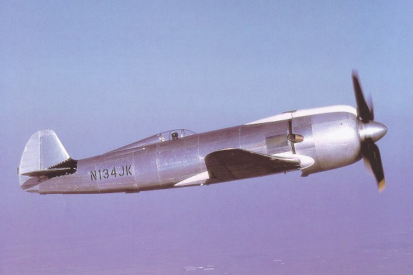

^^ "Mr. Awesome," a Yak-11(?) heavily modified to take a R-3350 Turbo Compound off a DC-7, with a very noticable fuselage stretch. Later it got a T-33 tail. :blink:
