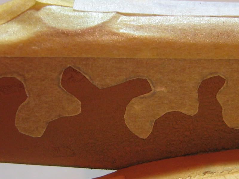

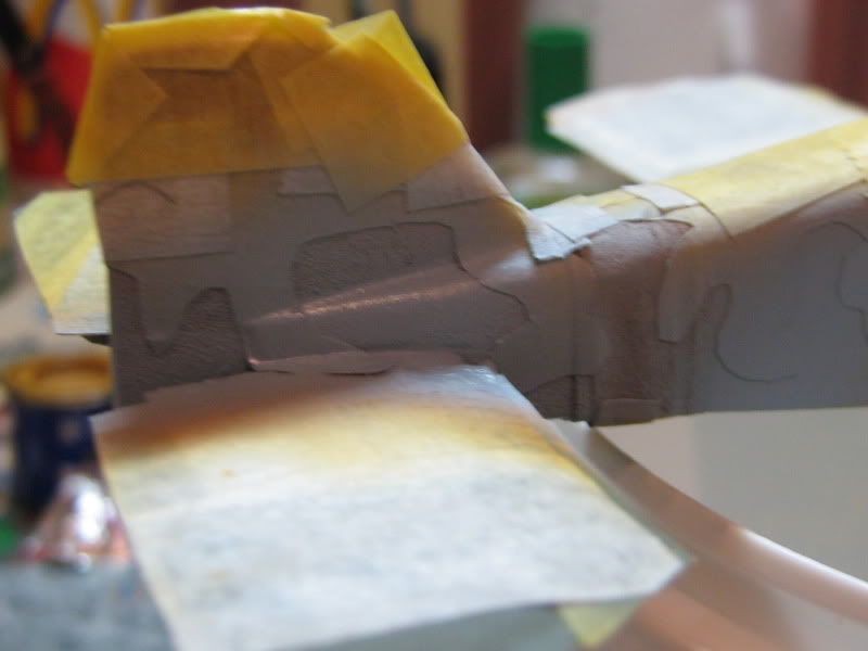

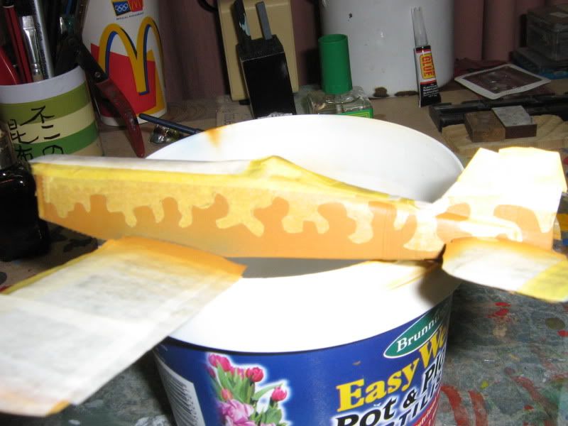

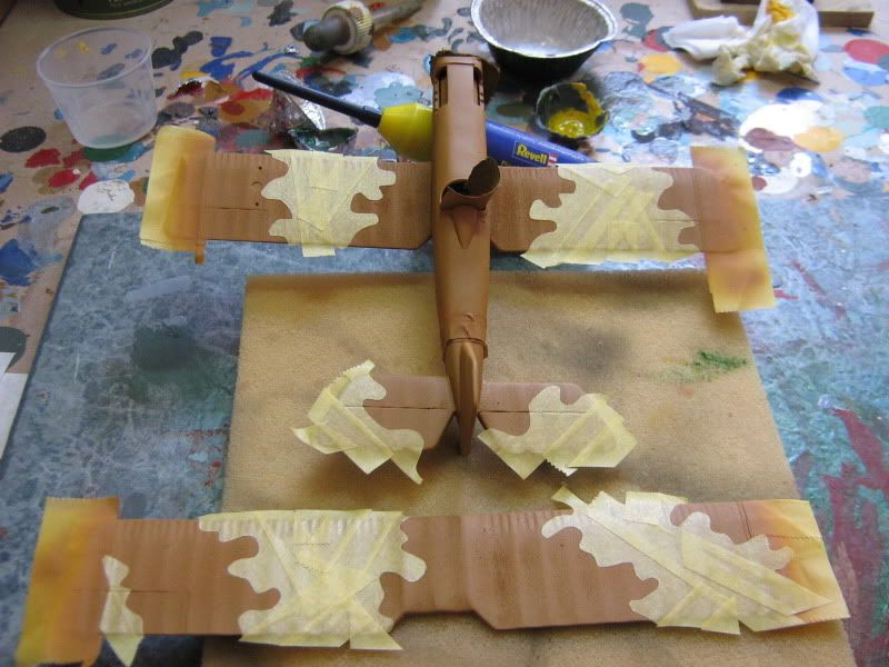

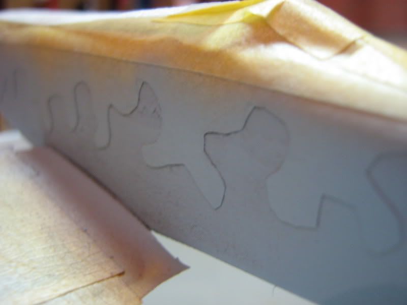

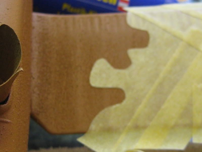

Hi Ranger,
What I did was place some tape on the wing and then use a pencil to write the squiggles.
Then remove the tape, stick it onto a piece of plastic sheet and use the point of my sharp knife to cut out the pieces.
Then restick them onto the surface of the wing.
Then spray.
Allan

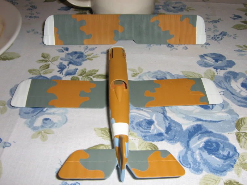

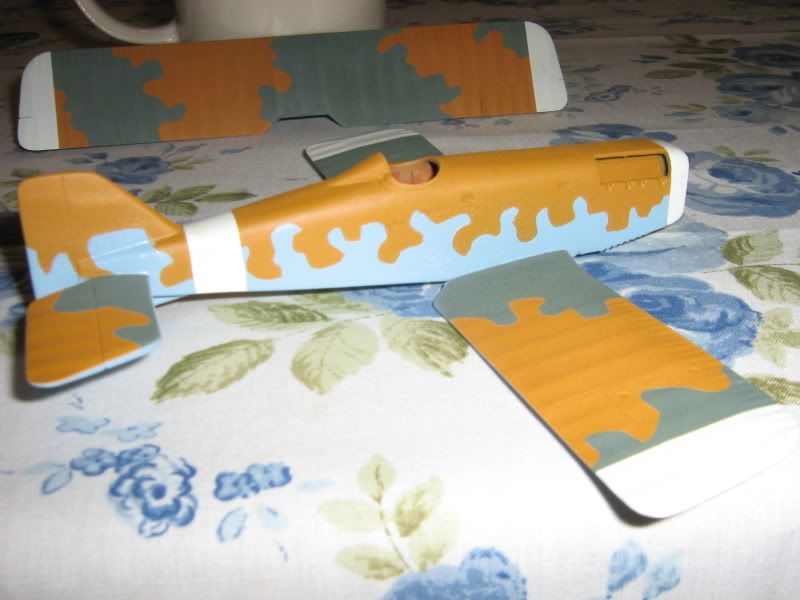

Thank you Brian and all for your kind comments. Here's the plane coming along nicely--have to decide on the decals now!
And have bought some Tamiya clear yellow for the struts--looking forward to using it.
Allan in Canberra
The more I see of your SE-5, the more I like it, Allan! I think all the time you took cutting the masking for your camo pattern will really pay off and make this one of the most eye-popping SE-5s around!
:wub: :wub:
#34
I REALLY think that jigsaw look is effective and bold. It works well.
In fact, and I mean this in an imitation-is-the-sincerest-form-of-flattery way, I think I will use the technique (though in soft edges) along the fuselage sides for my He-113M as the Germans try to make their Italian-camo-ed plane conform roughly to the German-camo look then in use in the North African desert.

Thanks, Brian and Ranger.
Ranger--best of luck using my tape technique. Making the tape stand a little proud of the surface might be a little tricky. You could gently lift the edge using a pointed toothpick or perhaps lay a length of thread under the tape, but getting the thread to match the wiggles might be really hard.
Allan in Canberra

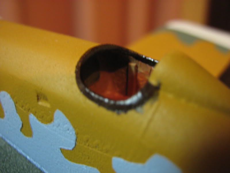

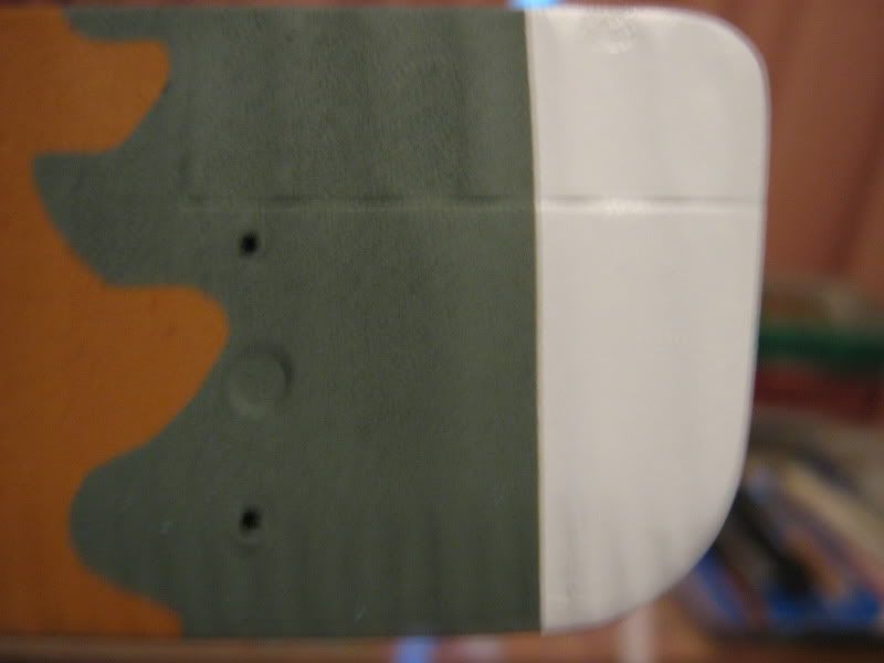

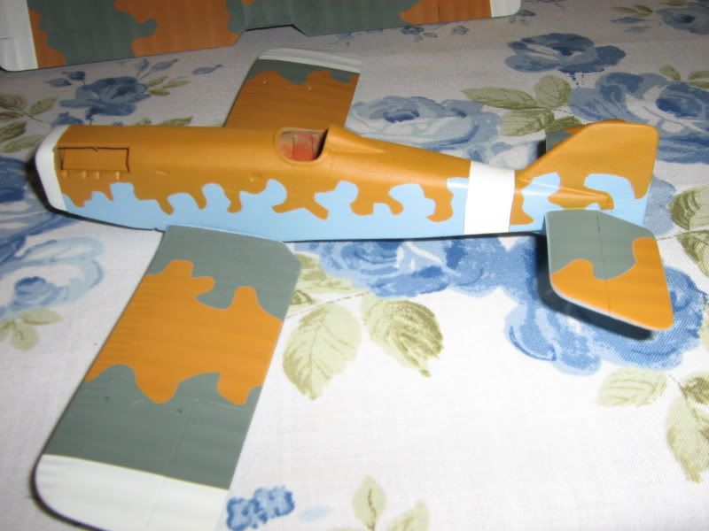

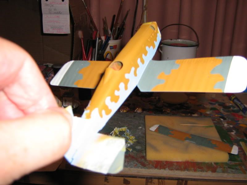

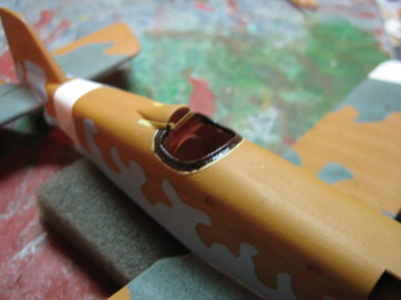

More photos. Inevitable paint bleed under the tape near the cockpit. Will touch it up tomorrow once it's dry.
Allan in Canberra

Looking good, Allan!
You may have a better way to clean up the bleed-through, but here's a quick tip that seems to work well on my airliners: I lightly sand over the bleed through with fine grit sand paper (2000 is what I use). Then I go back and touch up anything that needs it by hand. The nice thing is this saves me a little on the touch up painting. Your mileage may vary.

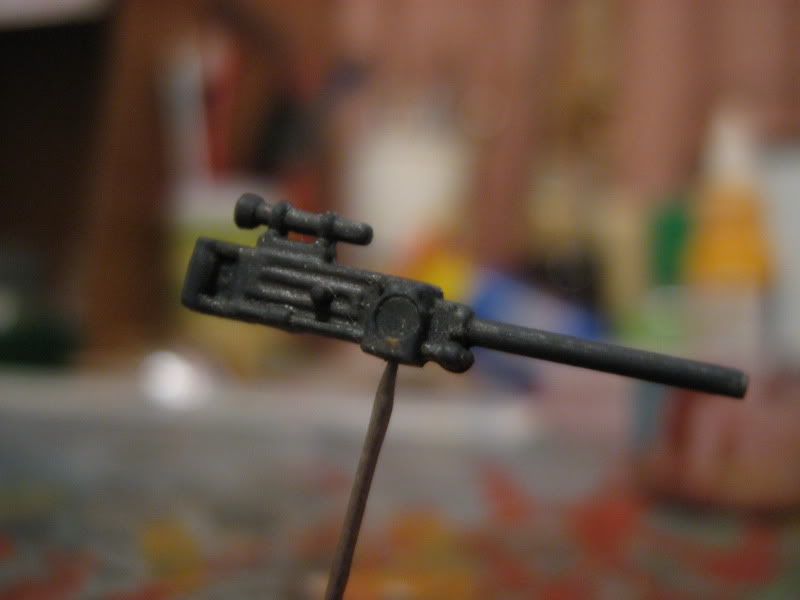

Hi fellows,
Here's one of the two machine guns I'll attach just in front of the cockpit, uisng perhaps white glue or even a dab of varnish.
I'm slowly choosing some decals for this bird, and my bag of leftover decals clocked in at 494 grams!!!!
Allan
