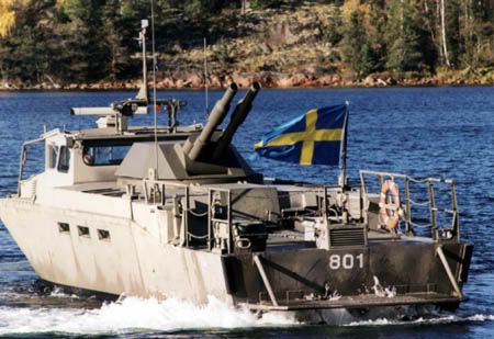

Or you could go small and fast, shoot'n'scoot. For instance, the AMOS rapid-fire automatic mortar turret can be mounted on the excellent Swedish CB90 combat boat:
