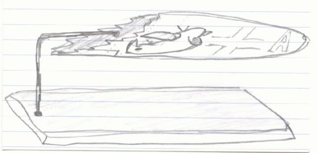

I just had a thought for displaying this "missile". Presuming it's 1/72, you could take an old bomber outer wing (maybe even a 1/48 wing of some sort, mount it with a stiff metal rod protruding from a jagged-edged inner boundary (representing a wing, but not supposing to BE a wing), and the missile mounted underneath. The rod, protruding horizontally out from the wing "root", then bends down at a 90-degree angle into a base. The wing is painted like a Luftwaffe bomber.
I had thought of this display method for a "human-guided missile" whif for a "Divine Wind '46" model I have conceived that would similarly be bomber-carried and otherwise look kind of silly just sitting on a shelf or "ground". Pardon the crude sketch--just a "concept" drawing.

I was thinking of mounting the luft 46 missile like you suggested but I have another idea. This one should be finished this month. Pity we don't have a finers crossed smiley. ;D

What a flippin' cool concept!
