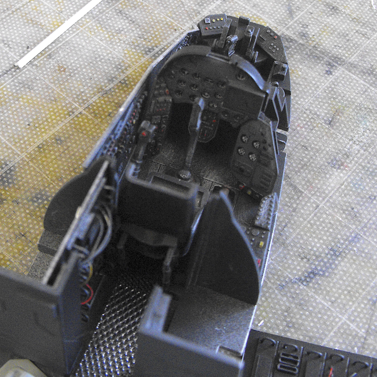

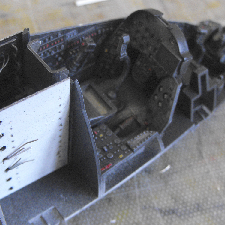

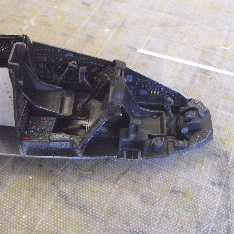

Painting the Cockpit
I have heard good things about the Citadel acrylic paints you get at the wargaming shops, so I thought I'd give them a try. They'd want to be good at $6 a throw! I've used Tamiya acrylics before and I must admit I've had some trouble with them adhering. I'm prepared to admit that the problem may be my surface preparation, so I will bear that in mind.
I gave all the cockpit subassemblies and parts a spray with Windex (another new thing I'm trialling) and left them to sit for a few hours. I then rinsed off the Windex under cold water and left them to dry.
Modelling Tip: I use a cheap strainer from Kmart to hold the small parts while I spray them with Windex and then rinse them off. This makes it pretty unlikely I'll lose one, and I don't need to handle them whaile I wash them.
Modelling Tip: Use Windex to wash parts. I've been told it is a spray on, leave, rinse off affair.
With the parts now washed and dried, I set about airbrushing them. I wanted the cockpit to be NVG capable, so I sprayed the entire interior with Citadel Death Black or something. Note that I deliberately didn't use an undercoat to test adhesion. I also sprayed the cabin in a medium grey, along with two of the instrument panels.
Having done this, I hand-brushed some details and gave the black surfaces a dry-brush with the same medium grey. I scuffed up the floor and corners with a silver pencil, and highlighted edges and buttons by dancing a white pencil all over the raised detail, much like dry-brushing.
My impression of the Citadel paints so far is quite good. They are all matt, and do give a really nice finish. They are more brushable than Tamiya acrylics, but no where near as friendly as enamels. They appear to airbrush quite well, though I did have some trouble with clogging and uneven spray. I'd be inclined to put that down to me being unused to spraying much at all, let alone acrylics!
Adhesion was a mixed bag. Some spots I couldn't budge the paint with a thumbnail, other spots it disappeared with a minimum of handling. I would be inclined to put this down to my surface prep as the bits that did stick, stuck well.
Cushions and harnesses are still to be added, along with some other details. This cockpit is OOB.
