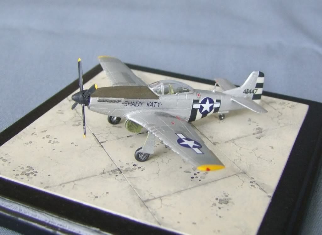

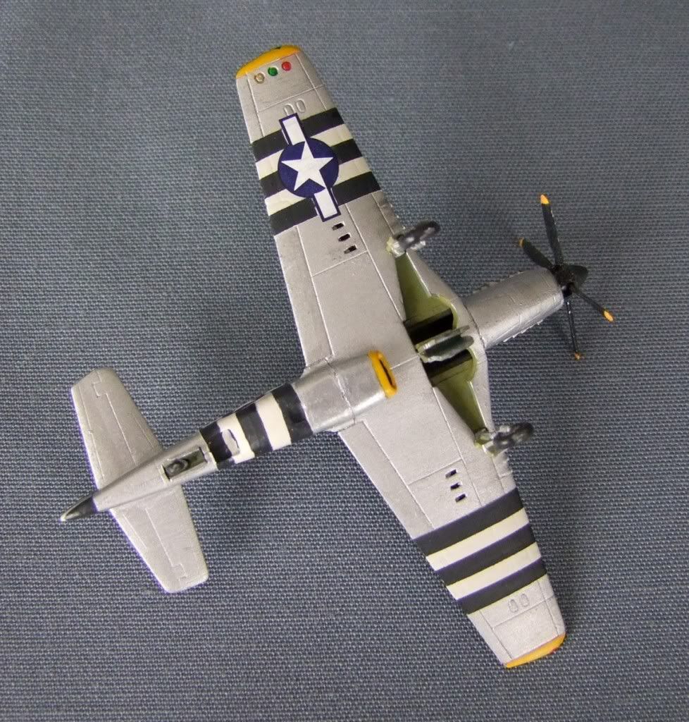

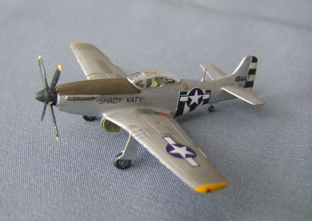

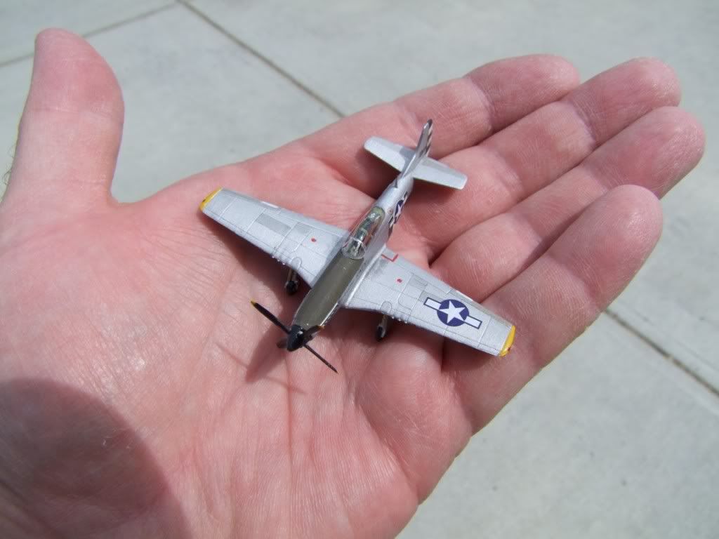

Yep.  Not even my favorite airplane yet I sure do seem to build quite a few of them.  Oh, and some of these photos are courtesy of my daughter, Cambria.  I won't reveal which ones as it's a little embarassing that my nine-year-old takes better photos than I do!
Only thing different is that this one is a tiny 1:144 model:

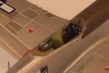

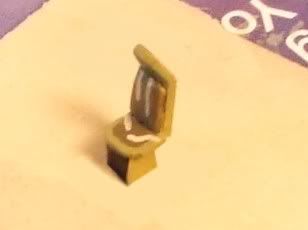

Here is the very teeny-tiny seat I scratchbuilt for the cockpit I carved out of the kit:

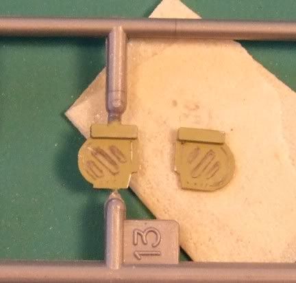

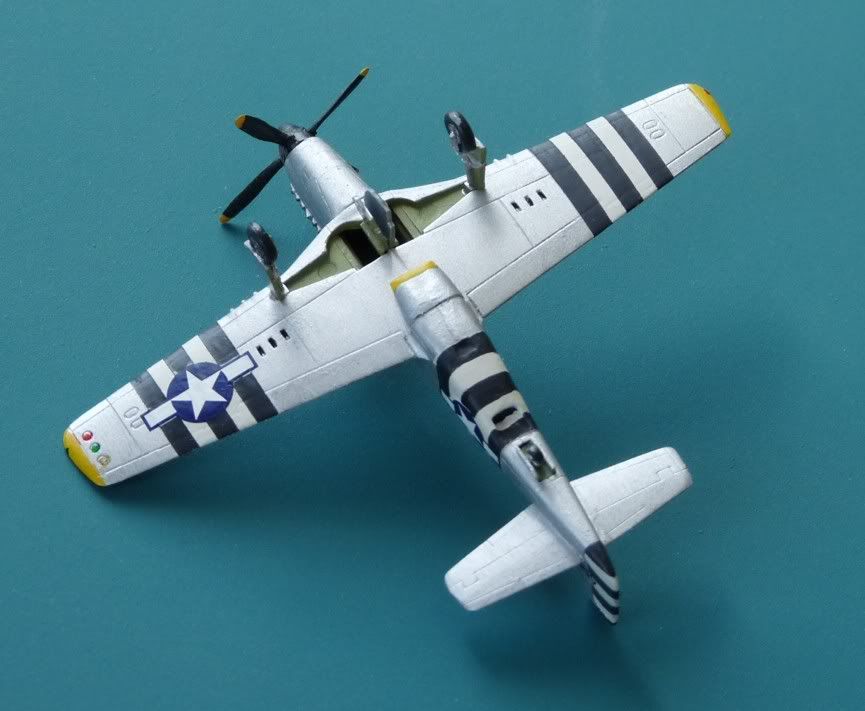

I embellished what little bits I could, like the details I drew onto the inner wheel well doors:

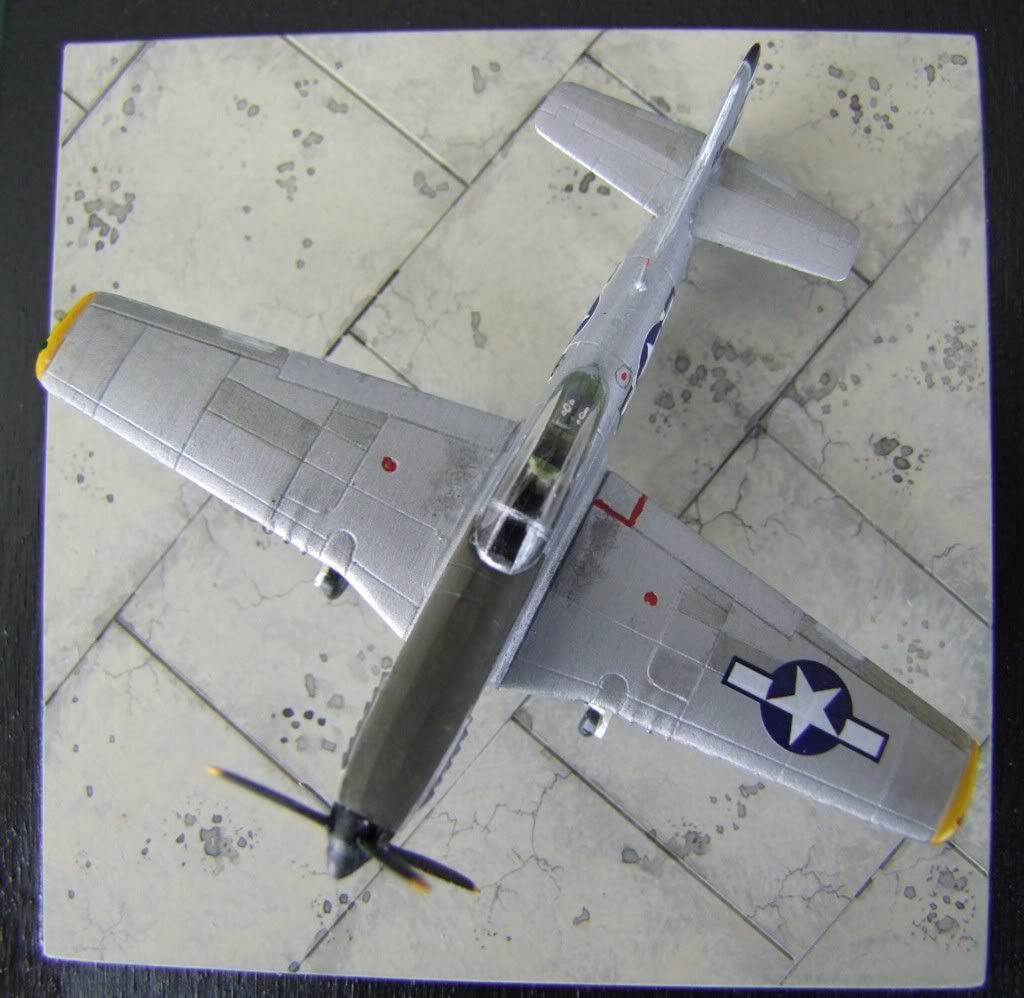

The kit comes without a cockpit so I hollowed out that area and plunked in the scratchbuilt seat and radio boxes.  I also painted some rudimentary dials on the IP.

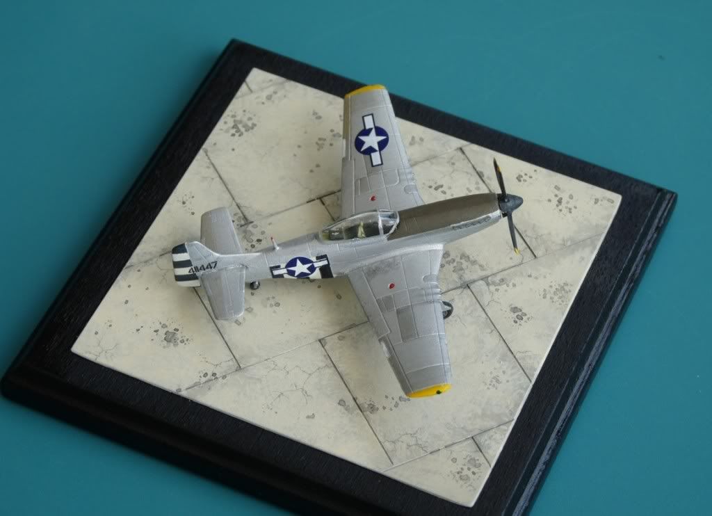

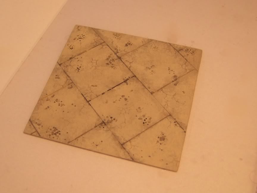

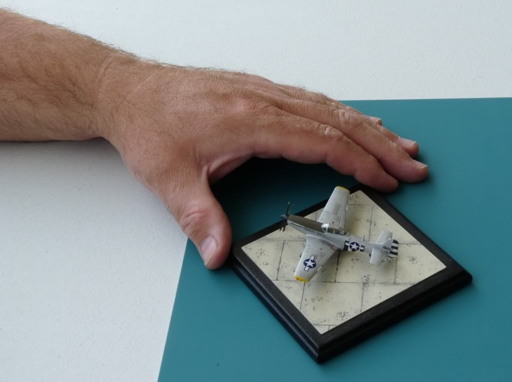

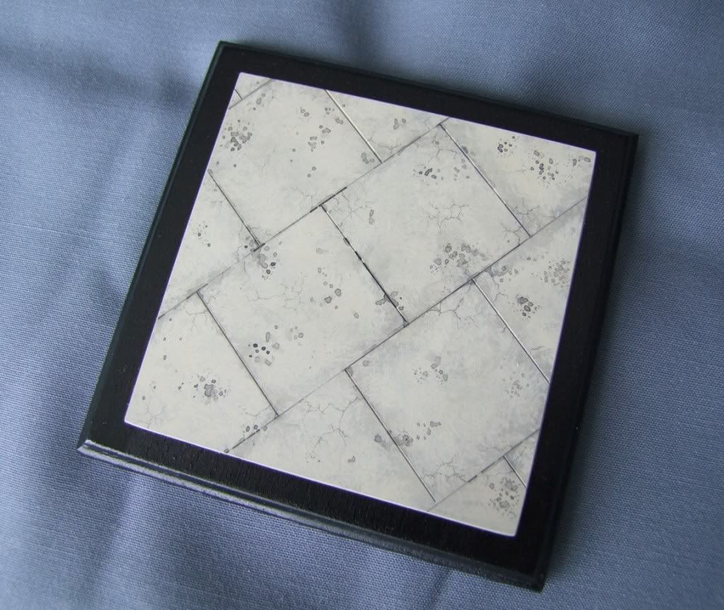

And, in memory of the Master Of Dioramas (HOG), I did my best to reproduce my usual concrete tarmac and router-edged base in 1:144 scale:

Don't be fooled by the pics...it's actually 72nd scale. He would have gotten away with it if he hadn't posted a pic of his giant, Wolverine sized meat-hooks in there !
Very nice, Baz ! I was perusing the pics and wondering why the gear doors etc. were so thick, thought it was some cheap Chinese knock off of maybe the Hawk/Testors kit.

yeah i was looking at teh pics and going thats no the worlds best effort for 1/48, then when I got to the LG bays though it was a decent job of a crap model for 1/72 then you say it's 1/144.

I thought it was a 1/48 kit, too;  "Barry almost always builds in 1/48".
Just amazing. I'd take up knitting, but my wife is the knitter, and I don't think she would want to part with any of her yarn or knitting needles.
Is that the Platz kit?

The giant hand again, trying to make us think this is 1/144 scale huh?
Yet another amazing modelling feat, Mr Howling Mouse! I really thought the Mustang was 1/48 until I got to the last couple of shots. Absolutely incredible work, especially on the invasion stripes!

The model looks great, but I must know how you did that base!

It's the old Academy/Minicraft kit.  I think it's a repop of the old LS kit.

The base is just a simple sheet of styrene that has been scribed with some lines then painted to look like stained/cracked concrete.
The key is in the painting: I start with Krylon Sandable Grey Primer (spraycan) to give it a deep grey with "tooth" for the final painting stages.  Then, I stipple paint the surface using a standard Testors 1/4" flat nylon brush and various shades of grey-tan mixes (Polly Scale's "Aged Concrete" is a nice base).  I'm careful to stipple less paint near the scribed tarmac lines, which leaves some of the "pre-shade" effect.  Then I go over the lines with a very sharp pencil to make the various cracks in the concrete.  Just study real cracks in any concrete surface for tips.  Final step is to use some thinned deep-gray paint for the multitude of stains and drips.  Vary the size and shape of the stains and let them evaporate naturally to leave a realistic left-over stain.  Avoid using straight black for this as it won't look realistic in this scale.  A deep grey is better.
The painted tarmac-sheet is then glued (just used a "UHU glue stick") to a routered wooden base (but you can buy identical, ready-made bases at Michael's Craft Stores or Wal Mart, etc.).

Thanks JHM - I will have to give that a try. :)
