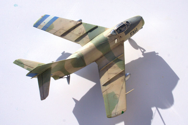

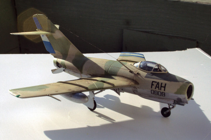

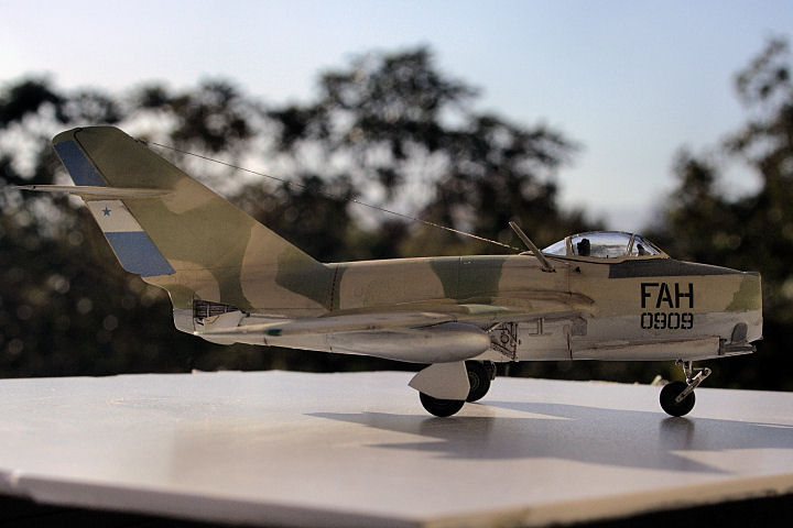

I finally finished this kit! It's not a bad model; it went together well and it's nicely detailed where it counts. There are some minor - but easily fixed accuracy issues. My problem was a case of the Mehs; it was very, very difficult to stay motivated and finish this model. I just couldn't get into any of the finishes. I tried an Italian squiggle camo; I did the squiggles with a brown pencil, then later with a brush,  but I wasn't happy with the results. Jeff's link to MiG - A Canadian Success Story! had a profile that I liked - Black Op's Honduran MiG:
I used that as an inspiration for my Honduran MiG-15:
I should have taken a picture from the port side, to match Black Op's profile...

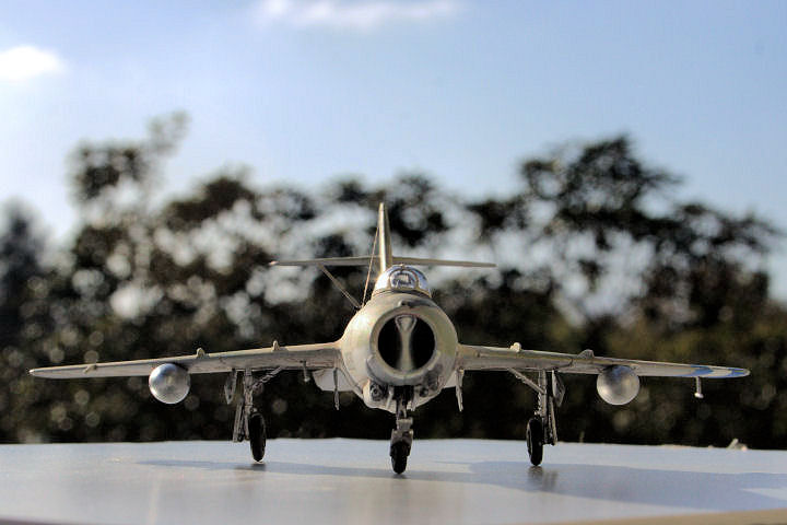

The changes to the kit involved modifying the nose gear to more accurately portray a MiG-15 loaded nose gear. I found an Eduard PE set for a 1/48 MiG-15, so i copied the artwork, scaled it down to 1/72 and printed off some of the instrument panels and the seat belts on paper. That came out OK, although you can barely see anything through the canopy. The gunsight is a piece of clear sprue from the kit, cut to shape. The antenna wire is a nylon string pulled from one of my wife's old nylon stockings.
I used a canopy mask made just for this kit, and it really helped, especially since the framework around the windscreen wasn't visible on the kit's canopy. Weathering was done with sepia ink and some Tamiya powders.
The decals are home made, and instead of my ALPS, I used my color laser printer and printed the decals on white decal paper for the color decals and clear for the lettering. The bort # is the date I finished most of the kit 2009-09. The port wing national markings wrap around the wing, similar to a Honduran Corsair. The tail flash was a royal pain in the exhaust pipe - I printed 8 copies and I destroyed 7 before I got the decal to sit where I wanted it. It doesn't quite fit the rudder, but that's a problem for the Hondurans, not me. I'm done with this puppy!
Frank
