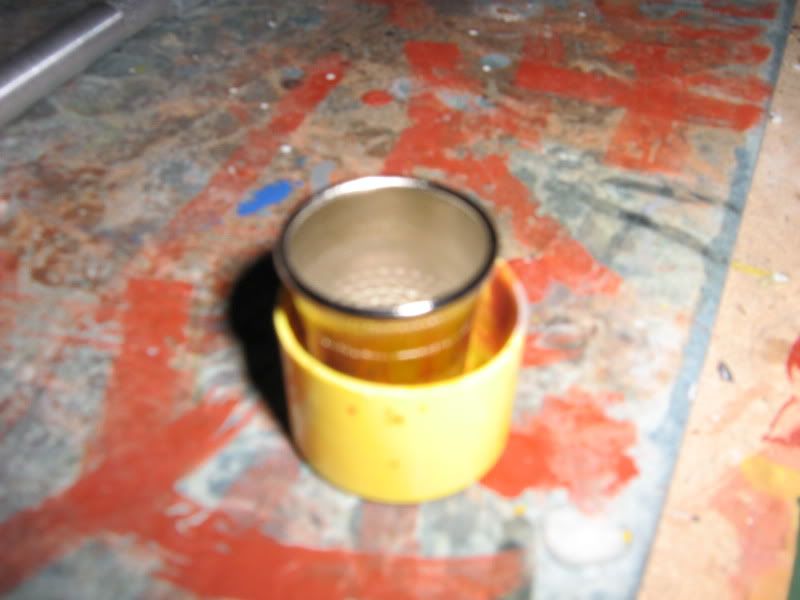

H all,
Like most of you, I've been putting thinner in the bowl of my airbrush first and then adding paint. I've found that even mixing the thinner and paint by backflushing doesn't really mix the paint properly. It still seems sludgey. Smooth airbrushing is hard to do with poorly mixed paint.

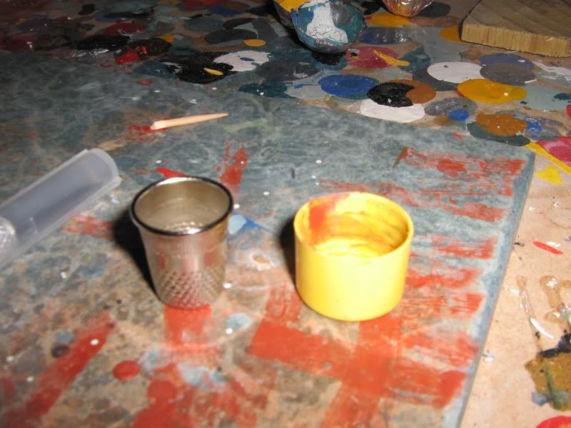

I've come up with this idea. What I needed was some sort of recepticle that I can use over and over again to thin and mix the paint and thinner and then pour the resulting smooth, liquidy mixture into the bowl of the airbrush. That way the paint will be smoother and mottling easier to accomplish.
I've decided to use a metal thimble for this purpose. Here're some photos.
Allan in Canberra
It's a method that works very well. I have been using the same technique for a long time now. Now all I need is a decent working airbrush and I can perhaps get air brushing again

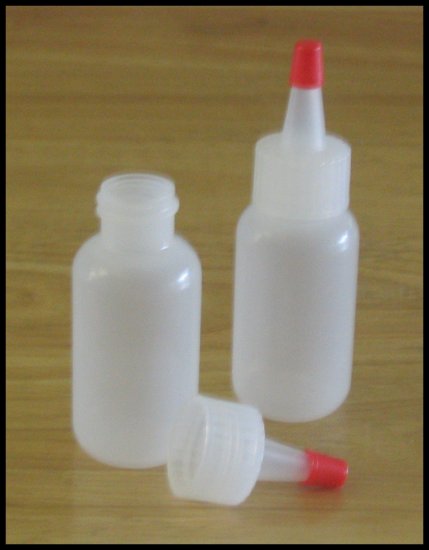

I use 1 oz plastic squeeze bottles with a screw-on cap/nozzle, pretty much just like these:
http://www.ecrater.com/product.php?pid=332790
Easy mixing, just shake, and easy no-spill metering into the airbrush.
Also they keep a mixed batch of paint good for a long spell + they are easy to clean and very solvent resistant.
