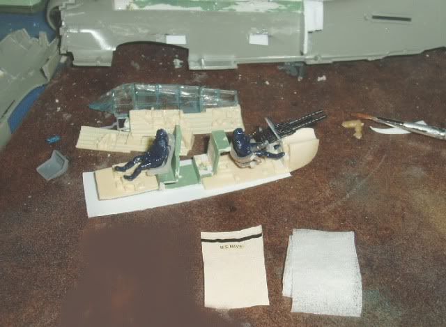

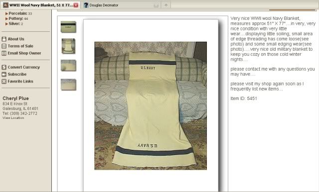

Slow progress. I made a "US Navy" blanket out of a fine paper napkin, put a decal stripe across it, and the letters "US Navy". Now it looks "official" (photo---real Navy blanket). They were an off-white in color, more like a bleached tan.
I painted the blanket a tan-white (source white napkin to the right of it), rolled it up and "blooded" it (remember, dried blood is NOT red, it is a deep red-brown), so it is now ready for the middle seat. As you can see, I'm GETTING THERE, though very slowly. Problems, Problems, Problems. I ended up cutting off the blocky arms of the gunner, as his hands were "fixed" holding what must have been a single .30 cal machine gun, and my TWO .50's are much wider. He now has individual arms/hands the right distance apart to hold the MG's, but the arms are unequal (kinda like a fiddler crab) in size. Hopefully the fact that they are on opposite sides of the machine gun complex will diminish the effect of the inequality.

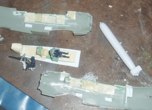

With meticulous measurement and careful installation, I have completed construction of the cockpit interior of my Decimator.
The Dauntless aftermarket resin interior kit(s) was helpful, but the Dauntless was skinnier and shorter (two places instead of the Decimator's three) than the Decimator, and I ended up putting in some additional flooring, a bit of ribbing, and bits from the Devastator to round out the cockpit. I was JUST about to close up the fuselage, when I test-fitted the rear gunner assembly and noticed that it was too wide to be put in post-closure. Now I will have to pry the gunner off the seat, and glue in the seat before closure. The pilot, stick, instrument panel, gunsight, rollover bar, DF loop, rear gunner and MG assembly can be put in post-closure.
I'll paint the interior prior to closure, too, by merely spraying that "Apple" green and adding a bit of color to fiddly bits.
Once the fuselage is closed, and a SMALL (if there is truly ever such a thing) bit of PSR on the fuselage is done, the rest of the model is an "OOB" kit and will go together quickly. I still need to build the other two "Whopper" torpedoes (and paint them), but now the majority of the real work of the kit is done.

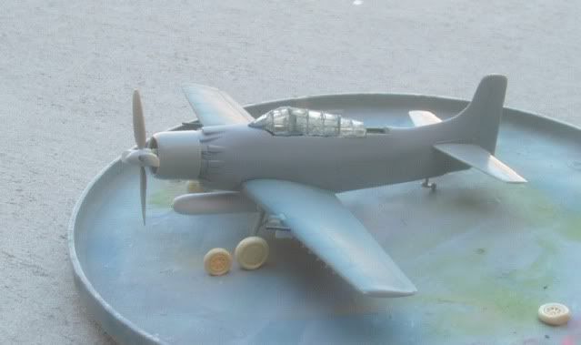

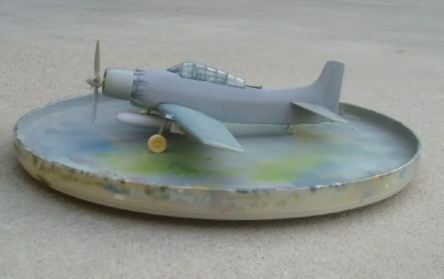

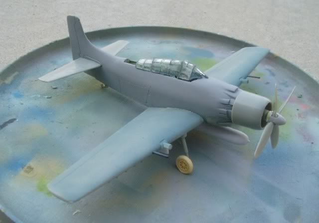

I have made SOME progress on the Decimator. I got the fuselage closed up, some PSR work done on the cowl from the engine to the windscreen, attached the wings, and did some ventral work. The cowl is glued on (I made a special prop-hub assembly that would spin, yet allow post-painting attachment), but the prop/spinner is just temporarily attached for the photo. The "plywood" stabilizer fins of the central torpedo *JUST* touch the ground, so I think I need some bigger wheels (current aftermarket ones shown in photo are the same size as standard Skyraider) to raise the fins (no other possibilities  :angry: ) a little. The windscreen shown is simply an Airfix Devastator one I pried off an old "beater", for show. A nice, clear, aftermarket Squadron Devastator canopy will go on the final version that will show off some of my (rather un-characteristic for me) elaborate interior. Two more torpedoes will go on (one per wing pylon) plus some fiddly bits like cowl flaps, LG doors, antennae, etc., As well as the crew and rear MG. But...
The Decimator beast looks like a Devastator-on-steroids, though, eh??
Now I'm involved in making some custom HO-scale (1/87) limousine-like cars for my brother for Xmas, so the Decimator will take a back seat for project work until the cars get done.
Looks believably a member of the Douglas stable, like a cross between the abortive 1939 VTB project and the Skyraider.  ;D
Jon
Sauragnmon
Quite the beastie, Craig.  She looks pure unadultured mean.  One thought - alter the tail gear maybe?  If you extend the tail leg a little, you might achieve more results at clearing the torpedo fins than by raising the MLG height.

Put a Turboprop on it and it would be a "Skyshark". I like the way it is, in that the "small" motor up front relative to the fuselage is JUST what the Devastator looked like. Remember, "we" are trying to replicate the LOOK of the TBD while upping its capability.
JCF--re: the Douglas "stable"--I may use 1/48 Dauntless wheels to boost height (keeping the wheels "in the Douglas family" rather than the 1/48 Mustang wheels I contemplated) AND keep the "plain" wheel look of the Devastator. The Mustang and Skyraider had demonstrably spoked wheels---not bad, just....dunno. The Dauntless mainwheels on the Decimator did indeed raise the torpedo fins off the ground just the right amount, and their increased diameter vis-a-vis the Skyraider wheels makes the Decimator look more like Devastator proportions, again. Still a W-I-P.
Saur: Raising the tail puts the "angle of attack" too low, IMHO, so raising the mainwheels is the key. Longer LG whilst keeping the wheel diameter "small" is still a possibility, but I like the look of the larger Dauntless wheels.

BdB--the "pointy" nose spinner came from an Aichi Ryusei. I have a thick, double-sided sticky thingy to hold the spinner onto the hub temporarily, so it sticks out farther in the pic than it will when I'm done. The Devastator had a long, but narrow propeller hub sticking out. The Skyraider had nothing, so I added the Ryusei's small hub to have a protrusion and a slightly different look. Funny that the Douglas Skyraider had nothing, and the similar Martin Mauler had a fat spinner that covered almost the entire cowl.
