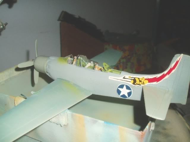

OK, I just *GOT EXCITED* after mocking-up the cockpit/decals, so I *HAD* to take a picture. I still have some things to work out/paint/glue/mask in the canopy area to get the body of the Decimator ready for painting, but.....!!!!
"8-T-1" is coming alive!

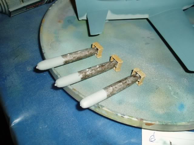

From my research into what the aerial torpedoes looked like when used at Midway, I came up with the scheme that my Decimator torpedoes now carry.
The "warhead" was flat light gray, and the rest of it was natural metal smeared with cosmoline, a brown/black preservative goo that metal weapons were stored in. They tried to wipe the majority of it off, but it still left brown streaks, etc. The propeller was brass/bronze, and the extra stabilizers were plywood. *IF* I can, I might get a small pilot's hand and put "hand prints" of the cosmoline on the warhead. Maybe not. I had also thought of writing the crew's names on the torpedoes, one for each of the three.
So---I have a pic below of my THREE (count 'em!) "whopper" torpedoes that will grace the underwing of my Decimator:
I have also modified the Hornet motif . "Swede" Larsen, the vilified commander of Torpedo 8, had wanted a raised, closed fist to represent the Squadron, but it never caught on. Bert Earnest and others had parodied it with a fist with the middle finger raised. I have carefully painted on such a hand gesture on the angry Hornet that will grace the Decimator's side (un-modified Hornet motif in preceding post).
Also, in "Dawn Like Thunder", recommended read for the history of Torpedo 8, Jay Manning, the gunner who perished on the Midway attack, put "extra" wing guns on by painting patches with a dark "gunport" on the wing leading edges. These, too, will be found on my finished Decimator.

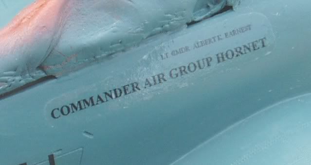

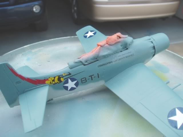

I think I have success! The big time-gap in updates here has been partially due to a trip out to the desert (Palm Springs/La Quinta) and an unbelievable series of trials-and-errors regarding the decals.
The printable decals need JUST the right amount of acrylic coating to fix the printing and maintain some sort of practicality. I went through several sheets of precious and expensive clear decal paper trying to get the right "formula" for success.
The untreated decal paper, without any print or coating, is nice and thin and sticks perfectly to the model (I tried a series of "trials" on a dummy model). If one prints something onto the decal paper with a computer printer, the ink gradually soaks off when the decal paper is put in water. That simply won't do.
I had gotten into trouble with perhaps TOO MANY coats of acrylic in the original post where the decals curled up. Applying acrylic creates unwanted thickness and stiffness, making the decal's outline very obvious, and inducing lots of unwanted silvering when the stiff decal tries to snuggle down over any tiny protuberances or indentations in the model.
I had deliberately sanded down VERY SMOOTH the location where I wanted the "Commander Air Group Hornet" and "TB3D-US Navy" home-made decals, and applied just enough acrylic to fix the ink. The decal was still "stiff" and thick, but it only curled up a little. I was able, with some un-diluted white glue applied first and allowed to set up a little, to get a central strip to adhere to the model. Then, after that dried, I tucked a little glue underneath the curled-up "flaps" and pressed them down. So far it has worked! I have a little bit of silvering to touch up, then will spray some additional coats of clear gloss and flat to blunt the obvious outline of the decal.
I think another trouble with the original setup was that I had put MicroSet on the decal location prior to putting the decal down. This normally works well with standard decals, but not these. I think this made the smooth model surface too "slippery" and allowed the decal to refuse to adhere. I deliberately did NOT put MicroSet under the present set of decals. I truly believe that was the "narrow margin" that got the decal center to stick and allowed me to gradually get the rest of the decal to stick.
WHEW!!
