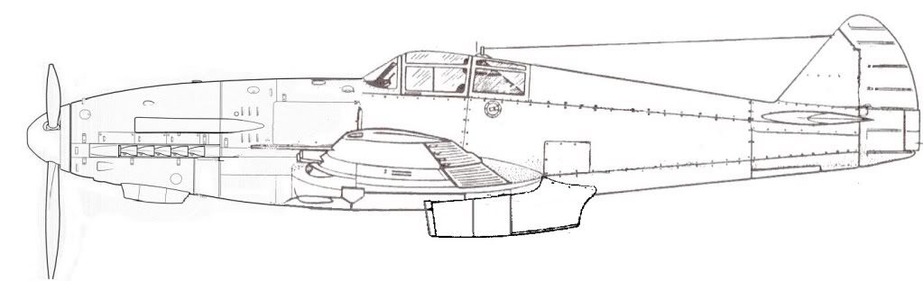

Great schemes to the DB605 version, I want the kit, in 1/48 to make it...jajajaja :thumbsup: :cheers:
Don't forget to massively reinforce the landing gear and add a few hundredweight of ballast to the tail.  ;)
R-1830: 567 kg (1,250 lb)
DB 605: 756 kg (1,667 lb)
Also don't forget to add the weight of the cooling system.
BTW where are the radiators on your profiles.  ;D
Jeffry Fontaine
Quote from: apophenia on October 18, 2010, 07:12:48 PM
Quote from: joncarrfarrelly on October 18, 2010, 03:25:30 PM... BTW where are the radiators on your profiles.  ;D
In the inner leading edge of the wings, same as the oil coolers for the radial J-22. With that weight difference in mind, maybe the rear fuselage would've been wiser  :-\
Maybe with a set up similar to the Mustang or Thunderbolt?
Always with the radiators ;D:
