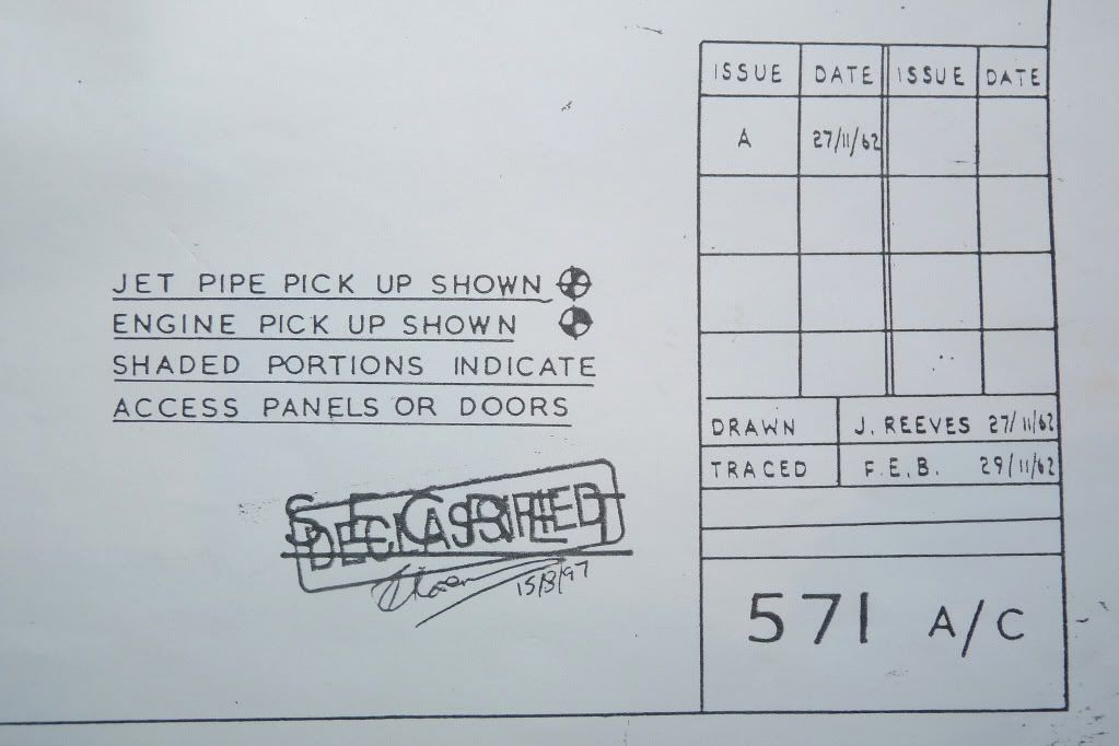

Hi gang, just a bit of progress made over the last few days.
iI finally got the drawings through and set about measuring everything up against the kit parts....one thing became ovbvious straight away, namely that the Airfix intakes appear to be undersize which I think accounts for the starnge taper we see on the forward fuselage!
The drawings sent were made by a draughtsman friend who produced them for Dynavector for their wonderful vac kit , using some drawings he had from acquired from Warton way back.
Anyway on with the pics,
The upshot of all this seems to be that Airfix got it right on most of the kit but for some reason made the intakes too small...the result was a shortfall on the forward fuselage sides that would have left a nasty gap between the intake shroud and the fuselage side............the option??...to bulge the walls out from the intakes towards the nose, resulting in the totally inaccurate plan view we have on the kit., same goes for the large 'hump' on the wing top, it should be a lot smoother and less defined, not a problem , just a new blade, wet and dry and rescriber!!...just my thoughts after comparing everything, but why it happened after the 1/72nd scale kit was so right is anyone's guess!!
The piccies,
Firstly a rather large parcel arrived yesterday courtesy of RM and the dream factory at English Electric/British Aircraft Corporation, Warton..........
The details on each sheet....
This proves beyond all doubt that the fuselage should indeed be flat sided in the area just before the intakes and not bulged out as in the kit...
Chris's work for Dynavector which he is in the process of finishing off ready for retail to those interested........
This one shows the undersized kit part against the drawing of the intake section, this should have been moved up a bit to match the position of the shock cone as in the next photograph....my mistake.. Unfortunately I went and bought 2 sets of resin replacement intakes , then realised that they would need a lot of work to enlarge .............oh well hacksaw at the ready!!!  :banghead:
And this one shows the shortfall at the bottom of the intake and the undersize shock cone..............
Here you see that generally Airfix got it right as the kits profile fits pretty well...
This shows the intake in plan view to be too wide, some distortion will occur obviously as the kit part stands away from the drawing but you get the idea.... ..excuse the crude cut of the plastic , trial and error before all being tidied up!
