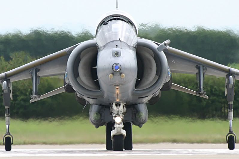

You can only see a small amount of the fan face from directly head on, which is the way the airflow is going.  Most of the air is flowing by the curved surfaces in the ducting & is following a flat S as it goes through the engine.
Quote from: rickshaw on November 24, 2009, 02:17:24 AM
Mmm, while I agree with your characterisation of what air likes to do, I don't with your characterisation of the inlet path of the Harrier.  If you can see the fan face there doesn't appear IMHO to be much of an "S" bend there.
OK, try standing directly in front of a Harrier and see how much of the fan is visible. [see abpve, handily posted while I was writing the previous, thanks Mossie]
Most photos that show the fan are taken from alongside the cockpit and are looking down the inlet duct at an angle. The fan is very close to the front end of the duct, so much so that it almost, but not quite, touches the rear of the cockpit tub.
I'm sorry, that picture merely confirms that you can see the fan face.  No way that can be described as an "S" path.   An "S" path I believe indicates that the airflow has to actually turn corners.  In that photo it is obvious that it does not.  If it did, you wouldn't be able to see the fan face.
But how much of the fan can you see?  Very little.  The only airflow that might go straight into the fan is a little bit of boundary flow along the fuselage side & IIRC, the intake narrows in close to the fan & creates a shallow stylised S itself.  Most flows with the ducting as I mentioned above.
Quote from: rickshaw on November 24, 2009, 05:20:15 AM
I'd call it an S path. Sure, there are no 90 degree bends, but the top view of the air path is clearly an S shape. Similar shapes in car racing circuits are definitely called an S.
I suspect we will have to agree to disagree.  I would call it at best a very shallow "Y", rather than an "S".
