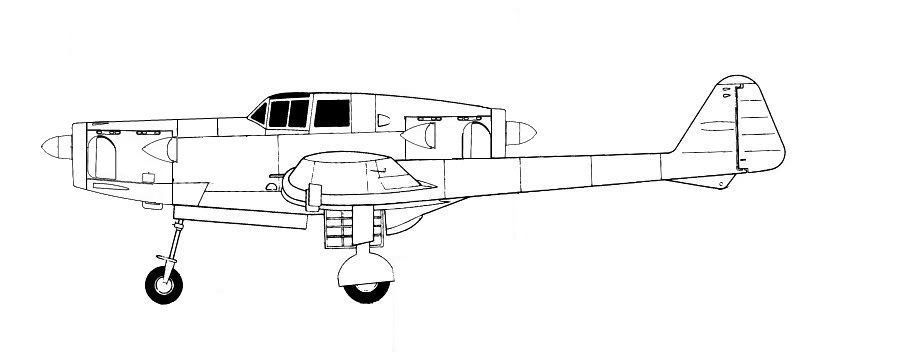

Here are blanks of D-XXIII projected versions with different engines. This picture is from Czech Aero Revue magazine, Vol. 65 (1997). Those who want can do some profiles of them...
Also I attach a cutaway from the same magazine.
What about the rear Sagitta cooling - it was really a problem. Even during slow climb, the rear engine valves heated up to 320⁰C, while maximum allowable temperature was 270⁰C. The high-speed climb was impossible at all. This problem wasn't solved until the end of the whole program...

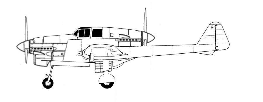

I did some profiles of the other engines myself, I didn't post them before as I haven't spent as much time on them as the Kestrel, but here they are.  Although I've come to similar conclusions with the Kestrel & 210G (intakes being different), we differ on the 12X.  I admit I've got mine a little high & he's gone for a more appropriate version of it.  Like I say, I hadn't spent much time on them.
Redstar, is there any explanation in the book as to the ventral hump that's been included in those profiles?
Jumo 210G
Hispano 12X (actually a brs, rather than the crs it should be)
Radiator for the rear engine (in the liquid cooled variants)?
